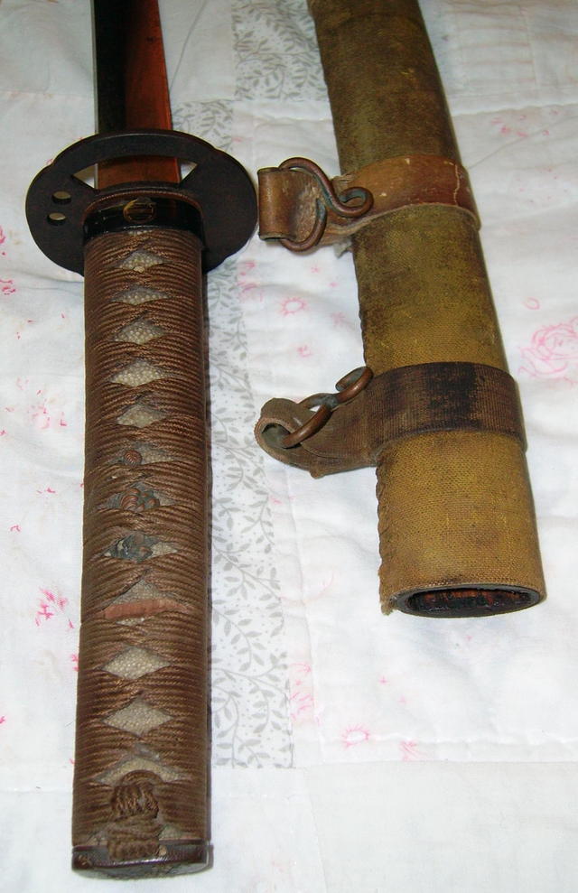

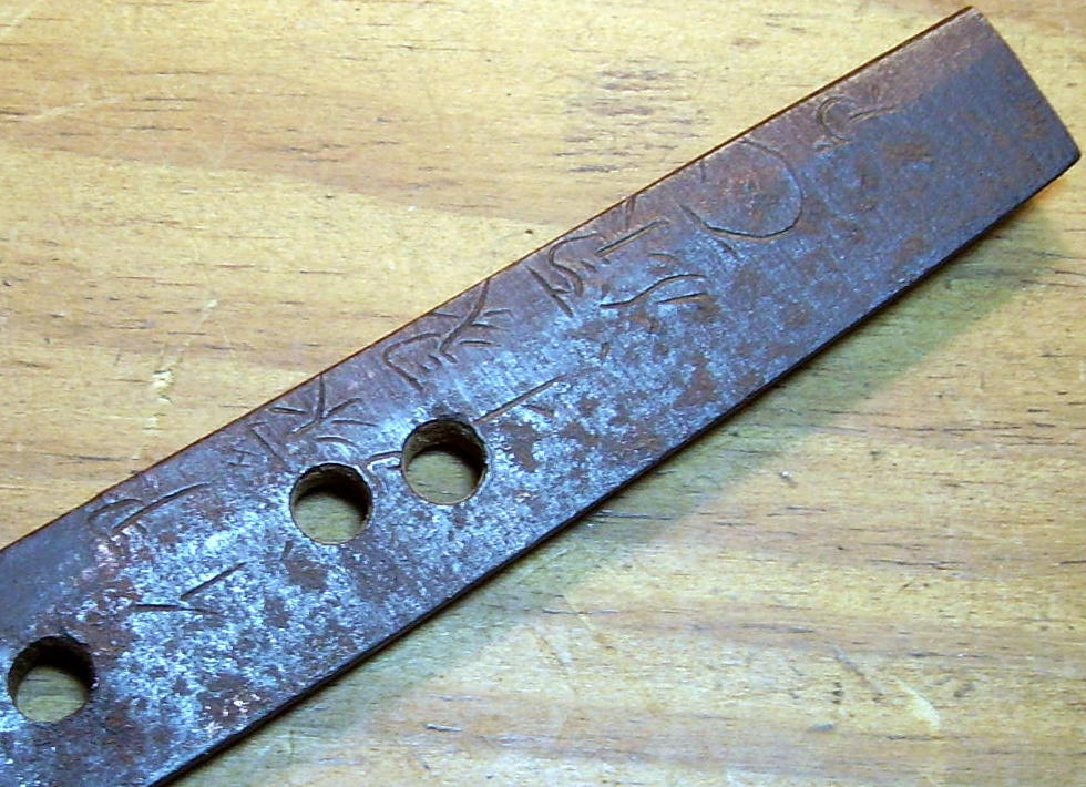

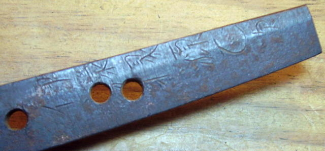

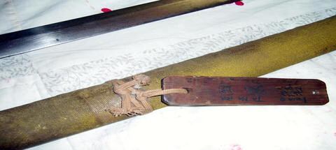

anne_brewer Posted May 23, 2008 Report Posted May 23, 2008 Hi all! I am new to the site and Stephen asked if I would post some images of my grandfather's sword. In response, I have uploaded a number of images to a site on my .mac account. Posting the images there allows easier access for you all and more images than would be manageable here. Here is the link: http://web.mac.com/anne_brewer/Grandfat ... lcome.html As you will find, I don't know a lot about the various components. As a place to start, I've done my best to document my meager knowledge. What I know comes from a brief appraisal of the sword blade many years ago. Any other information in the descriptions is largely the result of my research attempts. Amoung the resources used were Connoisseur's Book of Japanese Swords, Richard Stein's Japanese Sword site http://www.geocities.com/alchemyst/nihonto.htm , and numerous others. Your assistance and thoughts will be greatly appreciated. I would love to solve the mystery of the sword! Anne (aka Antelope) Quote
Jacques Posted May 23, 2008 Report Posted May 23, 2008 Hi, Anne, First welcome on the board :D , Concerning the sword, it was forged by Omi no kami Minamoto Hisamichi, one of the best swordsmith of the Mishina school (lived in Yamashiro). This sword was made after the 12.27.1662 (date of his title reception) Quote
sencho Posted May 23, 2008 Report Posted May 23, 2008 Nice sword (so far) Anne, and thank you for researching all of the details... long blade it seems... Can you get us some pictures of the blade itself..? hamon... kissaki (tip)... this may spark a bit of a discussion in the Nihonto section... Cheers! Quote

Stephen Posted May 23, 2008 Report Posted May 23, 2008 Hi Auntie Yep pretty nice sword you have there. Its too bad that someone unwrapped the Ito on the tsuka, if your looking to have it re wrapped correctly id give David McDonald a try, he has done a few for me and his work is top notch for stateside. here's his link. http://www.montanairon.com/tsukamaki.html no need to send the whole sword just the tsuka with nuk's. Tsuba has pine needle motif looks to be iron, tsuba guys can tell you more about it. the same* looks good with the black lacquer the sanded to reveal the nodules, nice Koshirae all around. Sencho is right we'd like to see pix of the blade as you may have seen in other post, full shots of the blade gives us the overall impression of the blade. out of saya, sans habaki, one where we can see the sori and sugata. Your grandfather had a good eye, as you do, nice slide show...now more blade!! Quote
Guido Posted May 23, 2008 Report Posted May 23, 2008 Stephen said: Hi AuntieAre you two related? Stephen said: no need to send the whole sword just the tsukaI'd be very careful with that. Chances are it won't go back over the Nakago after the wrap, which by default should be very tight if done properly. Quote
Stephen Posted May 23, 2008 Report Posted May 23, 2008 Guido NO! why do we have to be??? its from her antilope tag, as far as the wrap goes id ask David first. Quote
Brian Posted May 23, 2008 Report Posted May 23, 2008 Ah..I get it now. Antelope = Ante = Auntie I think Anne is less confusing I too have been told many times that the tsuka when properly wrapped might be too tight to take the nakago after. Best to have the sword with it, although maybe some tsukamakishi might make up a form to replace the nakago. We have a good post on this previously at viewtopic.php?f=1&t=1561 including some good info from Keith. Love the way the NMB search fuunction is becoming an encyclopedia of many Nihonto subjects Brian Quote
Jacques Posted May 23, 2008 Report Posted May 23, 2008 Hi, Ford Hallam said: here you go, an oshigata to compare it to. This one from the Shinto-shu by Shibata [attachment=0]Omi no kami Hisamichi.jpg[/attachment] obviously the one on the left is the one to look at Nice first and second generation Hisamichi jointly made work. Quote
Ford Hallam Posted May 23, 2008 Report Posted May 23, 2008 yes, apparently these "gasshaku" works by father and son are not uncommon. Quote
Jacques Posted May 23, 2008 Report Posted May 23, 2008 Hi, That's true, but Nidai Hisamichi wasn't the son of the shodai only an adopted son. His father was Sandai Rai kinmichi. Quote
Ford Hallam Posted May 23, 2008 Report Posted May 23, 2008 thanks for that, Jacques, I didn't know that. Quote

Stephen Posted May 24, 2008 Report Posted May 24, 2008 Anne and all has anyone ever heard of wax on the end of the nakago? any new pix yet Antelope? Quote
