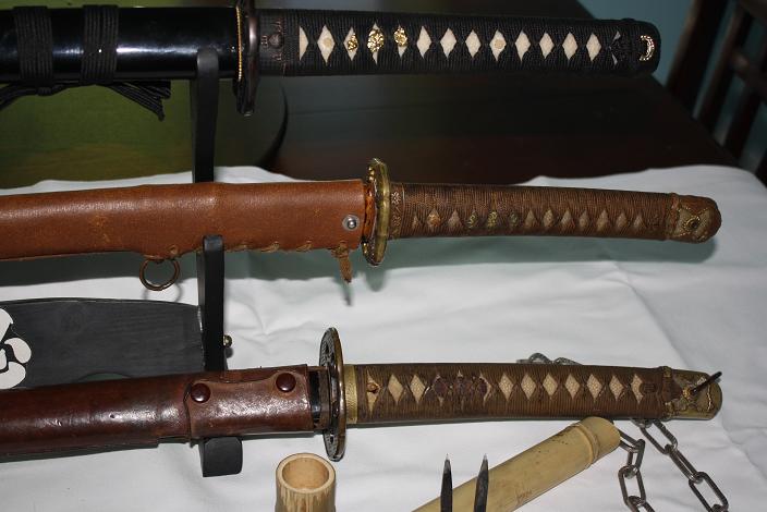

I have the sword with me, came in the mail today, and wow, I really love this sword.

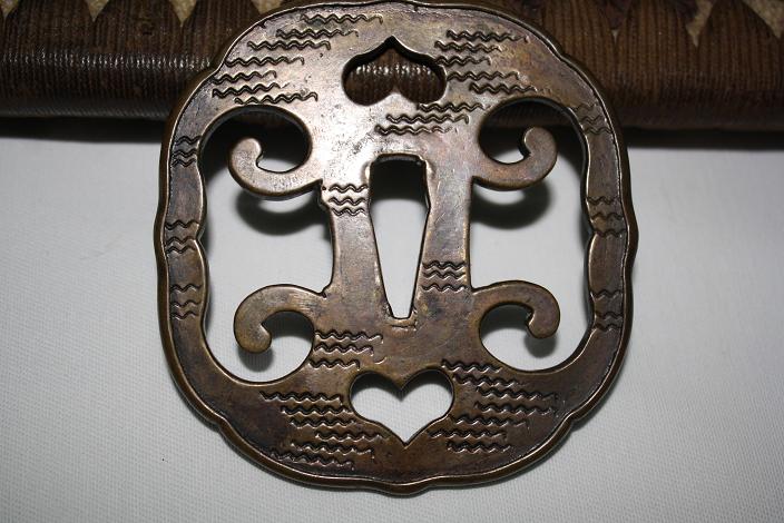

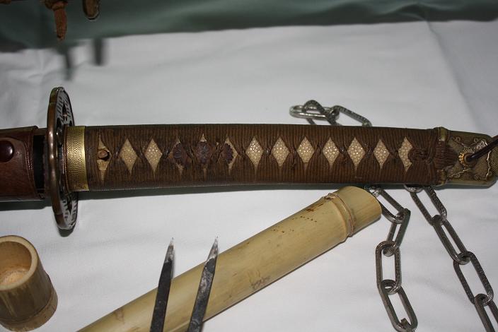

Here are some pics of it, the Tsuba looks all hand carved , not cast, as there are no cast marks at all, the wrapping on the tsuka is in perfect condition, the fittings are different then my other Showa fittings, as this was fitted with combat fittings, as one member said this might have been an family blade taken into combat, as it is an Wakizashi blade in a full size Tsuka, and only one pin hole, so this tsuka must have been made for this sword, as it fits the blade like a glove, perfectly.

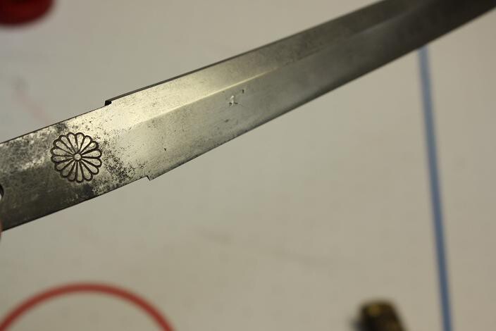

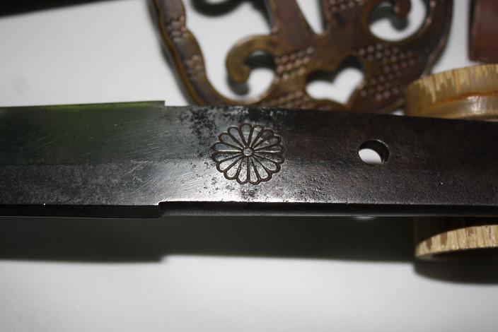

The blade is signed by Bichu No Kami Tachibana Yoshihiro and has a Kiku on the back of the nakago, the blade is 21" long, The hamon is choji, so I think so from my books, and I can see Hada in the blade as well.

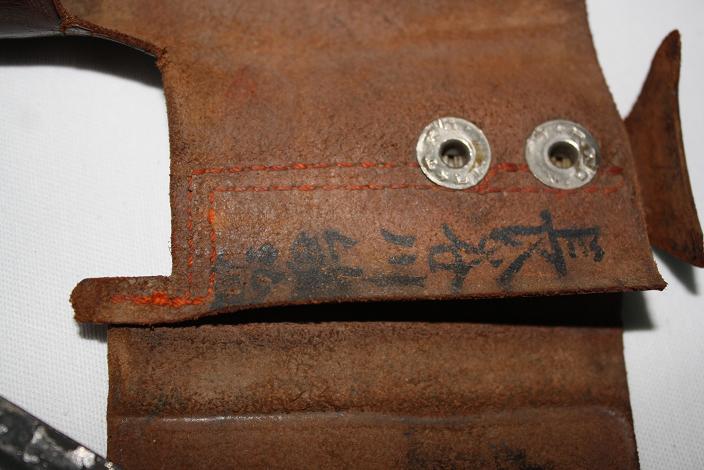

The Saya leather cover had a little surprise I was never told about, it has an American name written on it in pen, as I think that it might have been the GI that brought it home, and the inside of the leather cover has Japanese Kanji, which hopefully would spell the Japanese soldiers name, I cannot read Japanese, so I'm hoping another member in here can tell me what it says.

Yes, I am very happy with this one.
It will be getting a full polish on it, I really like the Tsuba, I didn't at first, I was more interested the blade, and when I saw the name, and Kanji on the leather Saya cover, that really made my day.
Here are a couple more pics of the Tsuka.

Okay, I don't mean to sound stupid here, but I see a lot of swords here lately, where the signature has been chalked in white , is there a purpose for this, other then to bring out the signature for looks only, or what, as I see no other reasoning for it.
Brian
Brian,
When the mei doesn't photograph well, "chalking" the nakago improves the contrast and usually results in better pictures.
Hoanh

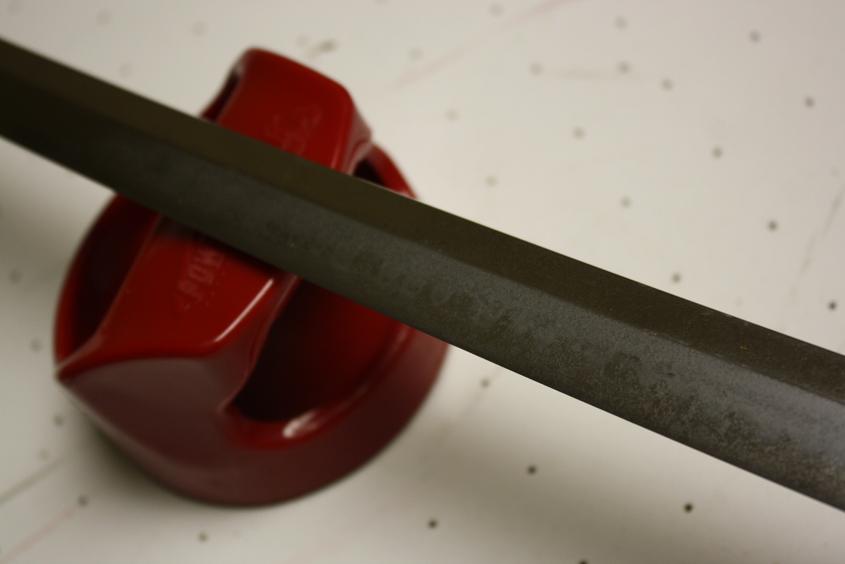

Here are the best possible pics of the Hamon I could get, The blade is need of a good complete polish, which she will be getting.
Some are with the flash, and some are not and i took the pics on top of the air hockey table in the rec room in the basement, because of its white top might have helped.
Either way I'm really happy with it.
Trust me, it is still very sharp where I was was holding the blade where the Habaki would rest, as I was turning the blade to try and get some good pics, I split my thumb open pretty good.
I would still love to know what the Japanese Kanji says on the inside of the leather Saya cover.

Like you advised to do I gave it a good cleaning today, and yes it did help bring out the Hamon, I took this pic earlier, and red outlined the best I could do.
@ Matt, yes I think it does look the same, I did the best with the red out line, but in person it does look the same in the pic you posted.

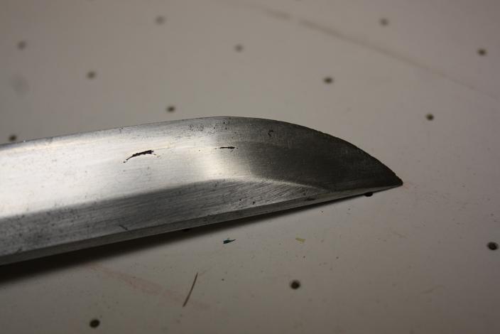

Here are some more pics of the Boshi, and the Yakidashi, on the Boshi you can see some of the Hada activity also.
You can see the Hamon in these pics since I did a good cleaning on it today.
Brian

Hi Brian, you need to be aware that the Yasuhiro has several kizu and there is a fukure which is in the process of opening up. Consider carefully before making the decision to put this sword through a polish, and if you do decide to polish the sword make sure you are going to someone with the training and skills to address these types of problems. You should weigh the costs for restoration and what the end result will be with what you could buy with those same funds. I frequently see nice, signed, ubu, papered, shinto wakizashi in polish with no notable kizu in the 4-5k range.
- Ray
