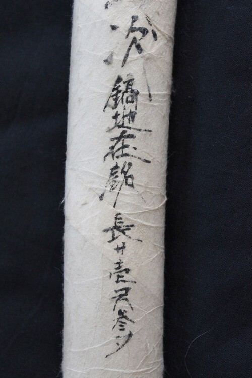

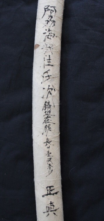

Petersan Posted July 19, 2012 Report Posted July 19, 2012 hello, I got this katakiriha zukuri blade with signature on its side above the shinogi, it is most likely says: 阿州海部住氏次 ashū kaibu ju ujitsugu and perhaps from 1670's ??? I aim to find out more about this nice sword by translating the saya gaki, if anyone could translate it would be great ,also why is the signature on the blade and not on the tang? it is very strange regards Peter G. Quote

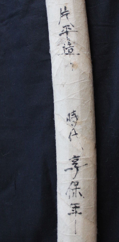

cabowen Posted July 19, 2012 Report Posted July 19, 2012 The paper on the saya (not a sayagaki) just says it is katakiriba and the period of manufacture. I will let you work that out (the last two kanji before the last kanji (year 年) Quote
Petersan Posted July 19, 2012 Author Report Posted July 19, 2012 thank you for the info and the forced lesson, but I can not figure out the 3rd kanji from the back, is this Shoho era, the second kanji looks like it, but these writing are never like in a book, they do differ. Anyone any thoughts why it is signed on the blade? Quote
cabowen Posted July 19, 2012 Report Posted July 19, 2012 享保 it is signed on the blade because that is what some kaifu smiths do.... Quote
