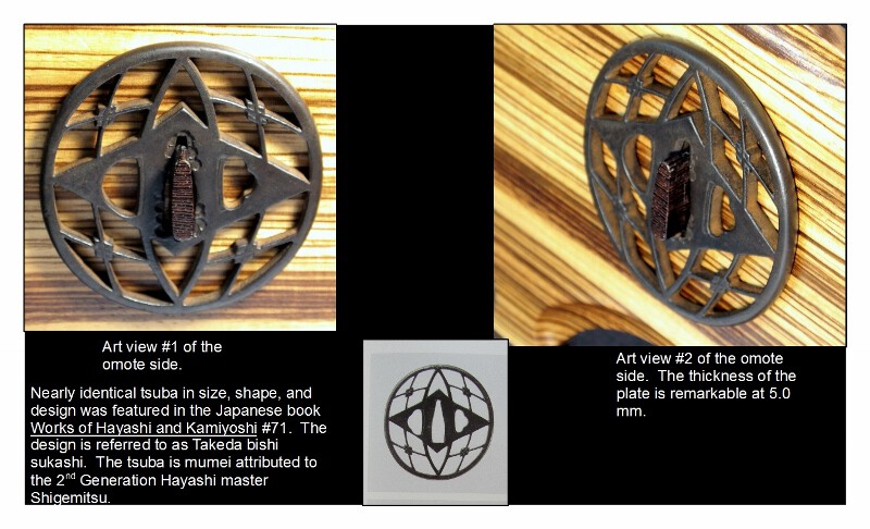

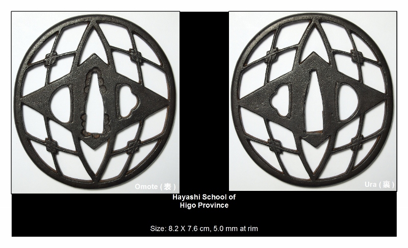

Soshin Posted July 15, 2012 Report Posted July 15, 2012 Hi Everyone, I just finished doing photos of a new tsuba in my more focused and much smaller collection. I hope you enjoy them. This is something different for me as this is my first Higo tsuba. The smooth texture and patina of the iron of this tsuba is wonderful. The former owner was thinking it is a work of the 2nd generation Hayashi school master Shigemitsu. See the second photo for more information. I hope to have a full write up in the comming week about the tsuba on my website. Comments and questions are welcome. Came also across something funny in my reading. It was that Higo tsubako of the Hayashi school were not allow to sign their work until they were 61 years old. Is this true? Have a wonderful weekend. :D P.S. How many Takeda mon can you count on the tsuba? Yours truly, David Stiles Quote
Soshin Posted July 15, 2012 Author Report Posted July 15, 2012 Hi Malcolm, I count six Takeda-mon designs on the tsuba. I am surprised when you said nine. Thanks for looking. Another interesting note about this tsuba. All tsuba I have seen photos of made by Hayashi Shigemitsu have what I think are "soft metal pillows" in the ryo hitsu-ana. This tsuba has what appears to be soft metal pillows in the ryo hitsu-ana that are faux: they are finely carved into the iron. This can also can seen in the photo in the book of the very similar tsuba attributed to Hayashi Shigemitsu. Yours truly, David Stiles Quote

Soshin Posted July 15, 2012 Author Report Posted July 15, 2012 Hi Curren, Nice to hear from you. Very rarely do nice tsuba come along at such reasonable prices. The sukashi design is extremely well done on this tsuba which attracted me to it. The patina and surface texture (migaki-ji) is also very finely done which are all characteristic of Hayashi Shigemitsu work. I am not 100 percent sure it is his work but I am sure of the tsuba quality and fine design. Sometimes the Akasaka copies of Higo work can be very good as well. How many Takeda-mon do you see in my tsuba? Here is a link to Wikipedia as a reference of what the Takeda mon looks like: http://en.wikipedia.org/wiki/Takeda_clan. Yours truly, David Stiles Quote

Baka Gaijin Posted July 15, 2012 Report Posted July 15, 2012 Good evening David, I counted 9 as 4 small Takeda mon in the center of the 4 Sukashi stylized Takeda mon with the central lozenge shape hosting the Nakago ana and Hitsu ana being the 9th Takeda mon in negative profile so to speak. However many, it's a really pleasing design. Cheers Quote
Soshin Posted July 15, 2012 Author Report Posted July 15, 2012 Hi Everyone, Looking at it I am seeing a total on 6 Takeda-mon per side. Two in ji-sukashi and four in kage-sukashi. The 2nd generation Hayashi Shigemitsu was known for mixing positive and negative silhouette designs in his tsuba. Take care and thanks for looking. Yours truly, David Stiles Quote
Curran Posted July 15, 2012 Report Posted July 15, 2012 I see it as Malcolm did. 8 or 9 depending upon whether you count the central one. Quote
Soshin Posted July 15, 2012 Author Report Posted July 15, 2012 Hi Curran, Looking at my tsuba again I do see the nine Takeda-mon represented using different techquies. I love tsuba that make you think about their designs using different techniques. Yours truly, David Stiles Quote

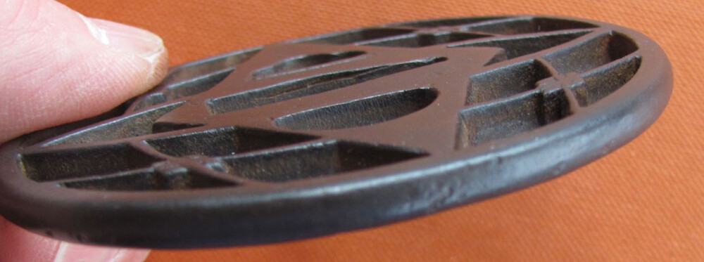

Lorenzo Posted July 16, 2012 Report Posted July 16, 2012 Hi David, lovely design. I'm very keen to Takeda mon and derivatives... still searching for something bearing the kasane bishi mon. This tsuba has what appears to be soft metal pillows in the ryo hitsu-ana that are faux: they are finely carved into the iron. This can also can seen in the photo in the book of the very similar tsuba attributed to Hayashi Shigemitsu. In normal circumstances this fact would make me scream cast; however you are saying that this is a documented feature of Hayashi Shigemitsu? Can you please elaborate more? Please understand I'm not saying you are wrong, one never stops to learn and I'd like to learn more to avoid mistakes. Thank you. Quote
Soshin Posted July 16, 2012 Author Report Posted July 16, 2012 Hi Lorenzo, Thanks for the comment. Looking at the inside surfaces of the sukashi clearly indicate that the tsuba isn't cast. The quality of the iron is also not what you would see in modern cast reproductions. The soft metal "pillows" along the ryo-hitsu ana are not cast like seen often in cast tsuba but are just false craved from the iron of the plate using a kebori technique similar to what is used in the really small Takeda-mon designs. Theses "pillows" are observed in all of Hayashi Shigemitsu tsuba when one exception in the Sasano books and a few other books. In terms of which are real and which are faux it is really hard to tell when I only have black and white photos for most tsuba. Yours truly, David Stiles Quote
Lorenzo Posted July 16, 2012 Report Posted July 16, 2012 David, what I was concentrating on wasn't the fact there was or not soft metal liners on the bottom of the ryohitsu, that is something very common; what surprise me is the fact they are faux and possibly carved in the iron surface. This, if legit, could be the first time I see something like this; I see no reason to do that... So my doubt remain :D Quote
Ford Hallam Posted July 16, 2012 Report Posted July 16, 2012 David, I'm afraid I'm with Lorenzo on this one. The fact that there's no obvious seam line in the sukashi is evidence of nothing really. It's a remarkably simple task to file up a casting. As for quality of steel, modern technology produces flawless steel in casting too. The seki gane in ryo-hitsu are of copper of shakudo (in steel) precisely because they are so much softer and therefore less likely to damage a soft metal kogai or kozuka. The idea of carving faux seki-gane in steel would seem to defy the whole point and simply seems perverse. As you say; Theses "pillows" are observed in all of Hayashi Shigemitsu tsuba when one exception in the Sasano books and a few other books. However, every single example is of copper or shakudo. In fact the texture of the steel and kuchi-beni as well as the condition of the sukashi inner wall suggests to me that this is in fact a cast copy. btw; there is nothing remarkable about a 5mm thick sukashi tsuba either. It's remarkably common in sukashi tsuba. Perhaps it would be helpful to see the example as illustrated in Mr Ito's book. And if there's a single example in there with similar faux carved seki-gane I'll eat my hat. Sorry to go on about this one but if anyone else thinks this sort of detail is legit then they'll also end up with a cast copy....'cos there'll be others. regards, Ford Quote

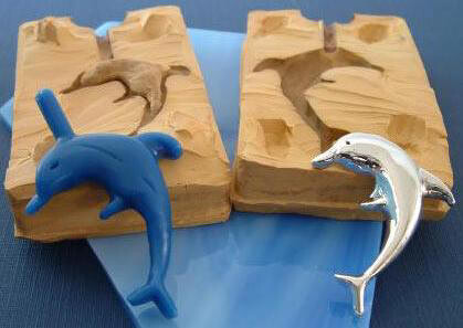

Ford Hallam Posted July 16, 2012 Report Posted July 16, 2012 Brian Perhaps this image will better clarify the casting process. A rubber mould is taken from a metal original. This mould is then cut in half using a scalpel, freeing the original model. The mould is then put together again and molten wax is injected into the cavity under high pressure. Sometimes, if the mould isn't perfectly fitted together over-thick wax seams are formed or the misalignment leads to a 'negative' seam. This could be mistaken for a weld flaw. The wax model can in fact be filed up prior to investing in plaster and the metal casting made. In that case there is no tell tale seam. More commonly the metal model would be cleaned up post casting. Quote

Pete Klein Posted July 17, 2012 Report Posted July 17, 2012 BTW -- I have the feeling it's a Tosa Myochin piece (tagane around the nakago ana) which appears to have been re-patinated -- poorly. If you look in the sukashi you can see over-runs of whatever was used. the coloring also coats the tagane which reinforces the repatination concept. The walls of the sukashi also look to have vertical chisel marks from finishing and yes Brian, that does resemble a lamination opening. Quote
Ford Hallam Posted July 17, 2012 Report Posted July 17, 2012 Hmmm, and where do our resident tsuba experts gain their expertise with respect to casting? But the 'gorilla in the room' remains. Can anyone point to a confirmed antique tsuba with faux/fake carved seki-gane (in steel!) in the ryo-hitsu? If we were talking of the same effect on the nakago-ana the discussion would be over. Frankly I find the willingness to entertain this 'possibility' to be beyond my comprehension. 'Cart before the horse' gentlemen. And on that note I will take my leave.... Quote
Pete Klein Posted July 17, 2012 Report Posted July 17, 2012 Hmmm, and where do our resident tsuba experts gain their expertise with respect to casting? Well, I don't consider myself to be an 'expert' at anything outside my profession but I'd say being a dentist for about twenty five years has given me a bit of an education in metal casting and observation in fine details. Could I be wrong? Of course I could. Actually, I'd love to see this piece in hand and I'll be the first in line to admit if I am mistaken but what I will not do is to abandon my right to express my opinion simply because it deviates from someone else's. Learning is based upon observations and comparisons from many sources, not on just one, no matter how learned that one is. We are ALL capable of error. Quote
