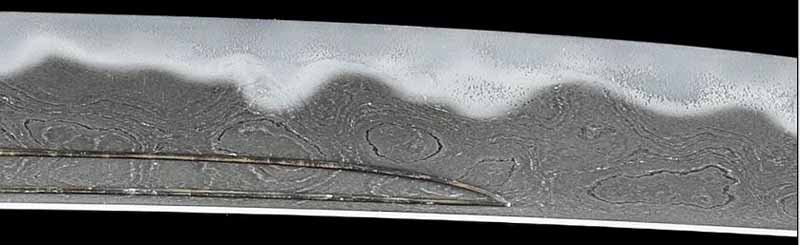

Some works produced by the Shitahara‘s in Bushu are characterized with perfect Mokume - until now I havent seen in pictures an example - such a pure Mokume-hada is known as „Jurin-Moku“ meaning wood burl. There are others associated with wood burl, f.e. - Norishige, Gassan, Hankei, Naotane.
I would suppose, that Jurin-Moku is displayed in a smaller execution and not as bold as in this Katana.
From the pics hamachi - almost not existent - and munemachi are not in line.
The nakago looks to be old.
Has this Katana been polished recently?...is it Japanese polish?
BTW yakumo hada was used by some smiths in forgeries of Soshu works.

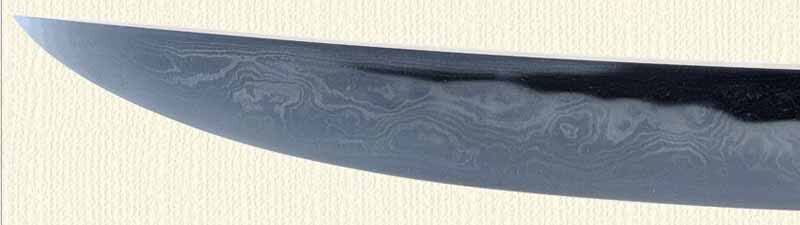

Gassan - Koto - Kitae: Ayasugi hada that is hadamono and has typical Gassan hadaware

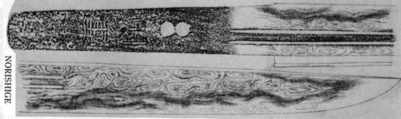

Norishige - Koto - Kitae: Whirlpool itame that is matsukawa hada and has thick ji-nie and strong chikei
Hankei - Shinto - Wakizashi - Kitae: Itame with Masame - O-Mokume
Naotane - Shinshinto - Wakizashi - Kitae: uzu hada - whirlpool like Mokume

MOKUME
As the extreme state of ITAME containing straight grain ends up showing almost no difference from MASAME-HADA, the same could happen to MOKUME in relation to ITAME if the difference is a matter of relativity. That is, there are certain types of MOKUME very difficult to distinguish from ITAME. However, the terminology is not of primary importance. What is essential here is to understand different types of grain formations as factors to facilitate a KANTEI process.
It is quite common to find some MOKUME contained in an overall ITAME-HADA. The greatest majority of blades, from Koto to Shinshinto, is made in ITAME-KITAE. In distinguishing a great many swords according to province, school and so on, you can supplement your analysis by taking other factors into consideration, in sword identification, there are other even more dominant factors that can make your conclusion more definitive in terms of Ji.
Several members have given their opinion and hints:
Paul: Koto Gassan
Matt J: Shitahara
Thomas C Helm: Hayama Enshin
Chris Bowen: Satsuma
I have picked up these ideas and the smiths I have listed show occasionally this form of whirlpool defined Mokume in their works.
Koto Gassan, Norishige with his matsukawa hada, Naotane with his uzu hada. Shitahara is also a good hint. Hayama Enshin from the Kiyomaro group with tight ko-itame mixed with ko-mokume. Satsuma Masayoshi‘s blades sometimes displays areas of o-hada.
It has to be remembered: some works produced by...are characterized with...
Norishige‘s kitae doesn‘t have obligatory the wood burl, but it‘s an important kantei point
Hankei, his kitae sometimes described as a running o-itame, aimed to create Norishige's hada
Naotane worked in different styles, his uzu hada is an important kantei point
