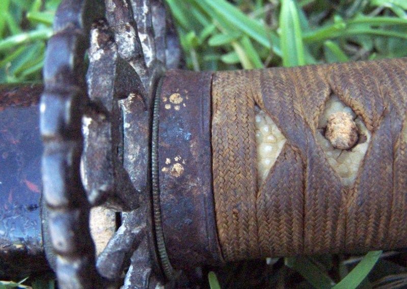

Hi. My name is Pat Hammond. I was given this sword from my dad. In 1945 he was a US Marine in the Battle Of Iwo Jima. This is the sword he returned with from the island. Any info you know will be greatly appreciated.
Also want to know if a sword cleaning kit from ebay will help me protect the sword and it's patina. Or do I need something else for cleaning, not drastic cleaning, just something to preserve and prevent any further rust.

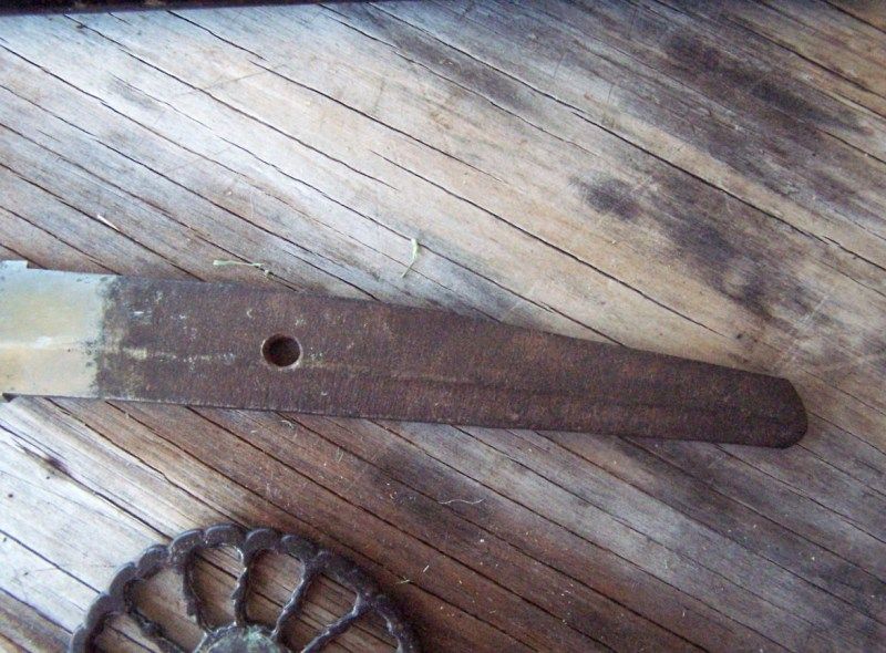

The scabbard is longer than the sword.
The total blade length is 27"
The tang is 6 "
The blade is 21 " where the notches for the habaki rests.
No visible markings on tang.
What else can I tell you?
Here's the pics.

It appears you have a traditionally made nihonto (a wakizashi if I'm understanding your measurements correctly), that is hand forged, water quenched, made from tamahagane. There are a considerable number of articles and glossaries available online to begin becoming acquainted with terms and definitions (see links posted at the top of this website).
The current condition of the sword makes it difficult to tell much more at this time, although the presence of togari in the hamon 'might' hint towards a Mino or Bungo sword, perhaps, just a guess. The habaki looks to be a 2 piece copper with a koke (moss) pattern, which may have been foiled at one time. The menuki are cranes in what looks like shakudo with some gilding. The tsuba and fuchi/kashira are iron, and collectors here will probably id age and schools of manufacturer.
The way the nakago kinks towards the jiri makes me think Hizen Tadakuni.
Here is a good example of what I mean - http://yakiba.com/juyo_token_tadakuni.htm
But in current condition that would be a large assumption to make.
I certainly think that little dog leg in the nakago is a pointer to something - whether it be Tadakuni or another smith/school that shaped their nakago that way.

But yes , get off the grass, and keep it in the saya, some people dont seem to care for the war time made swords, but this one does not have the usual combat fitting's, or the standard Tsuka, or the menuki either for war time swords.
It could be an family blade, and if so it could possibly be an traditionally made blade

There doesn't appear to be anything about this sword that suggests WW2 except that it came from Japan in 1945.
Swords of all ages were taken from Japan at that time so you cannot determine its age from that.

Franco has pretty much covered everything. All I can add is that the style of fittings are usually associated with Higo province, the two piece habaki is a very good fit and so is unlikely to have had a silver or gold foil jacket; I would expect some looseness between the pieces if it had one. Having said that I have one sword where a two piece habaki has been given a single, all over silver foil jacket but this is most unusual.
I should also say that I think this is a nice sword, albeit rather worn and in need of some TLC. Your plan to stabilize it for now is a good one and while it might never repay the cost of restoration financially it would be nice to see it in its full glory. An amazing amount to learn so don't rush into anything but welcome to the board.

The habaki appears to be soldered together. In my youth I remember it was a brass or copper color, never foiled or shiny. Some of the spots of discoloration is the green color that copper gets.

However, the nakago (tang) of a Japanese sword is never cleaned. ;)
