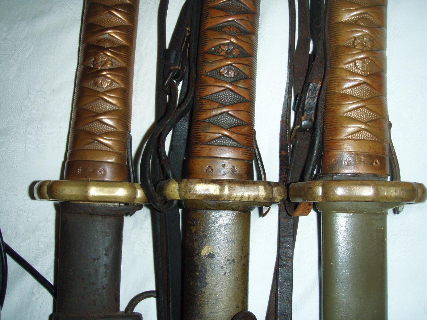

shigezo Posted June 29, 2012 Report Posted June 29, 2012 Bill, This is the first time I've seen a copper handled NCO with mekugi screw as well as with a iron tuba. Also, I've noticed that the position of Suya markings and kokura canon balls on fuchi are switched. This is an another interesting piece. Great piece. Shigezo S. 加州住繁蔵 Quote

Stegel Posted July 13, 2012 Report Posted July 13, 2012 Also, I've noticed that the position of Suya markings and kokura canon balls on fuchi are switched. You have a sharp eye Shigezo S. 加州住繁蔵, i also have one with a similar switch of stampings, i have attached a picture for you to see. It's the centre one of the three, the image name indicates the matching serial numbers respectively. Brian, this is for the militaria collectors amongst us, if you feel it is inapproriate, please remove. Ernst Quote

shigezo Posted July 14, 2012 Report Posted July 14, 2012 Hi Ernst, Nice sets of copper handled Type 95s. Thanks for sharing the nice collections. I wish I had one and am still hoping someday I own one. What I like about Type 95 is that they are government issued military hardware and it also having these variations and anomaly we encounter sometimes fascinates me. Shigezo S. 加州住繁蔵 Quote
