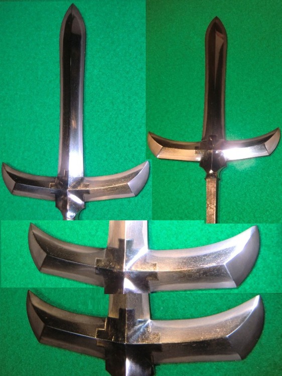

Ken-Hawaii Posted June 21, 2012 Author Report Posted June 21, 2012 Okay, I changed my mind on showing the current condition of my yari. Here are a couple of quick shots: http://img195.imageshack.us/img195/2405/jumonji1.jpg http://img51.imageshack.us/img51/1341/jumonji2.jpg http://img444.imageshack.us/img444/1181 ... xtents.jpg I'm not going to try & take photos of the shaft right now, but it's period-appropriate. By the way, does anyone happen to know anything about the period(s) & smiths who made Jumōnji yari? Ken Quote
NihontoEurope Posted June 21, 2012 Report Posted June 21, 2012 Hello, The correct name for this type of weapon is: MAGARI-YARI, but it is often referred to as JUMONJI or even JYUJI, due to its shape + ten. They appeared first from the 1400's although it is mentioned in writings as three-bladed lances as early as year 500. As we know them now, they are 1400 productions and forwards. Smiths like; Tadayoshi, Inoue Shinkai, Yamamura Kiyomaru, Tsuta Sukehiro, Muramasa, Suishinshi Naotane and possibly the Yamato Kanetsugu line where the greatest YARI smiths. /Martin Quote

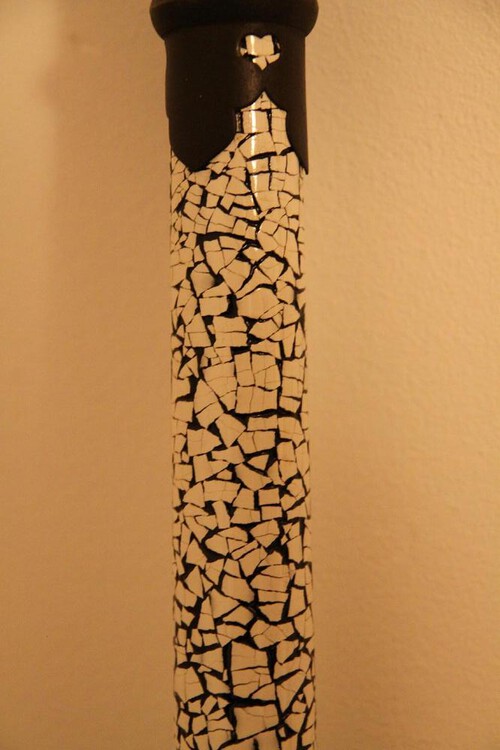

Klop Posted June 25, 2012 Report Posted June 25, 2012 Ken, In a similar situation I had some trouble finding white eggs, but I did. Used xxactly the method Ian described, but without the seafood. From experience I can tell abalone is very hard and it takes a whetstone to polish it, sandpaper didn't work very well. Good luck, Eric K. Quote

IanB Posted June 26, 2012 Report Posted June 26, 2012 Eric, If you ever go down the eggshell route again, don't bother about finding white ones, use the inside surface - they are always white. The trick is to leave the membrane attached to a patch of shell so that when pressed onto a scabbard or whatever it holds all the minute pieces together until they are attached by the glue. You then peel off the membrane and fill the gaps with lacquer. Ian Bottomley Quote

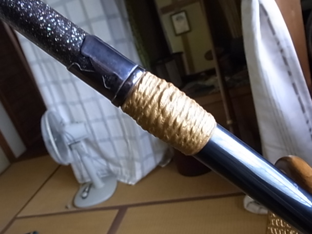

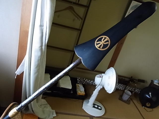

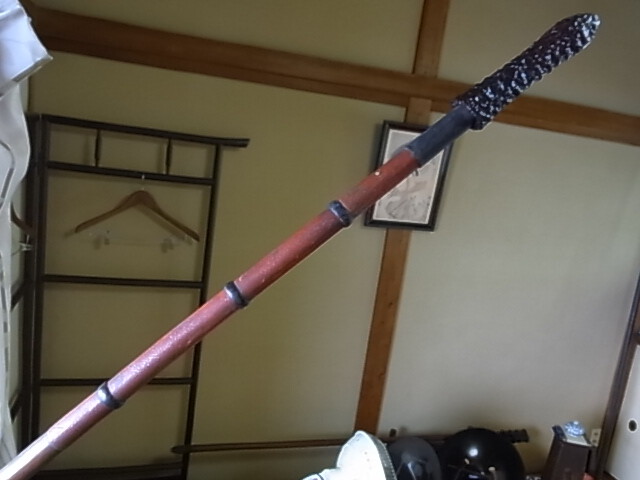

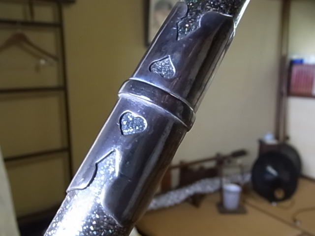

Bugyotsuji Posted June 26, 2012 Report Posted June 26, 2012 The guns are too big for mere spears, Ken. :lol: Here are three spears with representative spear fastenings. 1. Samegawa with red lacquer. 2. Most of the black had come off so I repainted with a generic black matt water paint. Quote

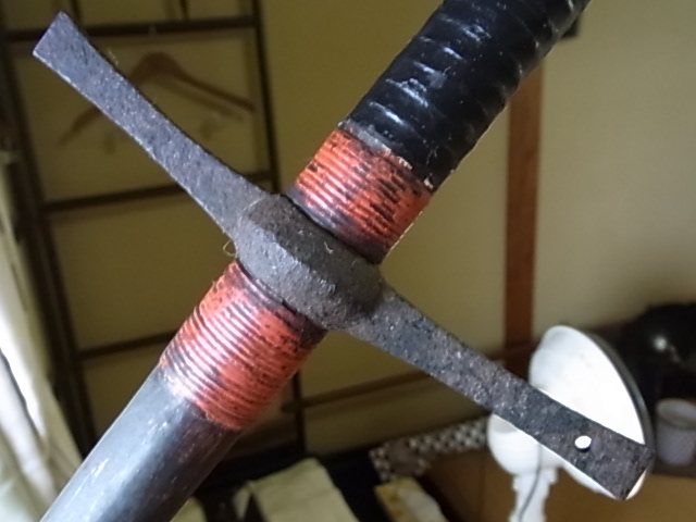

Bugyotsuji Posted June 26, 2012 Report Posted June 26, 2012 No 3. This spear errs towards the fancy. :| Quote
Ken-Hawaii Posted June 26, 2012 Author Report Posted June 26, 2012 Thanks for those sets of close-ups, Piers. They give me some ideas, but I'm not sure if I have the right materials to proceed. I have several square feet of white samegawa; several types of cordage, including some that I hand-made from local plants; a plethora of eggshells from our ducks; our local equivalent of wicker; &, interestingly, a very large mango tree that produces urushiol in its sap. Of course red lacquer & black paint are available locally, too. Now what I need is a plan of attack to build up the yari shaft, & I think may have to wait for the polearms book to get that level of detail. Ken Quote
Bugyotsuji Posted June 26, 2012 Report Posted June 26, 2012 Sounds like hours of fun ahead! PS Did I mention that I envy you that Jumon-ji yari? (Also found the names Kamayari, Ryo-gamayari, Morogama, etc) Some beautiful examples of yari on this thread! Quote
