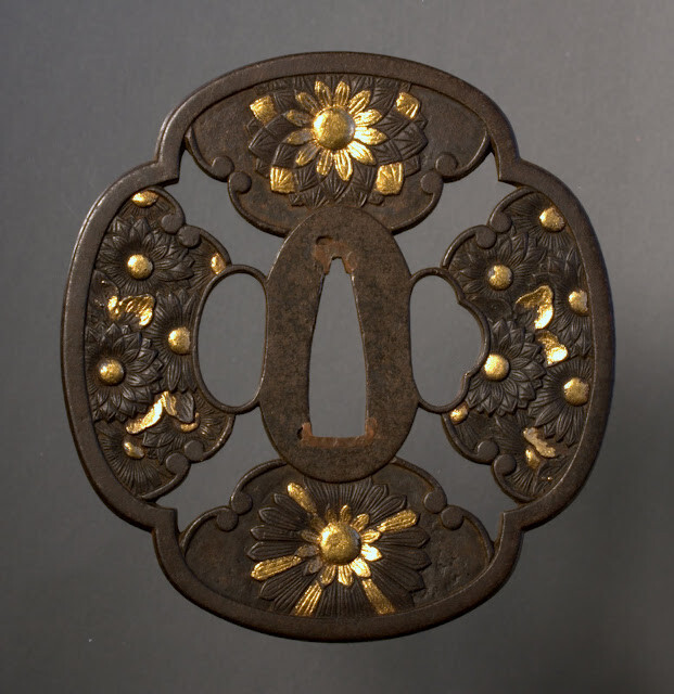

george trotter Posted June 16, 2012 Report Posted June 16, 2012 Hello GeorgeI have looked at your previous post but do not see any images, would you let me know where they are? Grev UK Hi Grev, here are the pics again (don't know what went wrong)... Regards, Quote

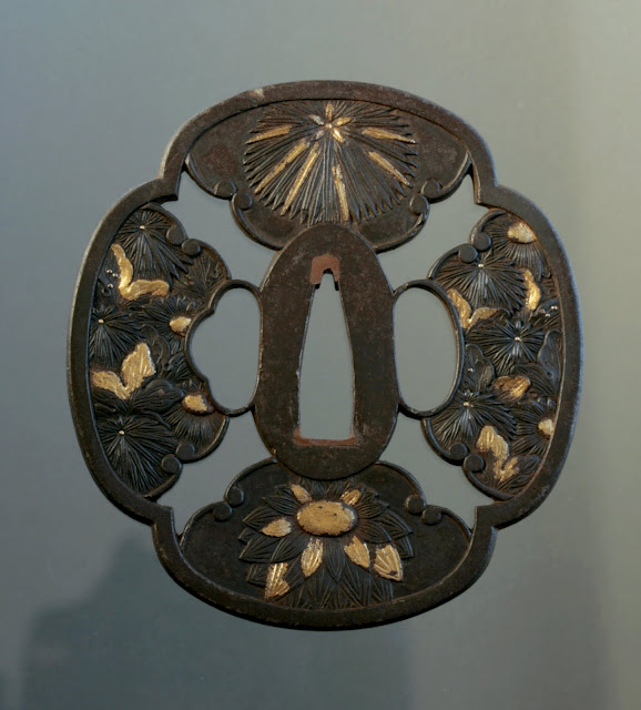

Pete Klein Posted June 16, 2012 Report Posted June 16, 2012 George -- from Ito Mitsuru san's book on Hikozo and Shimizu here is one of the tsuba you mentioned in color: Quote
Brian Posted June 16, 2012 Report Posted June 16, 2012 Just a little difference between the tsuba from the book, and yours Grev. Paperweight isn't an insult if it turns out to be no more than one..and since Lorenzo is one of Ford's students, he knows a little about these things. Might we focus purely on the "iron" ground here? Not much more than that needs to be examined frankly. I know it takes a lot to bring Pete out of hibernation...so that also tells a lot. Brian Quote

george trotter Posted June 17, 2012 Report Posted June 17, 2012 Grev asked the members to help him "find out something about it" . Since then it has been classified as modern Japanese, a fake, reproduction, Meiji, tourist production, hamamono etc and now we have also had a valuation. Before this turns into a sneering war between members, how about you just tell Grev "something about it" and give him your reasons. Regards, Quote

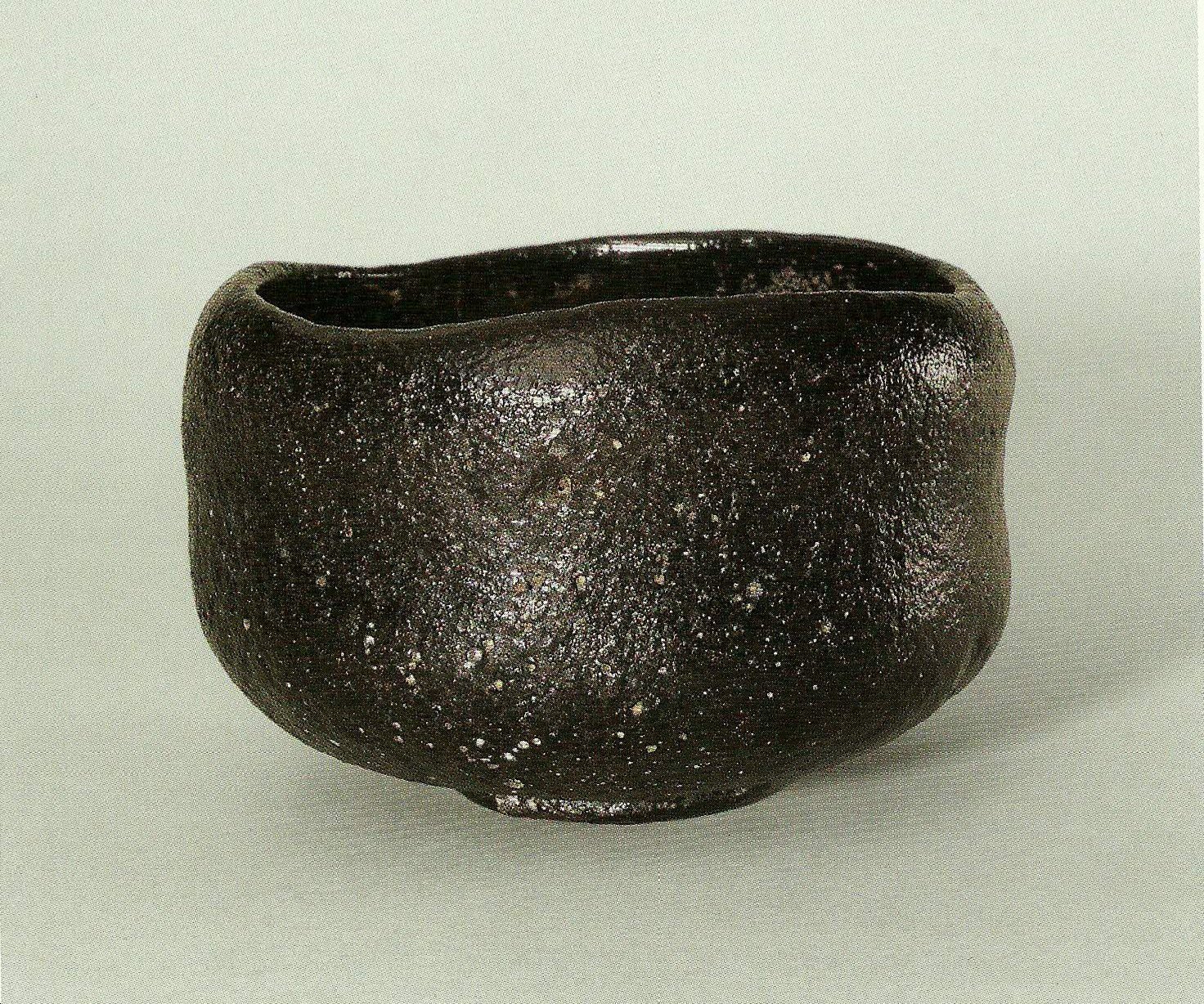

Pete Klein Posted June 17, 2012 Report Posted June 17, 2012 Here are two examples of Chadogu, a Chawan (tea bowl) and a Chaire (tea caddy). Both are, I believe National Treasures: Quote

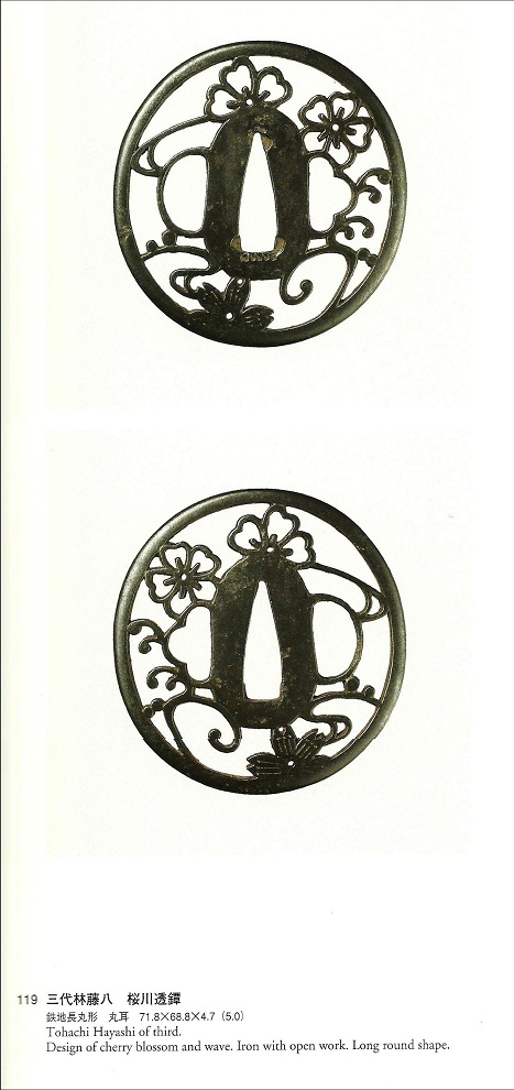

Pete Klein Posted June 17, 2012 Report Posted June 17, 2012 Probably #183. The blossom is so subdued it's hardly noticeable. Brilliant work. Quote

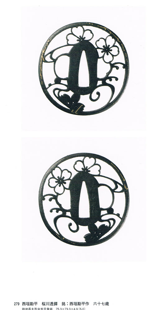

Curran Posted June 17, 2012 Report Posted June 17, 2012 That would be a nice one to own for a few years. For comparison, here are examples of the Nishigaki design. I don't have the Hayashi book, so cannot show the original. Quote
Curran Posted June 17, 2012 Report Posted June 17, 2012 Mm. Nice example of Tohachi. Thank you for sharing that photo. Going to save me down a copy, and I should buy the Hayashi book sooner or later. I think I read that the design was started by Matashichi, but I cannot find the reference. Ito-san says in the Nishigaki section on Kampei that this design probably started in the Hayashi school. Anyway, lots of cross pollination among the original Higo artisans. ~And then there is the derivative Edo-Higo flashy knock-offs: heavy on design elements and light on quality. The Jingo wannabe tsuba that started this thread probably is a late Edo period knockoff for export or merchant grade ware. Good future reference point for comparison to a very nice Shimizu (aka Jingo). Photos rarely do the Shimizu proper justice. More so than with other schools, study of a good Shimizu en Vivo provides that Smack-Forehead-Now_I_Understand moments. Quote

kissakai Posted June 17, 2012 Author Report Posted June 17, 2012 Old Tsuba help Hi I've found quite a lot of info that has helped me with some of my tsuba One of mine is an enigma as I've found nothing like it. Maybe just something of low interest but I'd love to find out something about it. Size 60 x 54 x4mm Synopsis A very low end tsuba made recently (made for western tourists?) more likely a modern fake. I would say low end for export piece like circa the Meiji Period. Inlays very poorly done. Tsuba is NOT bad and Not an "tourist production" How on earth can you attribute this doodle to Nishigaki? That's embarrassing. This one screams Chinese fake or Japanese amateur "doodler" to me. An especially close picture to the your one is here. I think we are getting closer Some of you are clearly going blind. There is not a single feature of this tsuba that is even remotely well done. I would concede that this was by a total amateur My first response was "wow, a Chinese copy or some such" and my gut feeling is still the same. What Christian has quoted so far looks quite reasonable I would not really "hunt" for this spoken Tsuba as, it’s obviously sub in many aspects... Now that I did my homework, I can say that this certainly is not a tourist item. No tourist could have ever chosen that out of the widely available hamamono, for sure. Please.... It's incredible to me we are even discussing about this paperweight. If you look at them (pasted images) you can see a "similarity" in the fact that the iron is beaten and has a design overlaid in copper or brass (like yours) For me the pic tsubas appear quite crude and unremarkable, but as it is part of a learned discussion of Higo artists by Japanese scholars it must be of artistic/historical significance in Japan. I say it also is not to my taste, but I do think now it is possibly above a modern Chinese fake. It appears to be chiselled in high relief and has soft metal overlays which do not usually appear on Chinese junk copies My first look was in reading TB 17-Page 22/mentioned there is one scholar who once studied under Nishigaki Kanshiro...which finally lead us to Higo. Grev asked the members to help him "find out something about it". Since then it has been classified as modern Japanese, a fake, reproduction, Meiji, tourist production, hamamono etc and now we have also had a valuation. Your tsuba appears to be cast. The two open areas in the right side of the seppa dai have no rational use. It is also interesting to note that there is no evidence of seppa zuri, wear marks caused by the seppa against the seppadai. The patina is grayish and blotchy and the overall colour of the metal is gray. This is not in line with forged tsuba and their patinas. The carving is shallow and rounded which I believe equates to not being carved at all but cast and finished. the gold iroe is thin and runs over onto the mimi in one area, although the use of two different colours of gold at least was thoughtful. Keep items such as this, and keep at this hobby. Read online, get together with collectors, attend shows. Every few months, take out your old item, and see how you view it. That's great advice One thing that struck me about this tsuba is the lines. All the curves are hesitant and jagged. Nothing flowing. Note the lines within the flowers. This isn't any "wabi" or "sabi" or artistic freedom. It is hesitation and lack of skill. Cut by an amateurs who doesn't know how to use the chisel yet. The cutting around the subjects to give them some form of depth is just badly done. As Pete noted. My conclusion Poor quality (amateur/not decided) and made of poor iron. The only image from Ito Mitsuru san's book on Hikozo and Shimizu that had some common points but I concede this image was of much better quality. They observations that helped me were the grey colour (not good), no seppa marks and a good learning exercise. If it was decided not to pursue this discussion there wouldn’t have been over 50 posts! So apart from obvious fakes/repro’s all tsuba are worth a second look. I still like this tsuba, my first of a collection of just over 30 tsuba. I’m sure my next request for help with another tsuba (better quality) will not spark as much discussion Many thanks to all contributors Grev UK Quote

christianmalterre Posted June 18, 2012 Report Posted June 18, 2012 Hah! At least i do see that now we can proceed here- Pete -Thank you for your´s excellent writing and additions, Curran (Ditto)(just letting you know that i am very well aware about those cross-overs) Pete-where i actually do not agree is to say it´s cast iron. I rather see it as an formerly heavily "worn" one,which latter(those times)has ben "cleaned" by an amatheur... Now comming back to the very beginning relating to the nice Torist Item again-as this was the main reason i did allow me so to write some thoughts i had in reading about it in first... Attached is an "canditate"-in equally bad execution,quality and preservation-just that here,it not yet got "professionally restaured" like our´s topic-candidate. Just headaking about "mine" here-seeing some parrallels in the t.c-i may guess,those both do not lay such far from each other-comming (eventually?) out from hands of an Tsubashi working under an schoolar named Yatsushiro Sandaime from Jingo who after Kümmel had several workers producing Tsuba mainly for the Chugen and/or Komono level. Not having possibility so to verify due parallel facts,i but tend to agree here with him. Of course-both of those Tsuba are out of topic to do serious research and would ben even not looked at,if we do have an trip to an fair or an show(at least not by me here)-on the other hand,those do me some nice research work. Either way... Christian Quote

Ford Hallam Posted June 28, 2012 Report Posted June 28, 2012 Evening Gents I'm a little bemused to see the lengthy discussion this poor orphan tsuba has engendered :D For what it's worth here's my take on it. This looks to me to be a perfectly honest bit of amateur/hobbyist work made in the last 50 years and most probably in Japan. Stylistically it seems to borrow elements from a number of periods and schools, in effect it's a bit of a pastiche really. The most obvious influence in the technique used is Bushu. Which is to say the maker liked the way Bushu work was carried out and tried to emulate it. Mention has been made of similarities to various Higo makers work and while this may be true all it really tells us is that the maker was influenced by those styles also. The workmanship is ultimately what reveals the work to be that of an amateur though. The carving is unsteady and while we do see a certain rustic quality in some Higo works it's never crude or unskilled, which this example undeniably is. The chiselling around the 'flowers', to throw them into relief, is slapdash in the way the maker hasn't even attempted to even out the level changes and the overall feeling of the carving is awkward and angular which makes me feel there was a lack of real control of the chisel. As for the nakago-ana and the surrounding sappa-dai area I think it reveals a lack of consideration of any functional requirements with respect to mounting. This is something many Japanese hobbyists seemed to get wrong in the past. As for the steel patina, I wouldn't call it that at all. It looks to be a fairly thin commercial blue/browning type colouring/stain and has been well rubbed off on all the high points to reveal a completely characterless metal underneath. Anyway, that's just my opinion. regards, Ford Quote
Brian Posted June 28, 2012 Report Posted June 28, 2012 When I did a sumary you said I was jumping to the wrong conclusions and best wait until there was a more rounded opinion Are we at a stage where some sort of suming up can be made? Now we are. Welcome back from Japan Ford, and thanks for the expert analysis. I would call that definitive, case closed. Brian Quote
