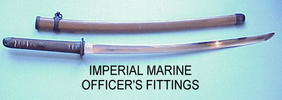

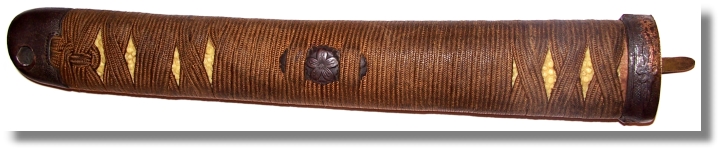

george trotter Posted June 1, 2012 Author Report Posted June 1, 2012 Hi David, Thanks, I'll keep that in mind. I've prepared the tsuka and everything fits well...I'm just waiting for the ito to arrive and then...whammo! (I hope). Will take it slow and careful. The pics show another Kanehide mounted in Type 3 identical to mine and the closeup is the pattern of tsukamaki in detail. I thought I'd keep it the same as a known example. Regards, Quote
