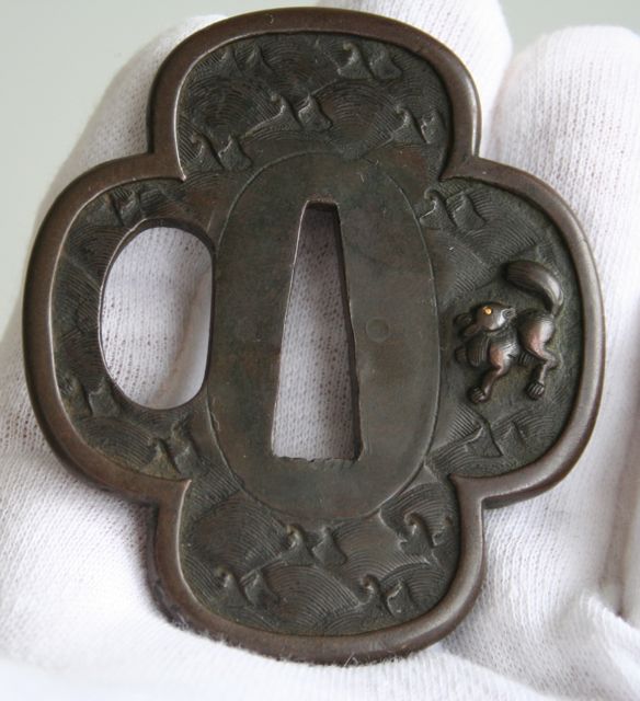

NihontoEurope Posted May 23, 2012 Report Posted May 23, 2012 Hello, Here is a nice tsuba which is fitted on a koshirae of mine. Does anyone of you experts know the origin? [attachment=5]a.JPG[/attachment] [attachment=4]b.JPG[/attachment] [attachment=3]c.JPG[/attachment] [attachment=2]d.JPG[/attachment] [attachment=1]e.JPG[/attachment] [attachment=0]f.JPG[/attachment] Adding 2 more pics in my own reply to this. Thank you /Martin Quote

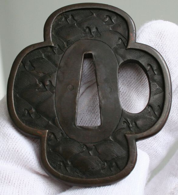

NihontoEurope Posted May 23, 2012 Author Report Posted May 23, 2012 Hello, Two more: [attachment=1]g.JPG[/attachment] [attachment=0]h.JPG[/attachment] Thank you for looking! /Martin Quote
Ford Hallam Posted May 23, 2012 Report Posted May 23, 2012 The fact that the front and back are identical indicates that the veneers of metal that have been applied to front and back (of the copper core) were produced from the same die. In essence, mass produced. In my opinion this relegates this sort of work to 'mass produced' simulation/copy. The actual artefact itself (again, imo) is merely a cheap and quick representation of a fairly generic type of tsuba. regards, fh Quote

Ford Hallam Posted May 24, 2012 Report Posted May 24, 2012 Martin, If you examine the two sides of this tsuba you will discover that they are identical. I don't just mean similar but that they are formed from the same die. Look for an irregularity in one side and you will find the same 'mistake' in the other image. What this reveals is that both veneers were stamped out from the same carved steel die. The time and effort it would take to create such a die means it would have been used to produce many such stampings/veneers. These thin sheets, with their stamped decoration, are then simply soldered to a copper core thus bypassing the need for any skilled decorative work on the part of the artisan who put the 3 components together. This is the essence of mass-production. Of course, not all 'san-mai' tsuba are similarly mass produced. Those early ko-kinko examples I've seen tend to be made up of far more carefully hand worked sheets applied to a copper(or yamagane) core. I think it very important to distinguish between these individually and hand worked types and later stamped simulations. I hope that clarifies what I was trying to say. regards, Ford p.s. It's probably worth noting that the koshirae is a handachi style and that this tsuba is entirely different workmanship. It suggests that the original tsuba to this koshirae has been replaced. A pity really as it seems quite nice and I gather the blade that accompanies it is a Kinmichi. If it were up to me I'd try to find a more fitting handachi tsuba in shibuichi (?) that would better complete the set. Quote

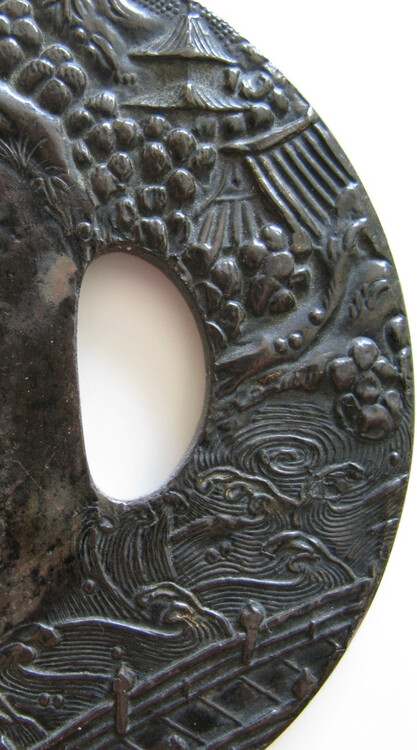

Marius Posted May 24, 2012 Report Posted May 24, 2012 since Ford has mentioned ko-kinko sanmai, let me show you a sanmai tsuba papered to ko-kinko. See the difference? Quote
Curran Posted May 24, 2012 Report Posted May 24, 2012 Mariusz, One of these tsuba came up for sale recently in Japan. I was trying to remember where I'd seen it before. I don't think it was as clean as your example, but still a ringer. Quote
Marius Posted May 24, 2012 Report Posted May 24, 2012 Curran said: Mariusz, One of these tsuba came up for sale recently in Japan. I was trying to remember where I'd seen it before. I don't think it was as clean as your example, but still a ringer. Well, it was me who has bought it I will now have two identical tsuba - I will compare them carefully to assess to what degree ko-kinko tsuba have been manufactured "from one mold". Quote
Curran Posted May 24, 2012 Report Posted May 24, 2012 Tre ja vu?? http://page5.auctions.yahoo.co.jp/jp/auction/e126994319 My experience with such things is the cosmos shows us two or three within 6 months, then we never see another. There are two Ono and one Ko-Akasaka designs that I have had this experience and am still waiting several years for the next one, having let the previous two or three go... Quote
Ford Hallam Posted May 24, 2012 Report Posted May 24, 2012 Mariusz, I don't think you example was made from stamped plates actually. Look at the thickness of the plates and consider the relative sharpness of the chiselled lines of the waves. Curran, the example you've linked to seems similar but if you overlay the patterns they don't actually match up with Mariusz' one. This one also, imo, is hand worked and not stamped from a die. Quote
Marius Posted May 24, 2012 Report Posted May 24, 2012 @Ford Thanks for pointing this out. I wonder why the sandwich construction @Curran Thanks, this is quite amazing... A third one! Quote
Ford Hallam Posted May 24, 2012 Report Posted May 24, 2012 The san mai approach make sense if you consider the cost of a solid plate of shakudo. Quote
Marius Posted May 24, 2012 Report Posted May 24, 2012 Ford Hallam said: The san mai approach make sense if you consider the cost of a solid plate of shakudo. Yes, but this tsuba is made from 3 layers of yamagane, I believe. At least, I am sure there is no shakudo in this tsuba.... Quote
Curran Posted May 24, 2012 Report Posted May 24, 2012 Ford is very right about the tsuba being different. Most notable is positive waves on one being raised, while on the other they carve into the plate. The yamagane sanmai construction is a bit of a logic mystery. _____________________________________________________________ To return to the original thread, I too see a sanmai style tsuba. Quote
