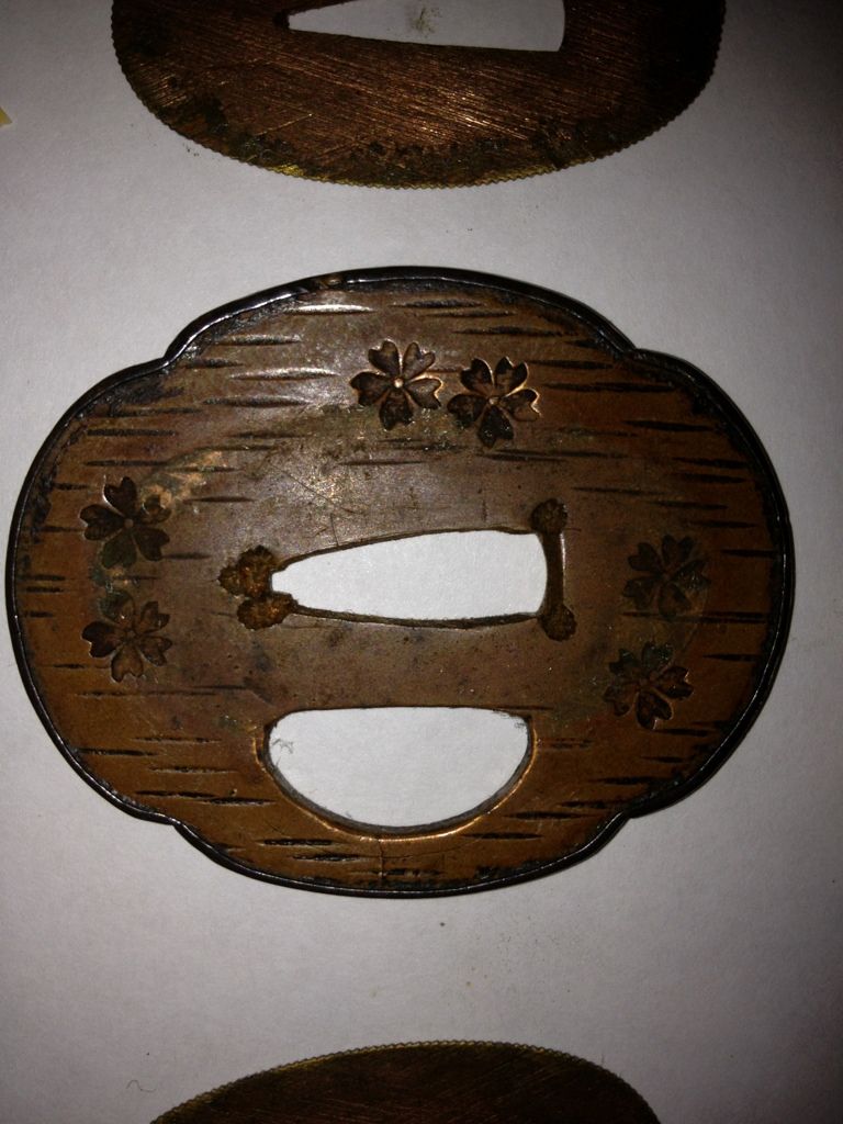

Some additional pix....
Temper line
Tsuba
Other hardware

My mother also has a half dozen silver and gold inlaid and signed tsuba, and my brother a shorter blade than the gunto. I will see If I can get some pictures....

Regardless of the p[rospect of the little tanto being gimei or not it is still a nice little sword in what would usually be described as Higo style mounts. I would suggest that you carefully remove the sticky tape and the label from the saya, sometimes tape adhesive can leave a mark.
I'm sure we would all enjoy seeing pictures of your other family treasures.
