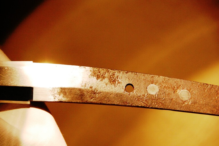

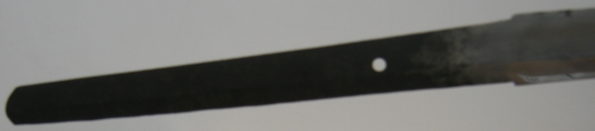

Jacques Posted May 19, 2012 Report Posted May 19, 2012 Hi, Hello, An Uchigatana with a nakago of 20.3 cm? /Martin With such a nakago, i would call it katana, uchigatana was intended to be used with one hand only. Quote
hxv Posted May 19, 2012 Author Report Posted May 19, 2012 Hi Martin and Jacques, I am a bit bothered by how long the nakago is, too, but don't know how to deal with this issue. It's ubu - no question about that. Would it be proper to call this sword a ko katana then? Regards, Hoanh Quote
hxv Posted May 19, 2012 Author Report Posted May 19, 2012 Hi Jean, I don't understand your remark. Will you please expand on it? Regards, Hoanh Quote

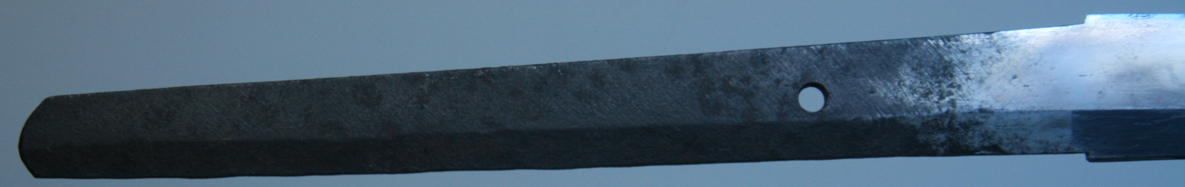

Jean Posted May 19, 2012 Report Posted May 19, 2012 Two questions: What does mean, ubu? Have you ever seen ubu sword with ha machi/mune machi not aligned? Quote
Jacques Posted May 19, 2012 Report Posted May 19, 2012 Hi, Jean, if you look at the picture named suguta, you will see that the machi are well placed. Quote

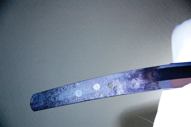

Jean Posted May 19, 2012 Report Posted May 19, 2012 Jacques, Even in suguta they seem to be not strictly aligned. Even with distortion, how can one take a picture of a nakago from above, including the machi and having the hamachi so shifted. How can appear such distortion? They appear in both pictures under the suguta one. Here is the answer of Hoanh: Jean: You are right about the munemachi and the hamachi not lining up. Question: Hoanh, are in reality both machi aligned, or not (we are not talking about your pictures)? Quote
runagmc Posted May 19, 2012 Report Posted May 19, 2012 Jean, even if they weren't aligned, I have seen swords that I would consider ubu that have had the hamachi repaired, moving it forward slightly... Quote
hxv Posted May 19, 2012 Author Report Posted May 19, 2012 Hi Jean and Jacques, OK, I understand the question now - with the sword's *ACTUAL* alignment of the hamachi and munemachi, not about my artistic talent with combining pictures. In reality, with the sword in hand, the hamachi and munemachi do match up well. Above is another picture of the nakago. When I combine the pictures, they appear not to match up due to my lack of proficiency with pictures. BTW, ubu means unaltered, and the nakago is unquestionably unaltered, as I can see the sword in hand. Regards, Hoanh Quote

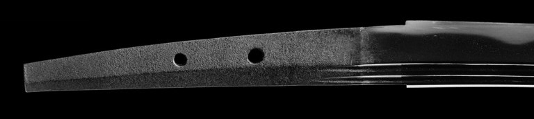

Jean Posted May 19, 2012 Report Posted May 19, 2012 Adam, Not by NBTHK, furthermore, dangerous if there is not a new custom made habaki, it depends of course of the shift. Pictures are so deceiptive, even with the last picture provided by Hoanh, they are not aligned. Hamachi should be more to the left. Anyway, just to say that ubu means that in no case hamachi has been moved since the blade has been forged (all things remaining unchanged from the date of forge) or the blade is hamachi okurin and the nakago not anymore ubu. It is possible that the blade was forge like this and in this case it is ubu Here are a few examples of what I call machi aligned so you can compare Quote

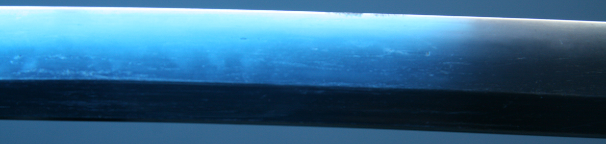

hxv Posted May 21, 2012 Author Report Posted May 21, 2012 Hi Everyone, After some fiddling around, I managed to take better pictures. I don't know if the pics are good enough to dating the blade approximately, but they are better than before. Regards, Hoanh Quote

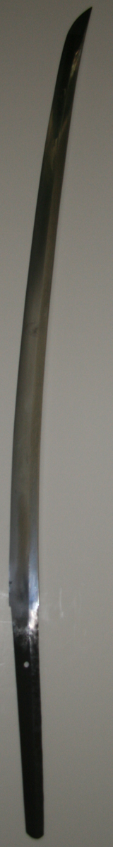

sanjuro Posted May 21, 2012 Report Posted May 21, 2012 Maybe its just me, and my gears are starting to slip in my advance toward venerability, but this nakago just doesnt look right to me. It appears firstly to be curved slightly toward the ha. This may be a photographic effect of course. However, secondly the nakago appears to be too long for an uchigatana. A much later sword maybe, but not a koto blade may have this feature. If it is shinto then it cant be an uchigatana as has been observed. The pics are still not high enough res to make any call on the quality. An overall pic of the sugata would help a lot. Quote
hxv Posted May 21, 2012 Author Report Posted May 21, 2012 Hi Keith, Here is a pic of the overall shape. In the mean time, I'll make another attempt at hi res pics. Regards, Hoanh Quote

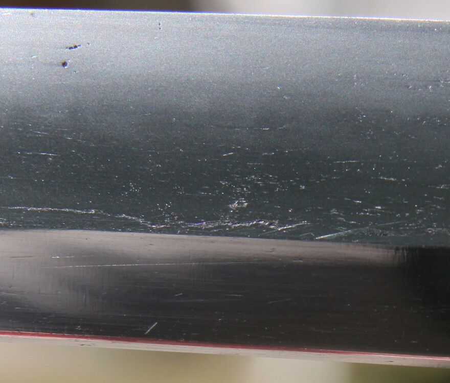

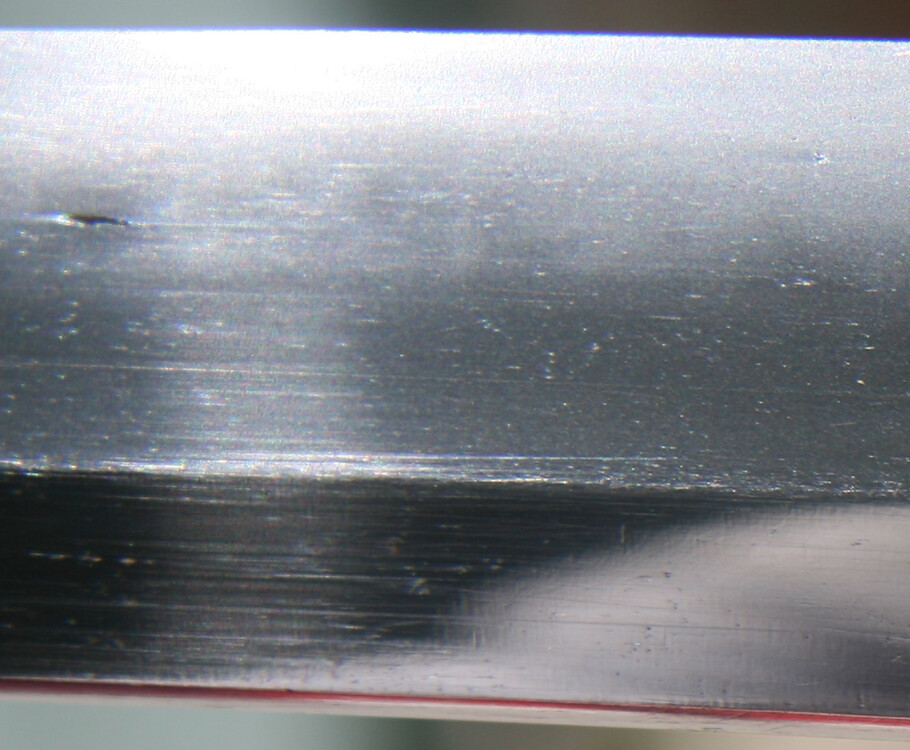

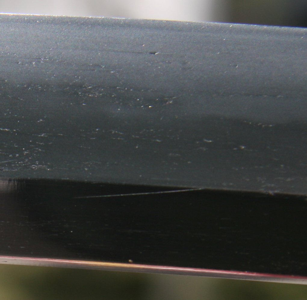

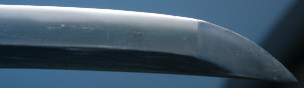

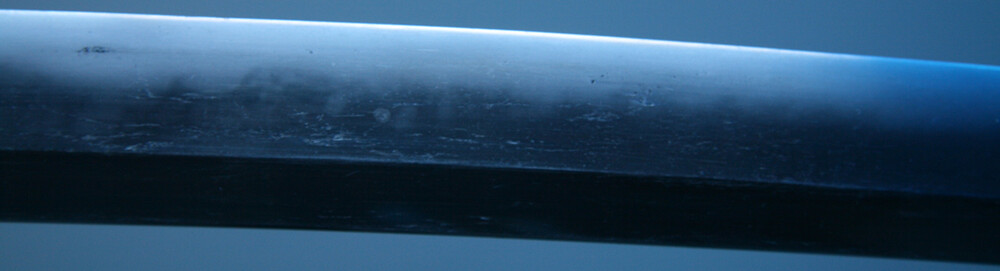

hxv Posted May 22, 2012 Author Report Posted May 22, 2012 Hi Keith, I tried taking close up pictures of small segments of the blade. The pics are in good focus and I didn't have to degrade the resolution. If they still are not sufficiently hires, then my lens is probably not good enough for the job. Regards, Hoanh Quote
sanjuro Posted May 22, 2012 Report Posted May 22, 2012 Hi Hoanh. Better pictures... Thanks. This blade strikes me as a late Momoyama Katana rather than an Uchigatana. The sugata is reminiscent of a few similar katana I have seen from that period, and the nakago is far more katana-like than an uchigatana usually presents. Koshi sori says koto and the steel and apparent quality also point to a Momoyama date. Theres a few small openings in the hada which are also reminiscent of meduim quality work of this period after a few polishes have reduced the surface steel. In a way the forging is a little rough, which suggests a sword of the Sengoku Jidai by a competent maker but produced to a lower quality or a lower price. Not uncommon in that period. The above is merely my impression and of course others may not agree. Kantei is a difficult enough process even when the sword is in hand. Kantei by photograph is for the very brave or the very confident. An interesting blade though. Quote
hxv Posted May 22, 2012 Author Report Posted May 22, 2012 Thank you Keith. Very interesting analysis! I suppose 23.5" is on the very short end of the katana range, so it's still acceptable to call it a katana. The hamon is not sophisticated, but pleasing to look at. Regards, Hoanh Quote
