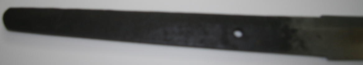

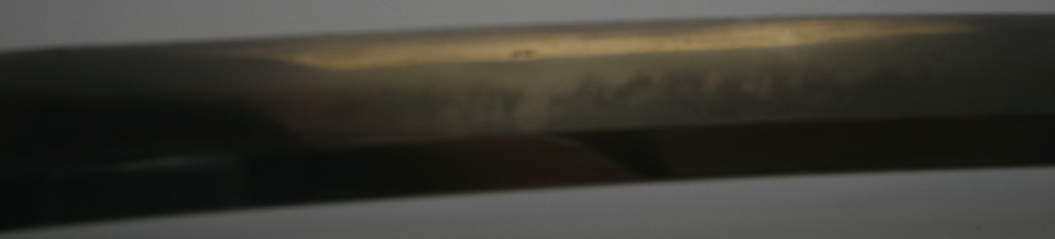

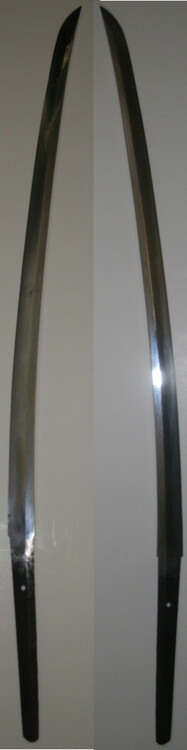

hxv Posted May 18, 2012 Author Report Posted May 18, 2012 Jacques: *NICE* example! Jean: Thank you! I just bought a sword from a collector in WA near the Seattle area. The seller told me it's a wakizashi circa 1600s. To make the long story short, just as luck would have it, the measurements and the look of the sword look suspiciously like those of a kodachi/uchigatana. The hamon is very flamboyant and reaches all the way up to the shinogi throughout the length of the sword, but it's in old polish and hard to photograph. I have to turn the sword at just the right angle to see the details. I would stick my neck out and say it looks hitatsura. The nakago is mumei, ubu with 1 mekugi ana. Here are the stats: Nagasa: 23.5" (59.7cm) Sori: 5/8" (1.6cm) Motokasane: 0.225" (5.7mm) Motohaba: 1.1" (2.8cm) Sakihaba:0.73" (1.9cm) Kissaki: 1.42" (3.6cm) Nakago: 8" (20.3cm) I wonder why the nakago is so long .... Anyhow, any thought you have on this sword's provenance, especially in relation to the discussion of kodachi vs. uchigatana, is much appreciated. I have pretty much convinced myself that this sword is either an uchigatana or a kodachi, but which one???? If you want pictures of the hada, I can take it outside tomorrow for better lightning. My roofers are going nuts outside. In the mean time, these are the pics I can provide at the moment. Sorry for the picture quality, but without my usual set up and a tripod, it's hard to take sharp pictures. Regards, Hoanh Quote

Jean Posted May 19, 2012 Report Posted May 19, 2012 I have got a problem with your sword, Hoan, munemachi and hamachi are not aligned on your picture Quote

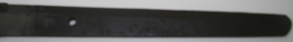

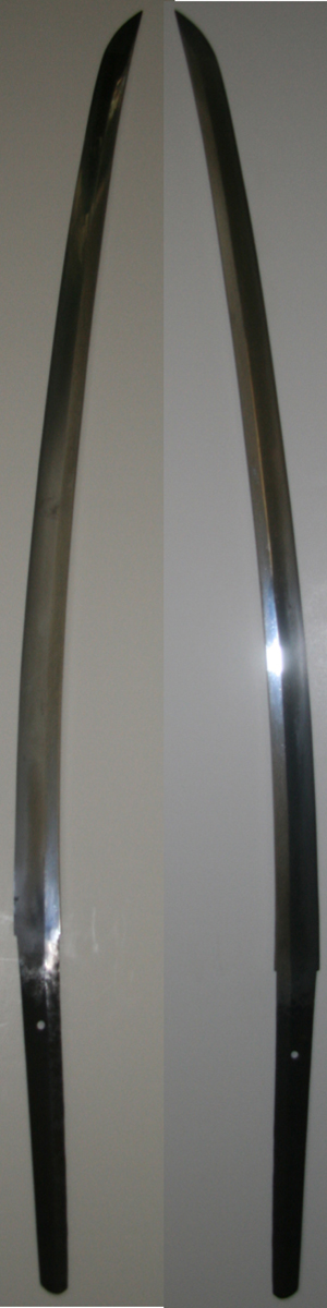

hxv Posted May 19, 2012 Author Report Posted May 19, 2012 Thank you Keith! I'm glad you found my analogy humorous! Jean: You are right about the munemachi and the hamachi not lining up. I am not too proficient with Adobe Photoshop and Adobe Illustrator. On top of that, I'm not too good of a photographer. The (deadly) combination shows in the first picture. I took two different photographs, one of the omote and one of the ura side. Then I cropped each one, inserted the cropped pictures into an Adobe Illustrator canvas and resize them and move them around until they approximately match up. I don't know of a way to do it precisely. Any suggestions on how I can do a better job would be much appreciated as always. Regards, Hoanh Quote
NihontoEurope Posted May 19, 2012 Report Posted May 19, 2012 Hello, An Uchigatana with a nakago of 20.3 cm? /Martin Quote
