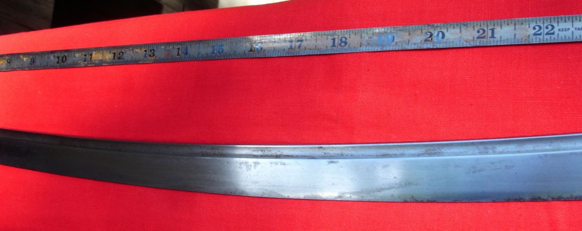

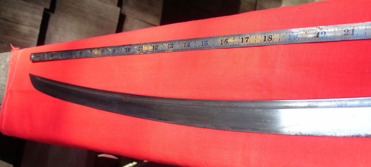

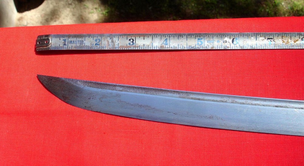

Hello Everyone,
I have a Japanese sword that I would like to know about. Assistance in identification, age, etc. would be greatly appreciated.
Thank you.
Pastor B
The sugata indicates that this would be a koto sword if genuine. I add if just because the bohi is done either very poorly or the corrosion has given it the look that it was done very poorly. This make me nervous that it was an artificially aged reproduction. Beyond the basic era as given, there is nothing to base more of an opinion on as the blade is in a state of disrepair that doesn't allow for an identification based on characteristics of the steel.

Looks like its been in a fire to me.
Can you see the hamon?
Simon K
I can see a hamon.

Hi, i would expect the sori to be a lot less with a shortened Koto blade. This one has 3 mekugi-ana and nothing has been taken away from the curve.
I would suspect this is not Koto and is much later.
also Koto period blades or earlier tachi would have the bend of the blade much lower towards the nakago. This one is dead center.
Perhaps this is a student blade. It doesnt look well made to me ( no Yashiri- me evident, and the entire shape isnt graceful, the sori makes the blade seem to sag and it looks more like a saber in shape, not a katana or tachi.
My humble uneducated two cents.
Chris

I can't be sure, of course, but when the sori is so deep and there are kizu, I suspect retemper. Nakago looks crisped, also. And the hamon appears weak and uneven. All signs of possible retemper.

I admire the setup in the 1st picture.
The combination of the almost antique measuring tape with this blade which does not come from a very good home either, intrigues me.
Adding the red background this makes a perfect piece of art to be exhibited in a good art gallery.
We just have to find a good name for it!
;) Martin

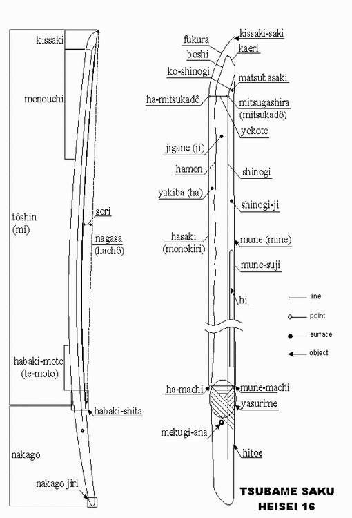

What Jacques meant is that sori needs to be measured when taking a straight line from kissaki to mune machi. When seeing what seems to be a huge sori, you need to check that the person isn't using the straight line from kissaki to nakago jiri to measure sori.

That is the nagasa..don't worry, you did everything right. My explanation was for Chris and Jacques. Sori is the depth of the curve. Will measure differently if you use a line from kissaki to mune machi...or kissaki to tip of tang. Sori isn't measured using the latter method ever.
