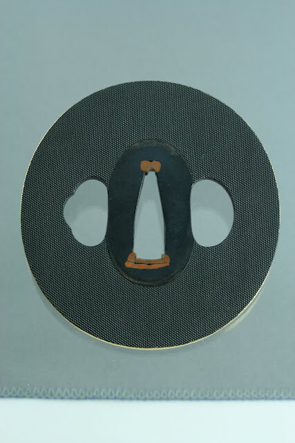

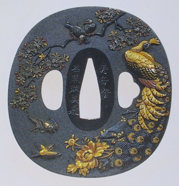

Brian commented about nanako on the "modern tsuba" post, and I started looking through some example I had. I wanted to see if Ford, or any of the other tsuba-shi on the forum, could comment on how difficult this would be and how long it would take. post-2413-14196830468308_thumb.jpg

Ford, I have tried doing nanako, and that is what made me somewhat in awe of the time and skill that must go into doing a piece like the one I posted. I guess my questions weren't really answerable, since like you said, there are several factors that would come into play. I just wanted to hear the experts give some insite on the difficulty and time that it takes. On the tsuba I posted, the dots are so small and precise, I imagine it would be a serious undertaking even for a master of the craft.

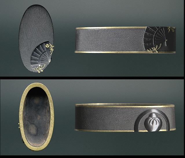

When you see really perfect nanako, it's an amazing thing. Like on this fuchi kashira, it's so perfect it's almost like an optical illusion. post-2413-14196830472395_thumb.jpg
Adam,
Wow..I will direct people here every time they post that mediocre stuff and ask if it is Goto. Good to see really good nanako, and then compare with average or sloppy work. That f/k is stunning!
Question for Ford: On an example like the tsuba that Adam posted, would the nanako be done after all the other detail was inlaid, working around the elements...or would the whole ground have been done and then the elements added after?

I don't think that set that Adam posted is not actually Goto. Some of the very finest I've seen wasn't Goto either.
We know from various written accounts that it was fairly usual workshop practice to have a specialist in a number of areas of production. Nanako would have been one of those specialities. One account suggested that it too a specialist a day to produce a 1 inch square area of fine nanako. To be honest that seems a bit slow to my mind but perhaps this was given as a way to help non-specialists better appreciate how difficult and long it can take. :roll:
I think both approaches are viable, nanako prepared before or after the inlay was completed.
I think the notion of wives and children helping out is quite romantic and while we do know this was not uncommon I think it more likely that specialists were trained exclusively to perform these sorts of tasks. They might have been the offspring or wives of the master but once the child was no longer a child would they be sent away? or continue as a adult specialist. In any case, whatever the relationship might have been whoever did the work they would have had to have trainded for a considerable time to achieve the degree of precision required. I don't buy the idea that an artist would get too caught up in the process and over work it. Only someone who has not undergone a classical apprenticeship would think something like that. :)

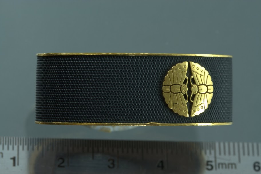

I've got some images of fine nanako work here. They can be seen in greatly enlarged images too by clicking the enlarge button top right. These are the fittings from a classic kamishimo daisho koshirae I used to own.
Adam, The f / k set you illustrate sets my heart racing. The utter precision of the nanako and the brilliant way the artist has only implied the two kamon on the fuchi is fantastic. I marvel at fact that he has been able to execute the minute mitsutomoe kamon on the fan in gold. I would guess he cut out or punched in the depressions and then filled them with gold amalgam. What a tour de force! When I see work like this I am humbled and realise how ham-fisted I am. :bowdown: :bowdown: :bowdown:
