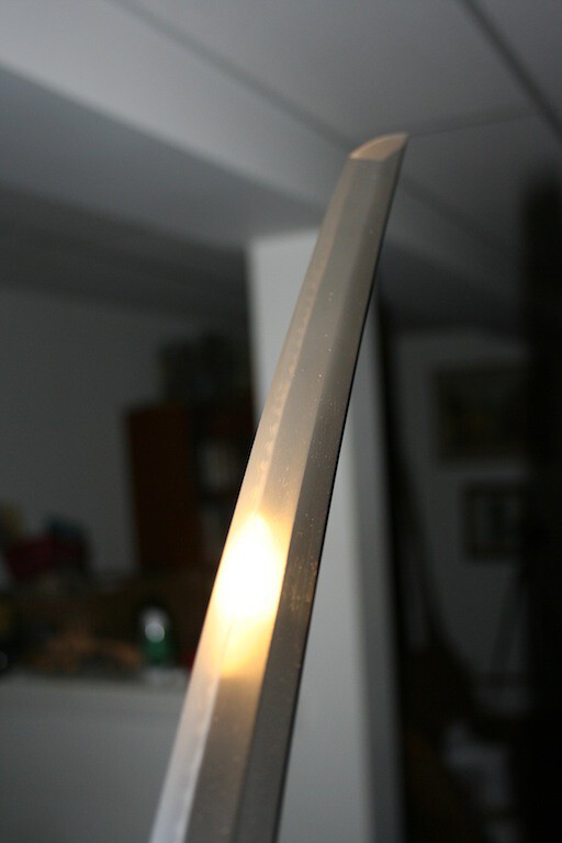

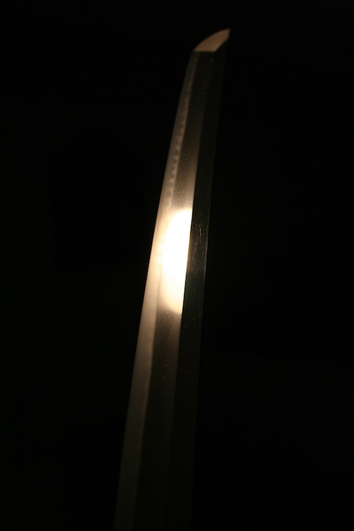

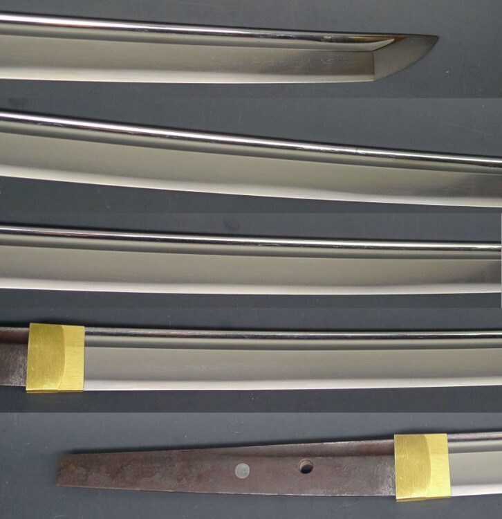

I was trying to get pictures of a ko-gunome hamon and ended up with some better pictures of Shikkake hada. Here are some pictures of Shikkake hada I thought I would share. Masame transitioning to mokume in the ji. If you look closely at the kissaki you can see hakikake and old man's beard.
Matt

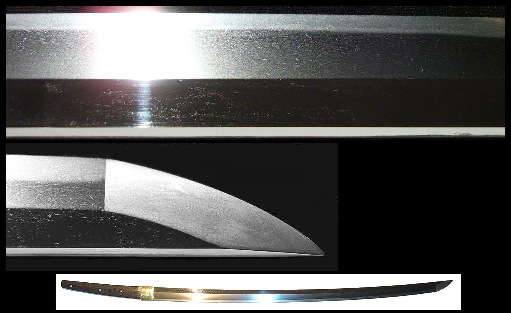

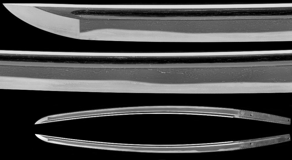

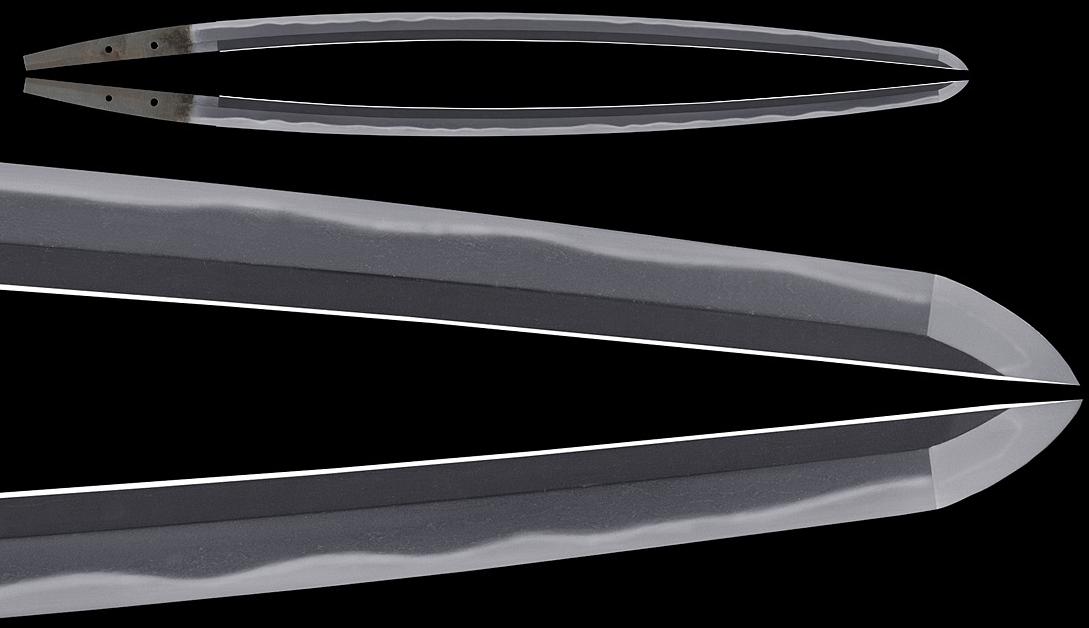

Attached below some additional Shikkake images which show Shikkake hada and boshi on a naginata Naoshi
This blade is attributed to early Shikkake
very good picture Matt :) To get clear picture of the kissaki boshi, you just have to change slightly the orinetation of your camera so it is really parallel to the kissaki and adjust the light accodingly.
It is very difficult to light correctly both kissaki and hiraji before kissaki.
Now, the main difference between both swords is the forge of the masame. (In 80/90% of existing Yamato blades, there are ware (all schools included). the crudest IMO, is Senjuin where the hada is very rough, except some blades from the Ryumon Nobuyoshi school. Shikkake can have very fine hada. I saw a splendid one in the flea market 2 months ago, unfortunately it had a 6mm umegane covering both hamon and hada. The Tegai school has also from time to time fine examples. But a lot of Yamato Juyo blades have often ware due to masame.)
Paul's naginata naoshi is juyo token, hada is so tight that you can easily miss the nagare.
2 days ago, I had an old veteran collector at home who went to see the Yamato blade I have posted a few weeks ago. The light was not the best due to the weather. I told him to point directly the sword to a lamp and start looking the hada from habaki to kissaki, as if aiming with a rifle. He told me he had missed half of the masame because of the layers being so tightly forge. facing the blade it looked like itame.

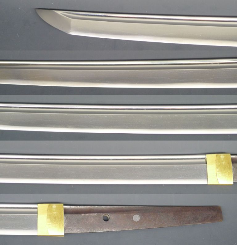

Adam,
Thanks for these high rez pictures. They are fascinating
They are all different, as well in hamon as in hada, (have a look at the boshi)
Who would have kanteied these 3 swords to Shikkake?
Concerning Masame, curiously, Nihon to Koza for Yamato blades states for the hada,: "hint (or "taste") of Masame", what is extent of the word "Hint", does it range from 1% to 30%? It is said the width of the shinogi ji is wide; compared to what, same period other schools? When one can say that a shinogiji is wide?
Do you notice on Adam's pictures if the shinogiji is really large?
In Shikkake, ko mokume according to Nagayama Kokan is bordering the shinogi and masame runs along the hamon as in Matt pictures. Look at Adam's middle picture (TH Kamakura), the ko mokume is easily seen along the hamon...

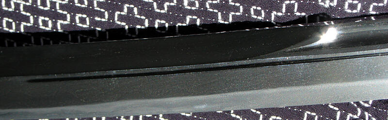

Here are some pictures of my mumei kamakura ko-Senjuin. It's ubu, just a few cm machiokuri. Nagasa +/- 80 cm.
Greetings,
Micha Baudenelle
Micha,
Thanks for sharing. I enjoyed these pics, especially as yours is ubu. I've seen one other Ko-Senjuin piece - a mumei, o-suriage katana. It had Tokubetsu Hozon papers to Ko-Senjuin. It also had hada much like yours.

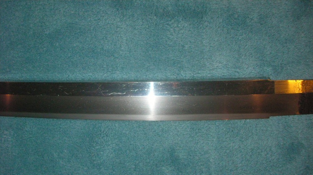

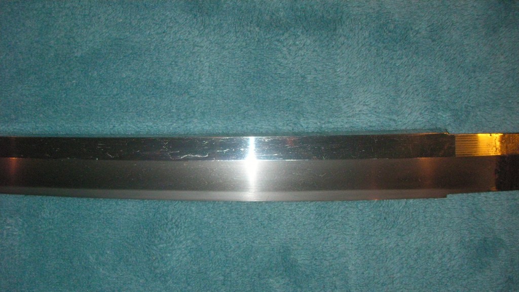

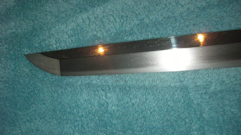

I was browsing through some of the old topics as I am new to the forum. Enjoying some of the discussion. I came across yours and thought you may the photos I posted might give you a good idea of Shikkake gunome. I collect primarily Yamato. When I saw it come up for sale I grabbed it immediately. It is a tachi with a length of 76.4 cm. It was made in the late Kamakura to early Nambokucho period. The blade had Tokubetsu Hozon papers. I sent it to Tanobe Michihiro sensei to have the saya done. He states in his attribution that both the jigane and the hamon are both special features of Shikkake Norinaga. The blade is nice and typical Norinaga. I write this to give you an example of Norinaga hamon. I do not have a macro lens as of yet so it is difficult to show you the detail of the jigane. I will post it for you as soon as I do. Hope it is of value to you.
Tony Martin
Tony - thanks for sharing. Please post more pics - show us the sugata, hada, and hamon if you can.
