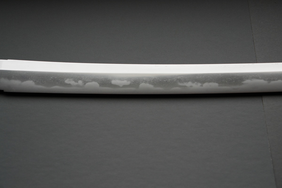

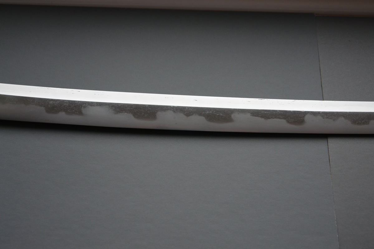

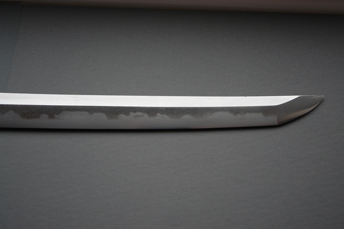

Dr Fox Posted April 29, 2012 Report Posted April 29, 2012 Hi all. This is a sword I have, and it is pleasing in every way, in 1972 it was submitted to the NBTHK for Kanteisho and was issued a Tobubetsu Kicho. The sword is attributed to Kanetane in the province of Echizen circa 1600. Blade length is 69.7cms. Can you tell me what style or name is given to this hamon on the blade. It always appears to me to be a panoramic view of a cloudy sky. In another post I will show the tsuba, that came with the sword. Thanks Denis. Quote

kusunokimasahige Posted April 29, 2012 Report Posted April 29, 2012 濤瀾刃 Toranba-Midare style KM Quote
Dr Fox Posted April 29, 2012 Author Report Posted April 29, 2012 Nice one KM From your help, I find I was looking up at the sky, when I should have been= toranba Submitted by kazarena on Mon, 2007-04-09 15:19 Hamon Types Japanese term 濤瀾刃 Definition A hamon pattern resembling large, surging waves of the sea. Toran-midare - irregular toranba. Thank you Denis. Quote
cabowen Posted April 29, 2012 Report Posted April 29, 2012 Not doran-ba... Hard to see clearly, but more of a notare ni gunome-midare-ba, gunome-ashi iri. Doran-ba is rounded, this seems more angular. This is almost a hako-midare.... Doran-ba: Quote
Mark Green Posted April 29, 2012 Report Posted April 29, 2012 Hi Denis, I have a Echizn Nobusada, of about the same era with a very simular hamon. No one has been able to put a name on mine either. I think Chris has it about right. Kind of a mimi-gata Gumome-midare?? Mark G Quote
Dr Fox Posted April 30, 2012 Author Report Posted April 30, 2012 Hi Mark Yes there is a similarity there, again an Echizen blade, what I could not find any reference to, is the way the hamon separates, and to then give the appearance of breakaway clouds. Thus picking up Roberts opinion, as did I. Is this a particular style confined to Echizen? Denis. Quote
