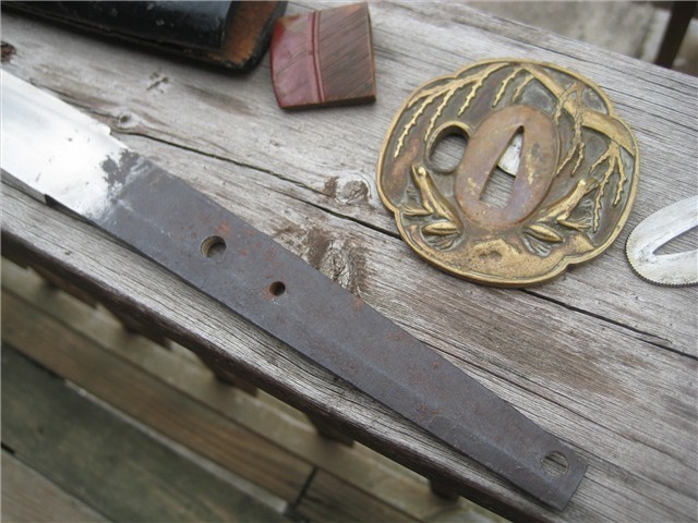

Jiro49 Posted April 26, 2012 Report Posted April 26, 2012 Just wanted to get ideas on the age and school... Thank you!! Regards, Quote
Jorgensen Posted April 27, 2012 Report Posted April 27, 2012 Hi Matt, Is it possible to post a picture of entire blade (with nakago)? It will make some judgement easier. -Jimi Quote
Wickstrom Posted April 28, 2012 Report Posted April 28, 2012 Nakago looks like late Muromachi to early shinto IMHO. What is the curvature of the blade? Also you should post a photo of the whole sugata. Quote
Jean Posted April 28, 2012 Report Posted April 28, 2012 Andrew, I would rather say that the nakago looks like O suriage Quote
Jiro49 Posted April 28, 2012 Author Report Posted April 28, 2012 Sometime this weekend ill get a pic of the sugata... Thanks Jean, I was trying to figure out what school uses suriage nakago Quote
Wickstrom Posted April 28, 2012 Report Posted April 28, 2012 Ahh, listen to Jean. His judgement far outweighs mine on swords. Thanks Jean, I was trying to figure out what school uses suriage nakago A suriage is just a term meaning shortened nakago. It was usually done by the owner long after he had possessed the blade, not by the smith. Quote
Jean Posted April 28, 2012 Report Posted April 28, 2012 Andrew, I'd rather say suriage by a smith (generally not the one who forged the sword), I don't see (in general) a samuraï "suriageing" a sword :D and not necessarily a long time after getting it (I don't say after the sword was forged) :D Quote

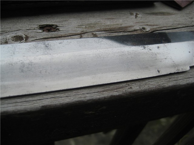

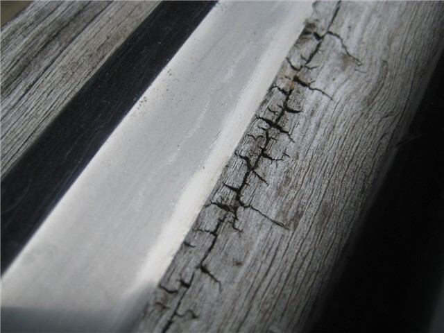

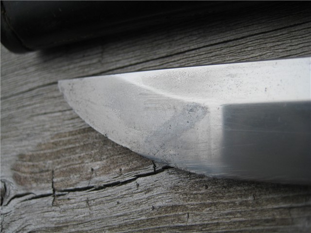

John A Stuart Posted April 28, 2012 Report Posted April 28, 2012 Hi Matt, There are differing opinions on whether one can even ID a blade from pics and this is kantei from hi-rez pics of good swords in polish. I feel you can at least get a feel of the school and era and some have ID'd the smith. Very good pics and very good eyes in those cases. The pics of your sword are hard to make out the characteristics that differentiate one sword from another. Polish too is old and worn. I wouldn't count on a good result. For instance there is no way to attribute or date a nakago that has been removed, it just isn't there. John Quote
Jean Posted April 28, 2012 Report Posted April 28, 2012 Nie deki, hakkikake boshi, otherwise the kitae is not visible which is an handicap, as was saying John, very difficult to kantei a sword on pictures, unless ubu and signed or showing all the characteristics of a smith/school. Quote

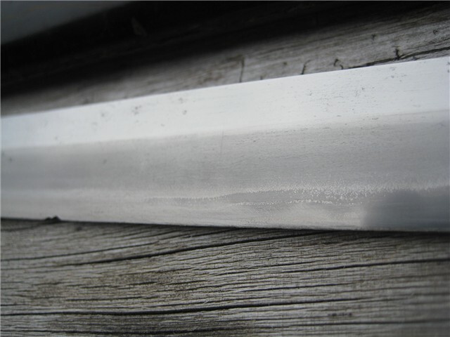

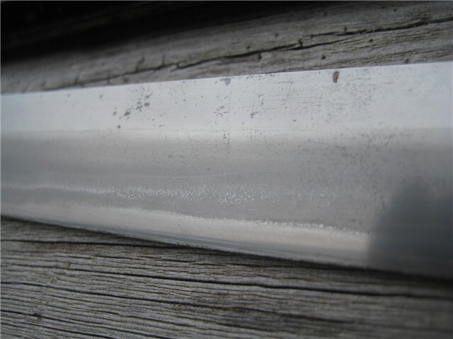

cabowen Posted April 28, 2012 Report Posted April 28, 2012 Am I the only one who sees masame hada? I would start looking into later Yamato work..... Quote
Jean Posted April 28, 2012 Report Posted April 28, 2012 In fact, Chris, I was thinking of sue Tegai, but the shinogi is not large Though it seems high (from the pictures). Quote
paulb Posted April 28, 2012 Report Posted April 28, 2012 Jean and Chris, I think I can understand your thinking regarding Yamato. the thing which is confusing me at present is the long lines of what might be regarded as Ara nie sitting bang between the hamon and shinogi. I am not sure if they appear to standout that much because the rest of the polish is poor or they really are that bright and clear. Either way they look unusual and unlike any Yamato pieces I have seen (the nie is too course) Also I can understands Jeans point about being O-suriage assuming the bottom hole was the original but isnt it also possible that the middle, smaller hole was the original and the lowe one added at the same time as the top (it is the same size) as an added fixing? Quote
cabowen Posted April 28, 2012 Report Posted April 28, 2012 Often times the nie will follow the masame in this way but it is indeed over the top on this blade and shows, in my opinion, second class workmanship. That is why I pointed to later Yamato...Hard to say from the photos if it is in fact o-suriage, or much else for that matter. That is why I suggested to the OP to start with Yamato. Assuming he has the blade at hand, he can check it out himself and see if it fits in ways that we can not.... Quote
