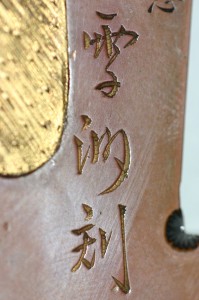

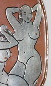

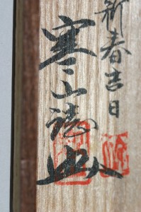

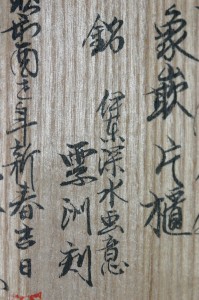

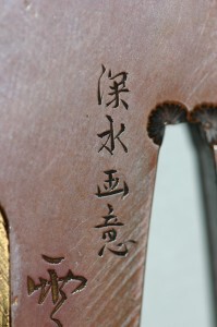

Bazza Posted May 8, 2012 Report Posted May 8, 2012 All, sorry for the delay – I’ve had house guests for a few days attending an antique arms auction in this part of the world, and I’ve had an attack or two of ‘empty bottle’ along the way… The tsuba presented here was offered for private auction sale on ebay in June 2005 by someone in Onomichi city, Hiroshima prefecture, Japan. First I’ll present the text of the sales pitch, then selected pictures, then finally the exchanges that ensued on the discussion list . 1. The sales pitch with original spelling: -------------------------------------------- This is Tsuba. There is a signature. A signature is ITOU SHINSUI GAI SESSYUKOUKU. With a paulownia box what KANZAN juged this Tsuba. A time is not known in detail, but I think this Tsuba's ages seems 100 years ago. It is constructed of gold inlay and silver inlay to copper. This Tsuba made of cooperation of ITOU SHINSUI of famous painter at the Meiji Era. I think this Tsuba's condition is good. Since all portions and photographs are taken, please have a look slowly. Since it is an old thing, please see goods well and offer a bid. Size: Length about 3.5"(9.0cm) Width about 3.3"(8.5cm) with a box Weight about 370g -------------------------------------------- 2. First six of the selected pictures - continued in the next post. These were very low resolution images originally, unfortunately, but sufficient to show “what is what”. Quote
Bazza Posted May 8, 2012 Report Posted May 8, 2012 And a few more pictures continued from the above, with the discussion list comments in the next post: Quote
Bazza Posted May 8, 2012 Report Posted May 8, 2012 3. Now for some exchanges about the tsuba on the discussion list from June 2005. I have presented only the most illuminating contributions: -------------------------------------------- COMMENT #1 No swordsman would wear this on his sword, not to a sword fight anyway. This is something you tuck in your pocket for a “buddies” meeting. The work is similar in style to other images with the theme of women bathing or women pearl divers. Ito Shinzui was a Nihonga painter famous for his Bijinga (Beautiful women) series. If I understand the description then this might be the work of someone related to a Meiji tsubako who signed Setsukoku. The outside of the box says "Sumida-gawa no zu" or image of the Sumida river... -------------------------------------------- COMMENT #2 Ito Shinsui (1898-1972) is a well known shin-hanga (modern woodblock print) artist. Artelino gives the following short biography: Shinsui Ito learned the art of printmaking at a printing company in Tokyo from the early age of twelve. Later he studied under Kiyokata Kaburagi. He was approached by the publisher Watanabe through the mediation of his teacher Kiyokata Kaburagi and made the first bijin print in 1916. It was the beginning of a life-long cooperation between Watanabe and Shinsui Ito. The artist became one of the most appreciated Shin Hanga printmakers for bijin (beautiful women) and landscapes subjects. After World War II his contribution to the development of Japanese culture was honoured by declaring him an intangible national property and by other awards. As the seller suggests, this tsuba was probably made by someone in collaboration with Shinsui, and not by Ito Shinsui himself. It is undoubtedly a modern (i.e. 20th century) piece (i.e. not only not Edo period, but not Meiji period either), possibly done by someone undertaking formal training in the fine arts as a course or term project. -------------------------------------------- COMMENT #3 This tsuba has got to be post-WWII vintage, made for the benefit of occupying red haired orangutans, but, hey, money spends. It looks like decent metalwork, though almost entirely devoid of art. Exactly what a starving post-WWII metalworker would make for a GI with lotsa bucks (yen) to spend, a Japanese metalworker without much comprehension of the historic western aesthetic appreciation of the female form. Kinda like the early Western drawings of rhinoceros made on verbal description. Essentially, it is the tsuba equivalent of the bigtits chrome female form often seen on the rear mud flaps of big rig trucks. It is regrettable that in order to eat, real craft gets dragged down to such low levels of "art". Sigh. -------------------------------------------- The final scene in this tale is the following notice on ebay: Current bid: US $1,125.00 (Reserve not met) Ended: Jun-21-05 21:00:00 PDT Start time: Jun-14-05 21:00:00 PDT History: 32 bids (US $100.00 starting bid) High bidder: User ID kept private Item location: onomichi hirosihima, Japan --------------------------------------------------- I hope this has been of interest to the Listeros. I'll work up the kozuka I mentioned and post it later, allowing some time for any discussion about the above tsuba. Best regards, BaZZa. (aka Barry Thomas) Quote

Brian Posted May 8, 2012 Report Posted May 8, 2012 Bazza, It's amazing...I still have the old NMB archived for info. Wow....look at that color scheme Here is some more very interesting info and closer pics of that tsuba. http://www.nihontomessageboard.com/niho ... php?p=9101 That bridge and those fireworks...can't be too antique. Brian Quote
Ford Hallam Posted May 9, 2012 Report Posted May 9, 2012 Brian, the age of the work is quite definitely defined by the life time of the artist who's painting is depicted. As I wrote on the earlier thread; " The apparent "collaboration" with Ito Shinsui would appear to be based on copying one of his paintings. Ito Shinsui was renowned for his :bijinga", paintings of beauties, including partially clad, or nude ones. He lived from 1898 until 1972" I think it reasonable to assume the tsuba could only have been made post 1925...ish. probably much later. Quote
