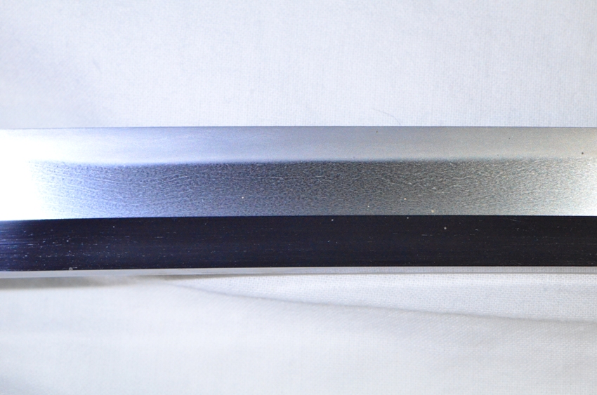

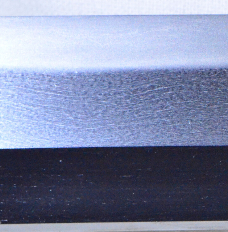

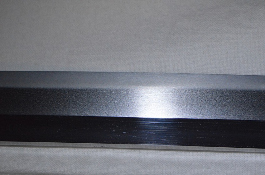

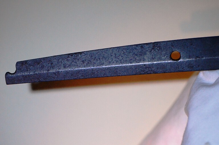

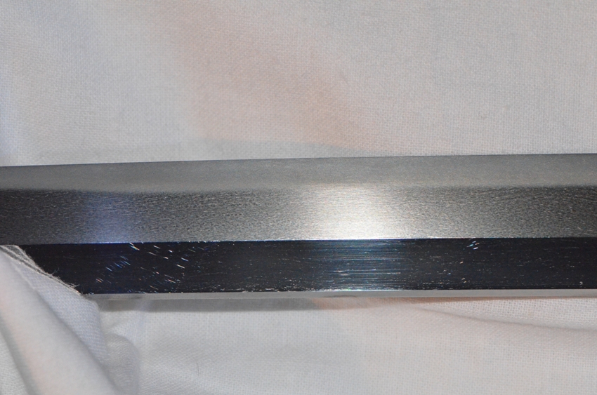

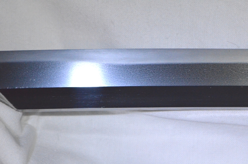

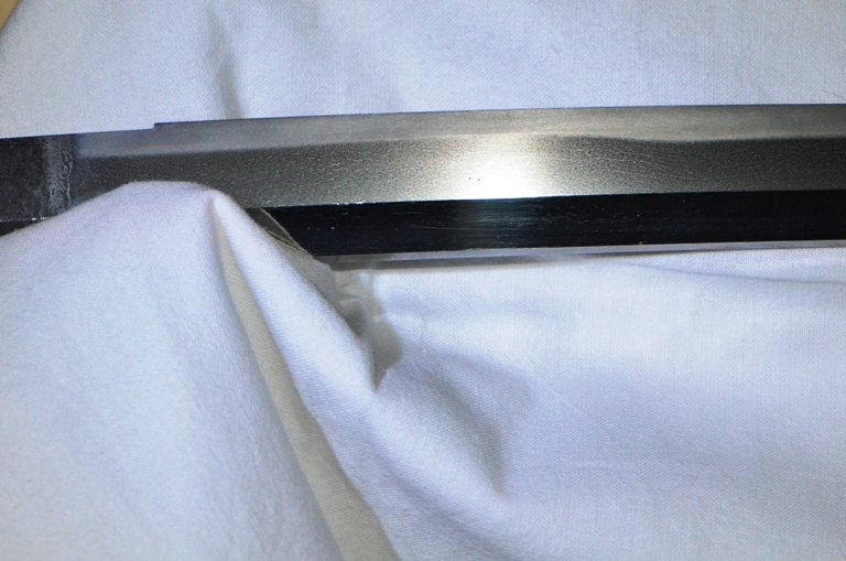

Jean Posted April 19, 2012 Report Posted April 19, 2012 Nagasa, around 66,5 CM Sori: around 0,8 cm Distance between mekugi ana (the bottom one being included in the nakago Jiri: 15 cm. Pictures Quote
Jean Posted April 19, 2012 Author Report Posted April 19, 2012 To spare the bandwith they are not cropped enough to appear directly. -------------------------------------------------------------------- The blade has Two sayagaki, one by Honma Junji (Kunzan), the other by Tanobe san. I have submitted, by curiosity, the blade to shinsa which came back with the same kuni but a different school and a smith name. Ted and Darcy tend to agree with the sayagaki. The hada is very tight so do not appear lamination as happened often. The Kissaki is typical of the school (sayagaki wise) and the blade is covered with ji nie. Whatever the kantei,the quality is outstanding. Quote

Tokaido Posted April 19, 2012 Report Posted April 19, 2012 Congratulation Jean, now THATS a sword!. Obviously from the Yamato Province, as easily seen by the very wide shinogi-ji and the highness of the shinogi, too, which stand out even with the pictures showing the blade only as a flat view... Lots of running hada along the edge and an "old mens beard" boshi. Together with the slightly elongated kissaki, I guess it als Shikkake Greetings Andreas PS: easy understandable, why Yamato is so much sought after by seasoned collectors, isn't it Quote
paulb Posted April 19, 2012 Report Posted April 19, 2012 Hi Andreas, Funnily enough I looked at the "old mans beard" and thought something similar. However if it were what you are suggesting I would expect the masame to be more obvious nearer and into the hamon which I cant see in this piece. Quote

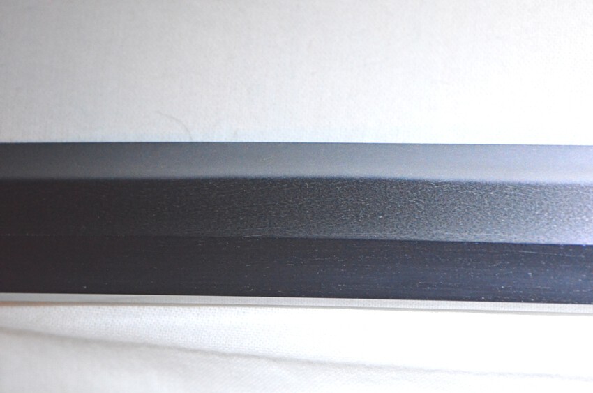

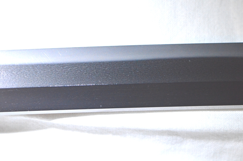

Jean Posted April 19, 2012 Author Report Posted April 19, 2012 Hi Andreas and Paul, In fact, the pictures are not as good as they should, I am not Darcy Paul was right, the masame is going into the habuchi, in some place, and comes back into the hada; like a wave. I am unable to take pictures of the overall blade as Darcy's or you would have seen that : The shinogi ji is perfectly masame, the masame is all over the hada, at 80%, one must be very careful while looking at the hada or you can be very quickly lost and only see the trees which hide the forest. The masame is not a straight one as one can see on Kanenaga blade but a running one. Unfortunately, I could not provide an overall picture of the blade and above all a picture of the blade taken from the nakago to the tip of the kissaki, at a slight angle. No, it is not Shikake, Andreas. It is very rare to find such a blade in such condition dating from late Kamakura. I got it from Bob Hughes at last DTI. It was in the list of swords for sale. It was labeled as Yamato. Bob told me it was the "Deal" of the year. Unpapered with just 2 sayagakis, not mentioned in the list. I saw it and thought it was very, very good. It took me the morning to find how to finance it and I went for it. Often, Yamato blades are crude, they are warrior monks weapon, simple and efficient compared to Yamashiro blades. This one has a jigane which can level with some Rai blades. Masame is equally encountered in Yamashiro blades, Rai Kunitoshi for example. Quote

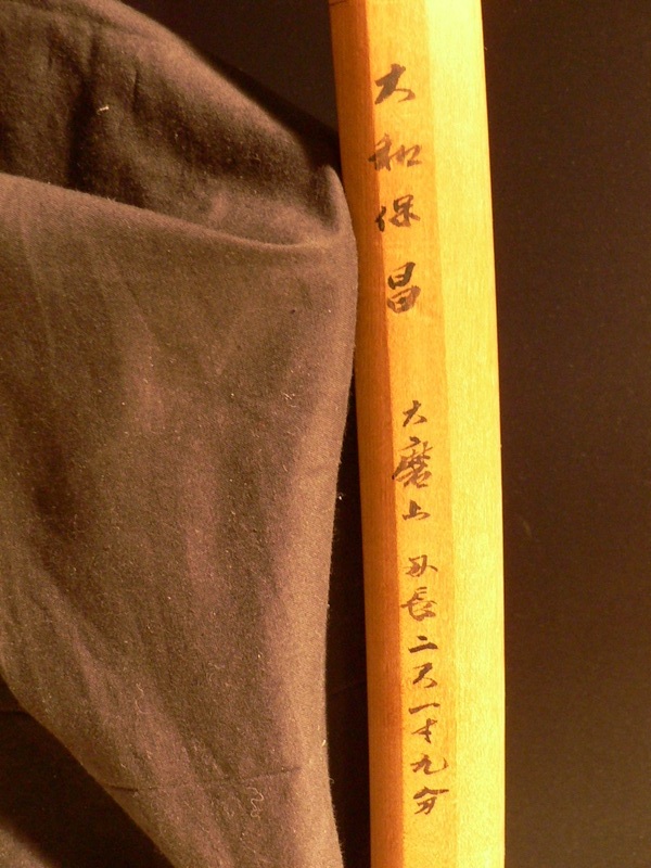

Jean Posted April 20, 2012 Author Report Posted April 20, 2012 Thanks a lot, for your interest I am going to give you the answer: Concerning the Kantei, as I said 2 are available, Sayagaki and NBTHK. Taking into account that the blade was submitted to Shinsa with the sayagaki and knowing the relationship quite tense, I let you choose: Tanobe sayagaki translation was done by Moriyama sama courtesy : 大和國保昌 (Yamato no kuni Hosho) 大磨上無銘時代鎌倉末期頃 (Osuriage mumei, Jidai Kamakura makki goro) - Osuriage and mumei, Period: around late Kamakura era 地刃ニ同派ノ見所ヲ明示スル優品也 (Jiha ni doha no midokoro o meiji suru yuhin nari) - This is a masterpiece whose Jiha explicitly shows the characteristics of its school 刃長貳尺壹寸九分有之 (Hacho ni-shaku i-ssun ku-bu kore ari) - Blade length is 2-shaku 1-sun 9-bu. X 秊辛卯水無月探山邊道先師薫山先生ニ追記了 (? ? Kanoto-U Minazuki Tanzan Hendo(reading?) senshi Kunzan sensei ni tsuiki (ryo)) - In June 2011, Tanzan Hendo(reading?) added a postscript to the late teacher Kunzan-sensei. Sayagaki by Kunzan is easier to decipher as generally he does not make comments, basically Kantei/Hacho (Nagasa)/mei The Kantei of NBTHK is Tegai Kanekiyo Congratulation to Morita sama who follows the sayagaki in its kantei and to Adrian who scores a Dozen according to NBTHK kantei. Only thing to add: As explained, Darcy and Ted who have handled Hosho blades and study thoroughly this one agree to the sayagaki. NBTHK explained its Kantei to Bob Hughes by the lack of Masame ?...... Whatever the answer, it is an excellent blade In conclusion, never pass by Yamato unpapered sword .... :D Quote

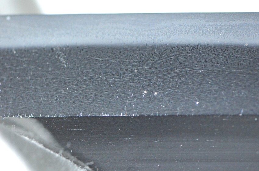

Jean Posted April 21, 2012 Author Report Posted April 21, 2012 Some people having some doubts about this blade having masame and just to wonder NBTHK judgment about lack of Masame, here is a magnified portion of this blade with what late HAN BING SIONG referred to running masame. Quote
