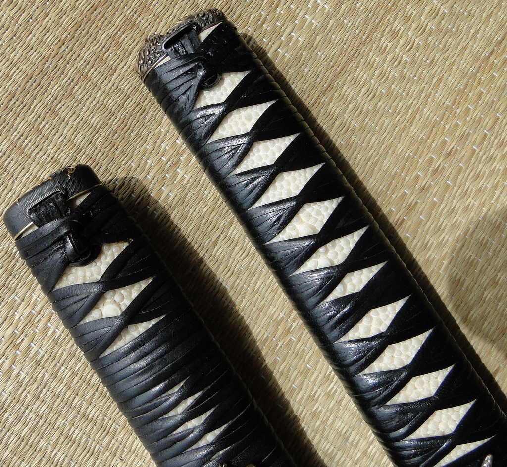

Jimmy R Posted April 2, 2012 Report Posted April 2, 2012 So I made the huge mistake at the Minnesote show of not leaving my tsuka to be re-wrapped by Mr. Buck as I had spent all my money at the time and so later picked an ebay seller with, as he stated "18 years of experience" who offered "museum quality" work. I sent him pictures of the handles and told him to alter them as he saw fit. I sent him $200 and he was very enthusiastic about getting started but insisted I immediately send the other $200. So I did just that. He stated that we would talk about what I wanted when the handles got there. I emailed him what I wanted and gave him specifics about Menuki placement etc. Nothing I asked him or requested was responded to. I sent him a picture of what I wanted and he did not respond. I then after 2 weeks of silence posted a request for his contact info on the board here. THEN he contacted me and made excuses saying he would send me pictures and the handles would be sent monday. Then another 8 days went by with no contact. I have two cousins in Half Moon Bay where I grew up and that is near him so I asked one of them to go get the tsuka. "No problem" my cousin Chad said. So after telling him this he finally sent the tsuka and sent the attached pictures. I am very upset about this. They represent some of the worst Tsukamaki I have ever seen. I asked for a refund of course but he told me to send the Handles back and he "would make it right by altering the cores". What a joke. DO NOT SEND ANYTHING TO THIS GUY!!! He should not be doing any restoration work. I got an email from someone who had a sword polished by him and was also upset. it seems no one wants to put a warning out about this guy. But I am now. Quote

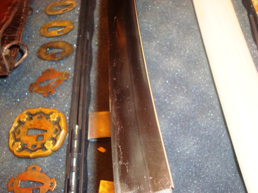

Jiro49 Posted April 23, 2012 Report Posted April 23, 2012 If anyone wants to see what this guy does to blades let me know... He ruined a blade my friend sent him a 28.75" kiyomitsu just destroyed!!!! Matt L. Quote
Jorgensen Posted April 24, 2012 Report Posted April 24, 2012 I am indeed very, very sorry to hear he has destroyed your friends blade. Especially from a good smith. Is it totally destroyed or will it be possible for a professional polisher to save the blade? I would indeed like to see some pictures, if its ok with your friend that you post the pics here. I think your friend should claim full refund for both polish and the blades value! Quote
Jiro49 Posted April 24, 2012 Report Posted April 24, 2012 I bought the blade from my friend since he couldnt even stand to look at it.. Send me a PM with your email and Ill send pics. I think too much meat was removed and anymore polishes will just bring out the shintetsu.... Quote
kusunokimasahige Posted April 24, 2012 Report Posted April 24, 2012 It might be wise to post them here as a warning for the future, and it would be a good thing to show how a blade can get ruined by a bad polisher. If you PM/email me the pictures I can post them here if you like. KM Quote
Jorgensen Posted April 25, 2012 Report Posted April 25, 2012 kusunokimasahige said: It might be wise to post them here as a warning for the future, and it would be a good thing to show how a blade can get ruined by a bad polisher. If you PM/email me the pictures I can post them here if you like. KM I agree... however PM is sent Quote

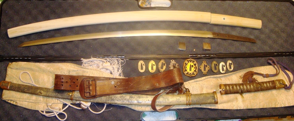

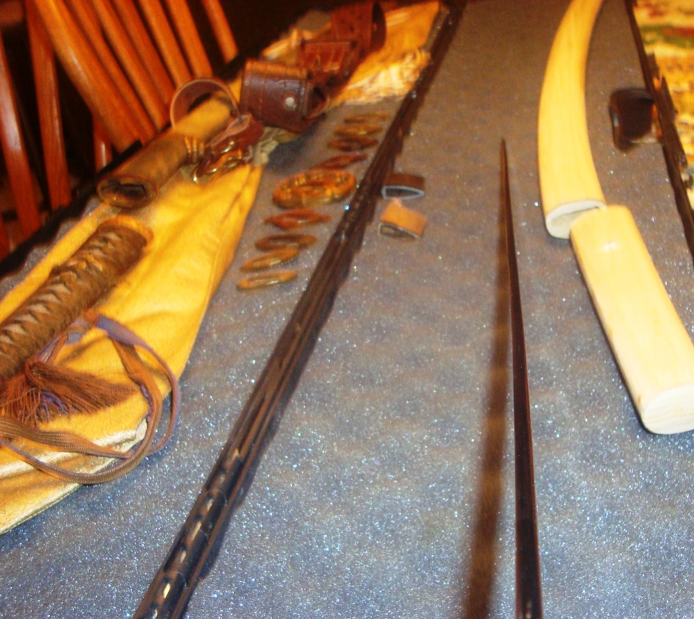

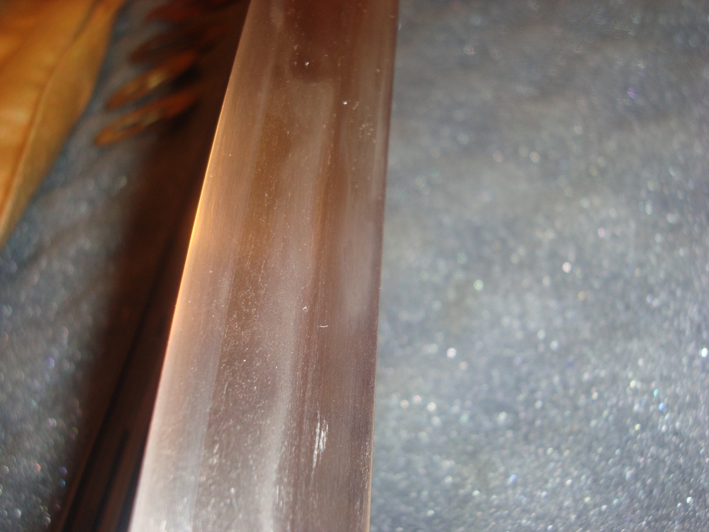

Jiro49 Posted April 26, 2012 Report Posted April 26, 2012 I have no idea what the style of polish is, not sure if its hera-kage utsuri or just hazuya work, same with the muneyaki..? Now this wasnt in great condition but.......Damn! Quote
pcfarrar Posted April 26, 2012 Report Posted April 26, 2012 Matt, is this blade by Nio Kiyomitsu? Quote
Jorgensen Posted April 26, 2012 Report Posted April 26, 2012 I think I can tell you what this is. To me, there are some better polished areas and some grey/tinted areas, along with some scratches etc. It seem to be a mixture of not doing the work on the "big" stones properly and then not doing the job with the fingerstones (especially Jizya). If all mentioned is not done properly, this is the result you get. Or shortly said - nothing he did was done properly. I have some experience with polish myself (with much better result than this!), but I know what it looks like, when you havent done the job well too (dont worry guys, have not destroyed any blades or done polish on valuable blades and will not do) What I cant figure out, is what all the very white "scratches" on the pictures are? Are they really scratches, openings or just the camera that make it worse than it is? -Jimi Quote
