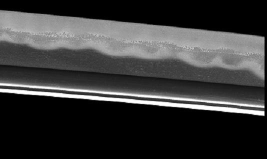

runagmc Posted March 31, 2012 Report Posted March 31, 2012 I was looking at it like all the dots and patches at the demarcation between the steels was patches of martensite, like ara nie. You can see a seperate nioiguchi in parts of the edge steel where ashi are reaching down also, which made me think that it could be nie. If not a difference in carbon content what could explain the difference in brightness of the two steels inside the yakiba... and if not clusters of nie, what could cause all the dotting and patchiness along the demarcation line in this picture? I have a blade that has some big patches of ara nie in the ji and it has a very similar look. Here's an example to show what I mean. My understanding is the yakiba is made up of different size particles of martensite, a lot of times with bigger particles and patches along the nioiguchi. If anyones interested to see some more, http://www.ksky.ne.jp./~sumie99/hamon.html#nie/nioi
