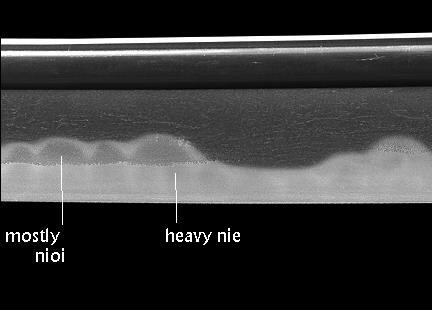

runagmc Posted March 30, 2012 Report Posted March 30, 2012 Lee brought up the So Tsutomu blade... If carbon diffusion took place to that extent, how could you end up with such a different degree of hardening between the edge steel and skin steel. Isn't it the carbon difference that causes the almost pure martensite structure in the edge steel, while the skin steel part of the yakiba has very little martensite. Or I guess you could say the edge steel becomes all nie, while the skin steel in the yakiba is mostly nioi. If the diffusion took place quickly, I wouldn't think the demarcation between the steels would be so distinct.

runagmc Posted March 30, 2012 Report Posted March 30, 2012 cabowen said: How would the forging of steel for tsuba be different that forging steel for swords? How would forging modern steels and iron be different that forging older steels and iron? Formation of martensite depends on cooling rate. The ultimate hardness of the martensite depends on carbon content. True, but the point is, on the blade in question, the cooling rate would be basically the same inside the yakiba, so that would't cause the difference of martensite in the edge and skin steel inside the yakiba. It would have to do with carbon content, or some other difference of composition. Anyway... I'm not trying to start another argument... it was just an observation.
cabowen Posted March 30, 2012 Report Posted March 30, 2012 Not sure what your comment pertains to- the sword shown has a seam along the edge which is the boundary between two different steels. There is martensite on both sides of the seam....???
runagmc Posted March 30, 2012 Report Posted March 30, 2012 The comment pertains to the idea that carbon diffuses rapidly and homogeneously throughout the workpiece. Something's causing much heavier nie in the edge steel here. Since we know it's not due to cooling rate, it seems it would have to be due to composition of the steel itself.
cabowen Posted March 30, 2012 Report Posted March 30, 2012 I don't see any nie within the yakiba where you have labeled "heavy nie". In fact, the only nie I can see is maybe along the seam and in the peaks of the gunome in the far right of the picture....Nie usually occurs along the habuchi, not within the yakiba proper. There is a definite cooling rate gradient from the edge to the mune. The cross sectional area in combination with the clay jacket are the factors which influence this cooling rate....
