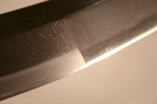

Marius Posted March 22, 2012 Report Posted March 22, 2012 If you have only pictures, it might be a purely optical effect. Look at the attached picture - it seems we have a reverse situation here, but that is just an illusion - in reality the boshi is a continuation of the hamon. Quote
Soten_Fan Posted March 23, 2012 Author Report Posted March 23, 2012 It does have that reverse effect! Well, anyway I am meeting the dealer tomorrow and I will pay particular attention examining the boshi. I will try to view it carefully from all angles to make sure that a hamon is there and it is not just polishing tricks. Speaking of tricks, how is that reverse effect achieved? Does the polisher switch from kensho to sashikomi at the boshi? Also can somebody please answer my other question? If a hamon changes shape after the yokote, does it mean for sure that it is a shinto and not a koto blade? I am asking because the dealer thinks it is a nambokucho blade. Cheers Quote
Marius Posted March 23, 2012 Report Posted March 23, 2012 Dimitri, this effect is due to different angles and the reflection of light from them. As to the re-tempering of a part of a sword, read here (it is called yaki-tsugi): http://www.ksky.ne.jp/~sumie99/flaws.html Determining if the sword is a koto or shinto with boshi as one of the criteria: boshi on koto follows the hamon, ie. if the hamon is irregular, so will be the boshi. In the case of sugu hamon the boshi will have no irregularities (except hakikake etc. in some cases). But this is just one of quite a few rules of the thumb. Do you have Nagayama's book? Quote

Soten_Fan Posted March 25, 2012 Author Report Posted March 25, 2012 Guys, as you said it was all an illusion... There was absolutely nothing wrong with the blade. The hamon continued normally after the yokote as it should be expected. And on top of that, it did not even change shape. It stayed as a subtle elegant suguha. So it was a koto blade after all. A beautiful blade with tight hada, no kizu, and a magnificent o-kissaki (you know how hard they are to come across). It was all dressed in a fabulous koshirae, with an awesome saya of lacquered same. But... But, somebody beat me to it.. This sword was in the shop for less than 3 weeks and 3 people were really interested in it. The lucky buyer hasn't even seen the blade yet! He bought it because of the saya. Apparently it will allow him to create a daisho with a katana he already has. You see, it is not your average same-wrapped saya. It is made entirely of the largest nodules. I started counting the 'king' nudules in the saya, and me and the dealer concluded that more than 70-80 rayfish died to create that one saya :D :D Well, I believe that the lucky buyer will be happy when he finds out that there is a pretty decent blade under this koshirae. I didn't leave empty-handed though. I purchased an echizen school hira-zukuri waki with a wild, almost hitatsura-like hamon, in a pretty decent koshirae. Quote
