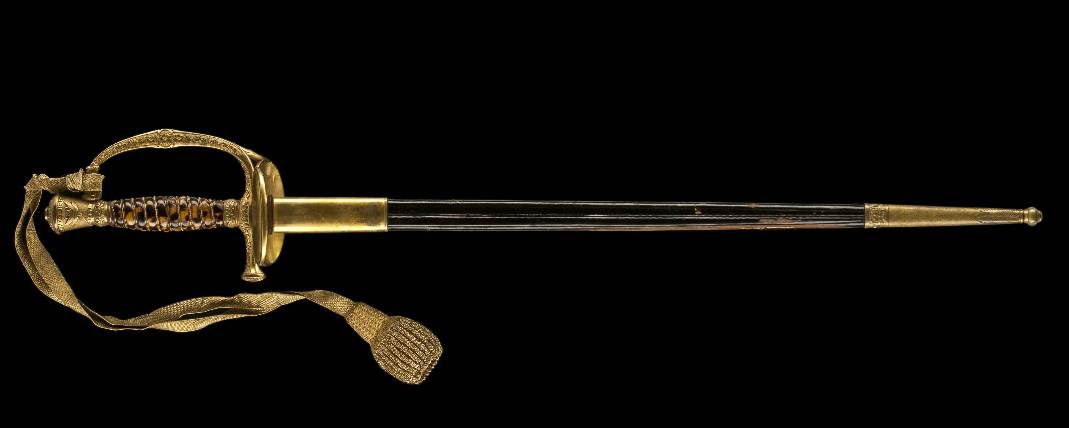

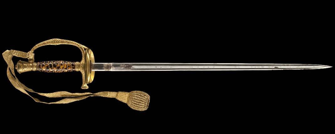

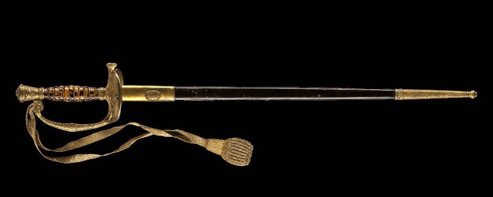

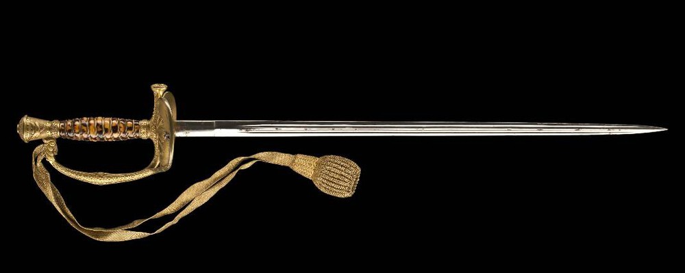

UniqueJapan Posted March 19, 2012 Report Posted March 19, 2012 Hello everyone, I have a very interesting Japanese Parade Sabre that I'd like an expert on if possible. A similar piece is listed in Japanese Military and Civil Swords and Dirks (Fuller/Gregory) in the back of the book in the Unidentified section. It appears to be rare, but I'd like confirmation. I believe it to be Army, from what I understand likely used during WW2. Possibly an adaption of an 19th century Army parade sabre but made during WW2? Does the 1 star represent a 1 star general? It's a beautiful piece, quite elaborate I must say. I'll add as many photos as I can. Feedback may be posted here or sent to me directly at service@uniquejapan.com. As much detail as possible would be most greatly appreciated. Arigato, Pablo Quote

Kai-Gunto Posted March 19, 2012 Report Posted March 19, 2012 Hi Type 19 court style army sword ,1 silver star rank Major general. It was authorized on oct. 11, 1880(meiji 13) and was canceled on nov. 14, 1913(taisho 2). Quote

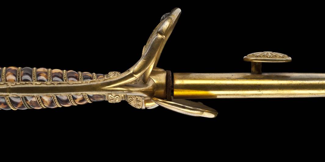

Geraint Posted March 19, 2012 Report Posted March 19, 2012 Hi Pablo and welcome. Thomas beat me to the punch. The sword is exactly described in Fuller and Gregory 1996 in the way that Thomas has told you. The single star and the ends of the sun rays on the emblem on the shell guard are distinguishing features that separate it from the earlier 1875 version. The straight blade marks it as for wear with full dress uniform, a more traditional blade shape was worn for field use. Cheers. Quote

Geraint Posted March 19, 2012 Report Posted March 19, 2012 I should have added that according to Fuller and Gregory any sword of this type "must be classified as rare." Best of luck working out a price. Quote

Kai-Gunto Posted March 19, 2012 Report Posted March 19, 2012 Its very rare IMO,never seen one for sale and with the knot its complete.great condition. 2 stars for lieutenant generals ,3 for generals. The emperor had 6 stars. Quote
