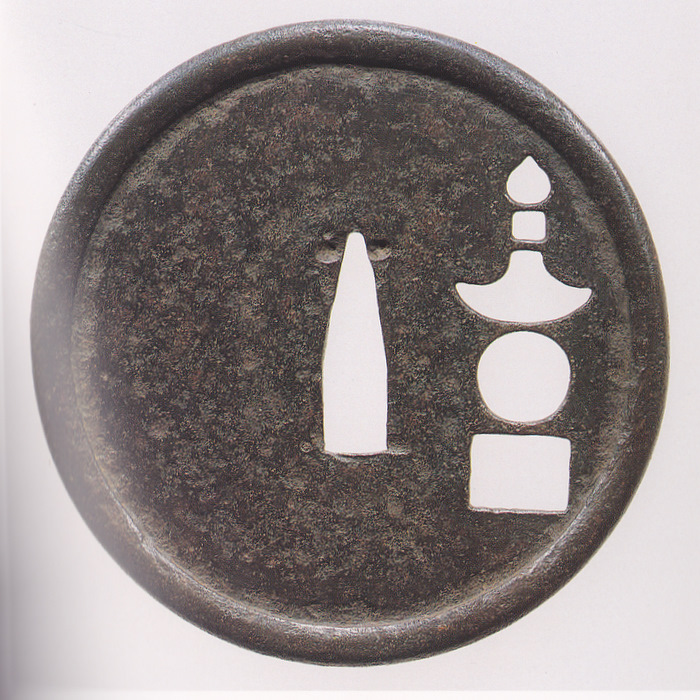

Ford Hallam Posted March 13, 2012 Author Report Posted March 13, 2012 And if there remains any doubt that the Bushi class chose their tsuba primarily on the basis of what they looked like, aesthetic considerations, over purely functional factors consider this famous and venerated Owari masterpiece. It is glaringly obvious that in choosing this type of guard over a Ko-katchushi type a clear preference for the artistry and appearance of tsuba has been demonstrated. Whoever used these guards wasn't concerned about it withstanding a sword cut. By your definition, Chris, this is a bad tsuba. I think that concludes my argument. Tsuba might have served a minor role in practical terms of preventing the hand sliding onto the blade. Any significant protection against a sword cut was clearly not enough of a consideration to direct the design evolution of tsuba in a purely functional way that reflects that concern. Therefore we must regard all development of tsuba beyond the most basic and functional, ie; tosho and katchushi, as being as a result of aesthetic considerations.
