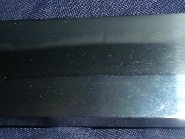

loiner1965 Posted January 4, 2013 Report Posted January 4, 2013 i have a naginata by kiyomitsu but it as a umegame when it was polished . still treasure it even though to some its worthless pics before polish...viewtopic.php?f=15&t=3998 Quote

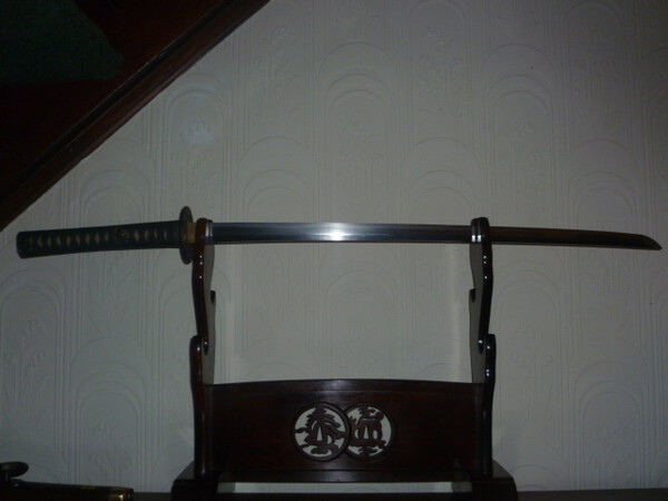

Alex A Posted January 4, 2013 Report Posted January 4, 2013 Hi Steve, if you got it for a steel then its worth every penny. My katana is genroku, mumei suriage, the grain is itame with massame. It came with nthk kanteisho papers. Its only lately ive been looking for information on kaga kiyomitsu smiths. Alex. Quote

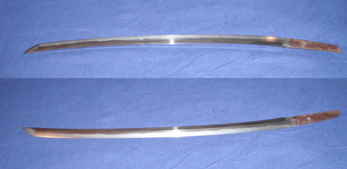

O koumori Posted January 5, 2013 Report Posted January 5, 2013 Clive, Great information! Here's an O- suriage Kaga Kiyomitsu katana from Tenbun (1532-ish), or so sayeth NTHK at 2004 Chicago shinsa. Please pardon my abysmal photography. Nagasa is 62 cm. Found in plain wood saya with disintegrating leather combat cover, no fittings; assume it was carried in WWII. Dan Quote

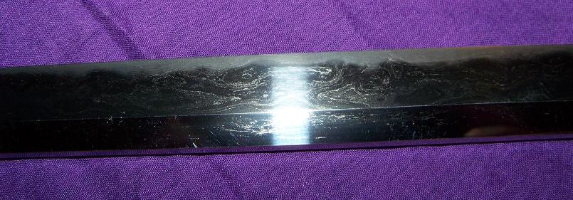

Alex A Posted January 5, 2013 Report Posted January 5, 2013 At that time i can find a number of kiyomitsu smiths listed, in kaga there where 2 generations of kaga, 4th and 5th. There where also kiyomitsu smiths in Bizen, Mino, Suwo and satsuma. Obviously there may be more, but these are the the kiyomitsu i can find listed. Below is a picture of the tang on my suriage kiyomitsu. I was under the impression it was o suriage but not so sure now. Alex. Quote

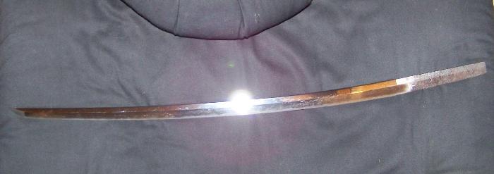

DK-Prof Posted January 13, 2013 Report Posted January 13, 2013 I have a mumei (ubu) long wakizashi that was attributed to Kaga Kiyomitsu and the Tensho period by the NTHK in Tampa 2012. This is supposedly the 6th (and last) generation of the Kaga Kiyomitsu smiths from the Kaga Fujishima-Yukimitsu group. From what I gathered, he and his brother left and moved to Etchu, and he changed his name to Etchu Takaoka Kiyomitsu. Before the NTHK issued their paper, I was actually convinced the blade was made by the Sadahiro who signed “Kaga no Kami Fujiwara Sadahiro” and who appears to have worked in Echizen (Shimosaka) province from Kanbun (1661) to Enpo (1673) periods, and later in Settsu province during the Genroku period (1688). Klaus Quote
Alex A Posted January 13, 2013 Report Posted January 13, 2013 I will post some pictures of my kiyomitsu blade soon, the hamon on mine is choji midare, not as active as yours, but very similar. The grain looks identical. Alex A Quote
DK-Prof Posted January 14, 2013 Report Posted January 14, 2013 blade72 said: I will post some pictures of my kiyomitsu blade soon, the hamon on mine is choji midare, not as active as yours, but very similar. The grain looks identical. Alex A I look forward to seeing it! Klaus Quote

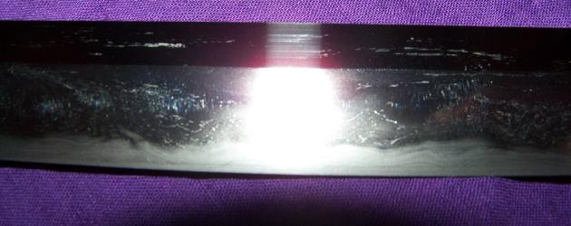

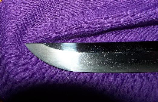

Alex A Posted January 16, 2013 Report Posted January 16, 2013 Hi Klaus, been having a look to see what i can find about kaga kiyomitsu, as your aware your 6th generation tensho kiyomitsu is from a school that dates back to 1444. What i dont know and what im hoping someone will tell me is does this school of kaga kiyomitsu have anything to do with the kiyomitsu school dating from 1673 with 3 generations??. My kiyomitsu katana is dated genroku period, some pics below (excuse the photography). Mike, is it possible to see more pics of your blade, and details of grain and hamon? Alex. Quote

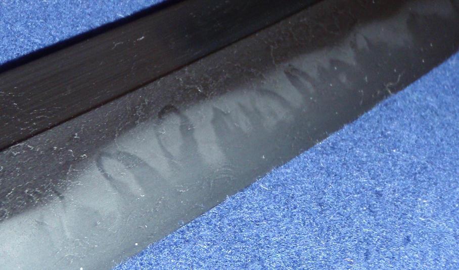

raiden Posted January 16, 2013 Report Posted January 16, 2013 will try to post pics later, but sword may not survive the show. Hamon is a gunome togare like Kanemoto or Darani. Quote
DK-Prof Posted January 17, 2013 Report Posted January 17, 2013 blade72 said: Hi Klaus, been having a look to see what i can find about kaga kiyomitsu, as your aware your 6th generation tensho kiyomitsu is from a school that dates back to 1444. What i dont know and what im hoping someone will tell me is does this school of kaga kiyomitsu have anything to do with the kiyomitsu school dating from 1673 with 3 generations??. My kiyomitsu katana is dated genroku period, some pics below (excuse the photography). Hey Alex. I do not know, but hopefully someone else will be able to chime in! Your blade is beautiful! Quote
