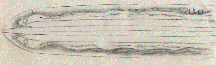

drbvac Posted February 10, 2012 Report Posted February 10, 2012 True enough - same with any bit of history that is questionable - they seem to want to fill it in and need be will make it up !! Very interesting thread but - I did respond in part to the original question by Mr Sinclaire regarding the appearance or seeming appearance in the hamon of dragon chasing a tama:: "In terms of the dragon abstract your interpretation is certainly plausible and of more credibility than mine - in fact a fairly astute observation that once stated tend to keep drawing your eyes. Like someone saying " I can see the water and mountains in that Picasso' as i nod my head and can not see anything." If in fact this was the intention I can't say other than repetition of a theme along the blade that there are many hamon that would be made to look like a specific single entity such as this. Does anyone else find themselves seeing things and trying to figure what it could be or is it once again imagination filling the void of facts. Anyone have any examples where this was done and noted what the figure was>? Quote

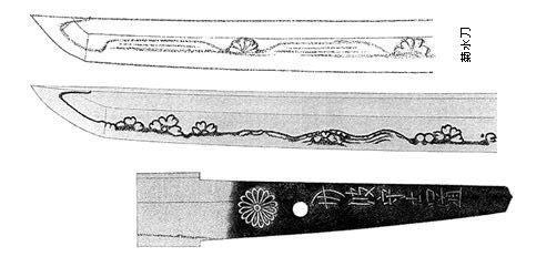

drbvac Posted February 11, 2012 Report Posted February 11, 2012 Adam: They are certainly object incorporated into the hamon but I believe most of them are repeated along the edge - Mt Fuji is the theme is repeated 4 or 5 times is it not. I was referring to something more in line with what Mr. Sinclaire was describing - one "picture" all along the edge. I dont recall but the more I look at the original post picture the more I can see what was described - could be tired eyes or imagination or Scotch. ? Thanks - Quote
sanjuro Posted February 12, 2012 Report Posted February 12, 2012 OK.. I'm seeing a dragon chasing a tama in this blade........ Quite stylised but definitely there as if seen in a cloud.... :D Does this mean I need to cut back on the meds????? Quote
runagmc Posted February 12, 2012 Report Posted February 12, 2012 Dr. Brian, yes most of the time they were repetitive, as you say, but sometimes they where done without repetition. Here are some exaples to compare, I also wanted to post this pic of a sodai Yoshimichi that has a similar feature. I'm not sure abot the dragon idea, but it is worth considering... it seems like I remeber reading that the single tobiyaki in the kissaki symbolized something else but I'm not 100% sure. Anyway here's the pic along with Clive's oshigata (hopefully you don't mind that I cropped it to fit, Clive) Quote
