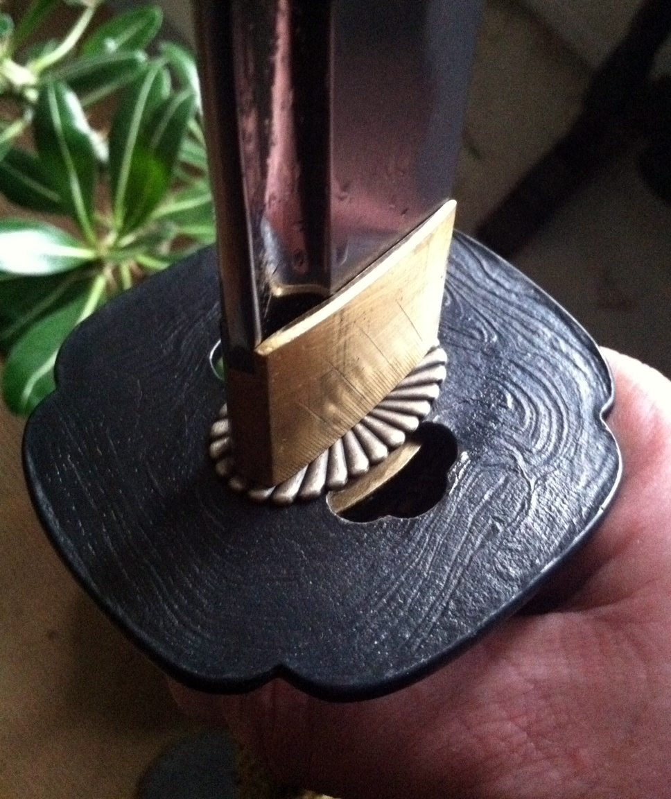

On this subject, can anyone here recommend someone who can do some minor fitting work on a sword which has already had the tsuba replaced but didn't come together quite right? A thinner tsuba was replaced with a thicker one and one of the seppa was shaved just a touch to accommodate it. Unfortunately it was shaved down just a hair too much and there is some annoying movement in the tsuba which I have temporarily fixed by adding two thin cotton patches to make it fit perfect.
I'm not handy doing such things myself and would love to have someone with skill make it right by either replacing one of the seppa or adding a nicely made thin shim. I tried myself using some brass shim stock, but wasn't happy with the result.

I considered leather but I'm concerned that it might react with the metal of the tsuba or nakago over time. I had read about the dental floss fix but it sounds about the same as the cotton patches I'm using right now. The sword itself isn't the best, and the fittings aren't the best, but I would still like to solve this issue using at least a nicely shaped and fitted metal shim that will blend in between the tsuba and one of the seppa.
Not being much of a do-it-yourselfer, it would be great to find someone with the talent who I could pay to do the job right. Any suggestions would be greatly appreciated.
