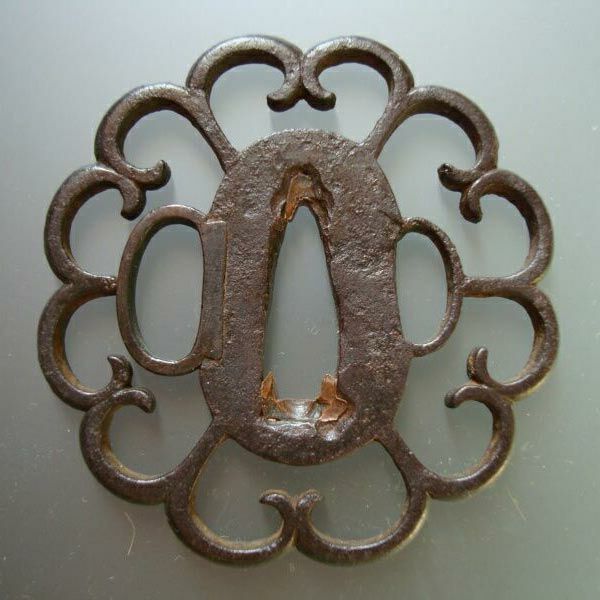

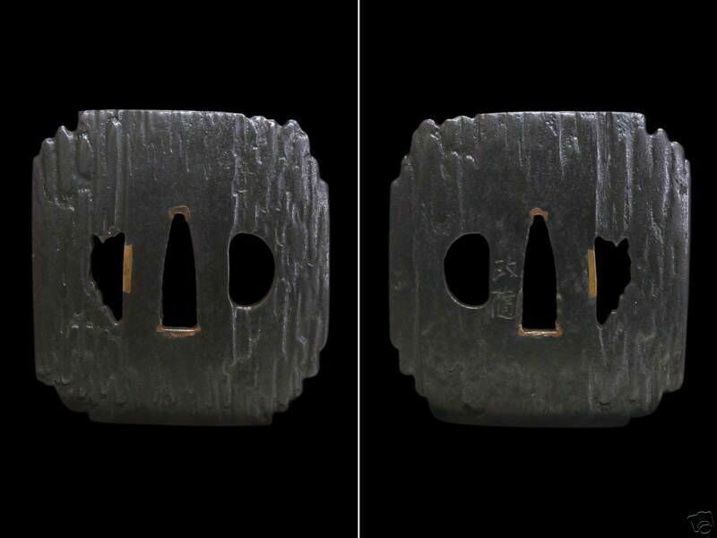

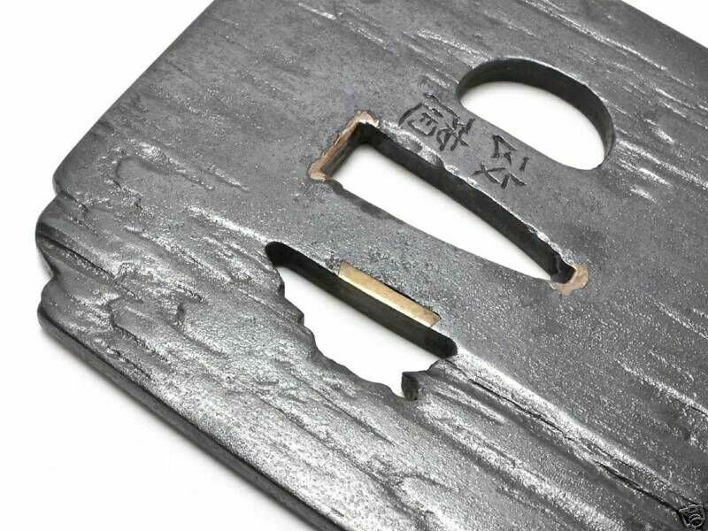

Guido Posted January 22, 2012 Report Posted January 22, 2012 Now it gets interesting. The Ategane of this Tsuba doesn't change the shape of the Seppadai or Hitsu-ana at all, it follows closely what I assume is the original shape: http://taiseido.shop-web.org/cn11/cn35/pg267.html A repair, pimping up the Tsuba, or indeed meant to protect the Kozuka in some way? Quote
sanjuro Posted January 22, 2012 Report Posted January 22, 2012 Yes it does get interesting..... Because this particular Ategane is concave to the seppadai it suggests that it is there to act as a cushion of softer metal on an iron tsuba where it might encounter the kozuka as it was withdrawn or replaced in the saya. I guess this then indicates that Atagane could indeed serve this purpose if only confined to the kozuka ana. One wonders however, if this is indeed its purpose, why the entire kozuka ana was not lined with the softer metal instead of merely this small part of it at the seppa dai. As Guido has pointed out, the kozuka is as likely if not more likely to be damaged by any part of the ana if improperly withdrawn or replaced. I seem to recall seeing a few tsuba that do have complete linings as opposed to atagane, to both kogai and kozuka ana. On the other hand, the pressure of the right thumb pushing the kozuka initially inward and upward would, if the ana were a close fit, be most likely to make the kozuka contact the tsuba at the seppadai. Perhaps this was the thinking behind this particular placement. Quote

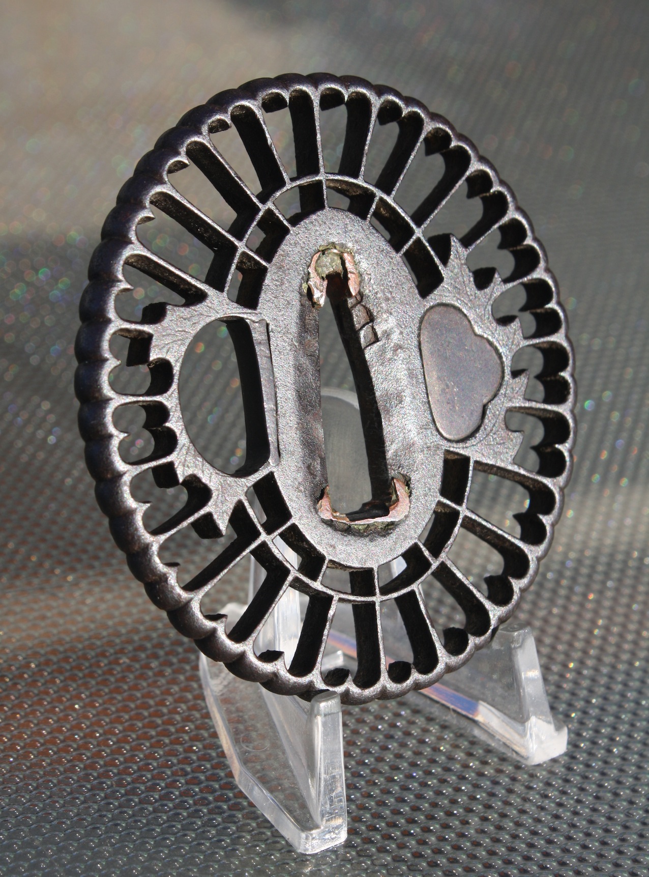

Thierry BERNARD Posted January 22, 2012 Report Posted January 22, 2012 some interresting Ategane ! Quote
Pete Klein Posted January 22, 2012 Report Posted January 22, 2012 Anyone ever think about the possibility that they were there to prevent damage to the kozuka/kogai when the sword was withdrawn or replaced, or perhaps to help prevent them from being pulled out along with the sword? Just a thought, but as there isn't that much of the kodogu past the tsuba, if at all, it probably isns't the issue. Anyway, as the backs of kozuka and kogai are somewhat convex I would suggest that when you see inserts which are concave to flat they were placed to compliment kodogu and when convex and following the arc of the seppadai they were placed to re-shape the tsuba either to a new saya or to correct where kodogu were no longer present. If you go back one page and look at the second picture I posted you will see that there is a circumferential addition to the tsuba, but that the inserts in the areas of the kozuka and kogai have been adapted to their presence. This shows that this was a functional adaptation, in this case not only re-sizing the tsuba to a re-mount of a larger saya but to compliment the kodogu placement also. IMHO. Here is an example of a tsuba modified for a kozuka without an insert. (If you look at the top and bottom of the cut out the walls diverge therefore not allowing retention for an insert). This might be indicative of an original koshirae (?): Quote

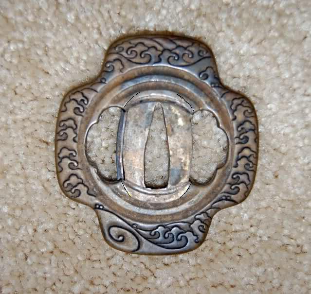

b.hennick Posted January 22, 2012 Report Posted January 22, 2012 Here is a tsuba where the seppa dai has been enlarged but the ana for the kozuka left alone. Quote

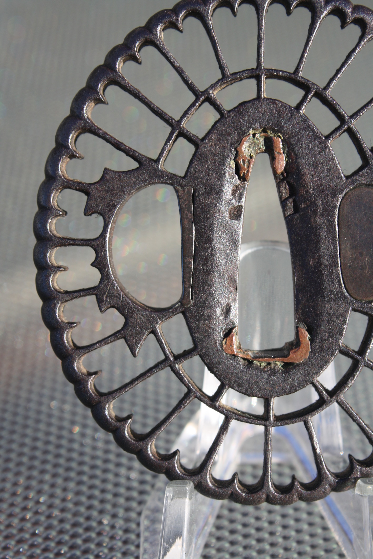

docliss Posted January 23, 2012 Report Posted January 23, 2012 While it is an instinctive reaction to label the ategane on Brian’s tsuba as being intended to protect the soft metal kogai from damage by the iron tsuba, an alternative explanation might be that the seppa-dai was originally indented for the accommodation of a kogai and that, when this was no longer required, this indentation was converted for ategane in order to repair the seppa-dai. A full umegane would have been both impractical and unnecessary in this instance. John L. Quote

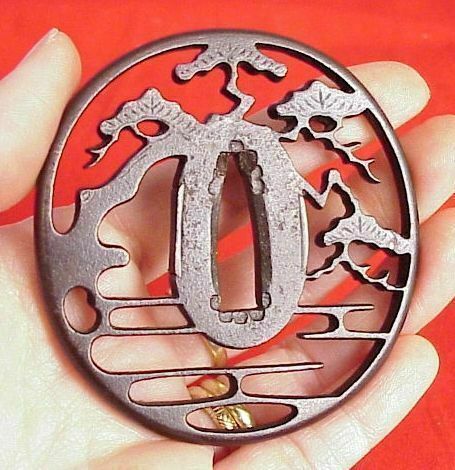

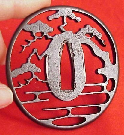

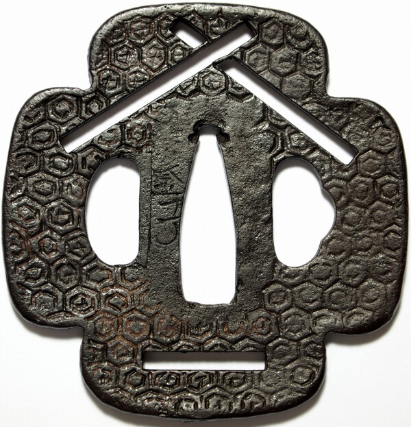

Soshin Posted January 24, 2012 Report Posted January 24, 2012 Hi Everyone, Sorry about coming back to this late. Had some technical problems on my side and I determined I can't upload photos with my iPhone. Here is a tsuba in my collection with a iron ategane (当金) for reference. The insert reshapes the kozuku hitsu-ana. Yours truly, David Stiles Quote
MauroP Posted June 14, 2014 Report Posted June 14, 2014 Hi everybody, I apologize in advance for reopening a long time closed thread, but since NMB is (or should be) an authoritative resource for western tsuba connoisseurs, I think it would be useful to fix definitely some old but still unresolved issues. So, back to basics: A: sekigane (責金). The small bits of soft metal added to the nakago-ana to fit the tsuba to a sword are unanimously defined sekigane by all the books I have consulted (ref.s 1,2,3,4). B: sekigane (責金). Soft metal inserts lining the medial side of kōgai-ana and/or kozuka-ana (whatever they were intended to serve for) are called sekigane in Sasano (ref. 2). The exact meaning of sekigane is unclear in Haynes (ref. 5, p. 256). C: ategane (当金). I think that the plugs that obliterate an hitsu-ana can safely called this way, but I was unable to find any support from my very limited library. D: kuchibeni (口紅). Haynes (ref. 5, p. 251) states that the so called "lipstick" are the copper plugs which may be seen at the top and bottom of the central opening of a tsuba. I suppose it would be safe to call this way the sort of sekigane which were build with the tsuba itself (like most tsuba from Tanaka school, for instance). E: ??? no idea at all. Decorative plugs of ko-sukashi can as well be called ategane/umegane? I have deliberately ignored on-line glossaries (which I suspect are all cross-referenced). Thanks in advance to whom will help me to definitely understand that issues, but please referenced statements, not just personal opinions. Bye, Mauro References: 1. Earle J., Lethal Elegance, MFA Publications, Boston, 2004, p. 36 & 235 2. Sasano M, Early Japanese Sword Guards. Sukashi Tsuba, Robert G. Sawers, London, 1972, p. 278 3. Shibata M., Tsuba Nyūmon, Kōgei Shuppan, Tōkyō, 1967, p. 19 4. Kashima S. et al., Tsuba-no-Bi, Ribun Shuppan, 1969, p. 237 5. Torigoye K. & Haynes R.E., Tsuba. An Aestetic Study, Northern California Japanese Sword Club, 1994 Quote
Ford Hallam Posted June 15, 2014 Report Posted June 15, 2014 David Stiles In my opinion what you've got there is not an example of iron ategane. Rather, this suggests to me the tsuba is a modern cast copy. We've seen these before, where any such inserts that would be expected to be copper or some other non-ferrous or soft metal are of the same material as the actual tsuba itself it points to a reproduction. There are other giveaway clues even in the image you posted that identify it as a casting. Without even considering the reasons for such inserts simply thinking about how they're fitted would make me suspicious of iron ones. Quote
Soshin Posted June 15, 2014 Report Posted June 15, 2014 Hi Ford, I can't examine that lemon because it has long since left my collection. But I do remember that it had a separate interested piece of iron if I remember correctly. Here is another old photo I found of the tsuba on my computer which might be a little bit better. If someone out there on NMB has it please post a better photo. To determine if it is cast or if it has such a insert. Quote

b.hennick Posted June 16, 2014 Report Posted June 16, 2014 Someone went to a lot of trouble to make additions to this tsuba. I believe the work was done so that the tsuba coincided with the newer wider saya. Quote
Barrie B Posted June 16, 2014 Report Posted June 16, 2014 Barry, A great example of what we are talking about. Pete Klein also posted several good examples of the seppa-dai being adjusted to suit the dimensions/ alignment of the new Koshirae - as probably dictated by the (then) new owner at the time. In the KTK article discussed previously, there are only hand drawn examples, so thanks for posting actual Tsuba for all to see. Barrie B. Quote
