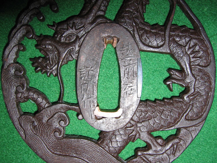

Rog Posted January 18, 2012 Report Posted January 18, 2012 In the top image (#41) there is an insert shown in Kozuka hitsu ana (hole on left side) adjacent to the left side of Nakago hitsu ana (blade hole) - while there is no insert in Kogai hitsu ana (hole on right side). (*my apologies if I've goofed up the terminology) ??? I'm curious as to what that inserted part is and why it was made and inserted. Also, though my research I've come to believe that the face/front of this tsuba is actually the second photo shown. Even though it appears that the top photo shows more wear to the tsuba, seemingly indicating that that was the side facing the Tsuka more times than not. Thanks for any and all info - and I hope this post is clear in content, if not please correct me! Rog Quote
docliss Posted January 19, 2012 Report Posted January 19, 2012 Dear Rog The soft metal insert that you describe in the kozuka hitsu-ana of your tsuba is called sekigane, and is intended to protect the soft metal of the kozuka from damage by the harder metal of the tsuba. It is my impression, from the outline of the other hitsu-ana, that this also originally contained sekigane, which has subsequently become detached and lost. Kind regards, John L. Quote
sanjuro Posted January 19, 2012 Report Posted January 19, 2012 If its OK with you, lets take a small step backward here. In the first place, samurai did not spend a great deal of time with a naked blade in hand. Hence the greater wear does not usually occur on the tsuka face of the tsuba. The greatest area of wear on a tsuba is more likely to be on the saya side of the tsuba where the hand rested constantly. One area that sometimes shows greater wear or discolouration is the sector of the tsuba that would be to the upper left of the centre as it is viewed facing the wearer with the sword in the saya, worn in the obi. This where the thumb of the wearer would rest at all times, ready to push the sword a fraction forward prior to drawing it. The insert you refer to would be to firstly prevent wear on the tsuba itself as the kozuka is resting in situ and would be drawn through the tsuba. Or otherwise to adjust the tsuba to a certain mounting so that the kozuka ana and seppadai aligns correctly with saya on one side and the tsuka on the other. Basically you need to do a little (make that a lot) more reading as to how the sword was worn and mounted to understand this and other small but important details of wear and the use of various sekigane on a tsuba. This is not a simple subject at all and there are many factors to consider not the least of which would be the comparative age of the tsuba, and on what kind of blade it was mounted or may have been mounted. (katana, wakizashi etc.). No criticism here, but this is such an elementary question that it indicates you really should be doing some basic research for your own sake, and this is possibly why you have not received an answer much sooner. :D Quote
Guido Posted January 19, 2012 Report Posted January 19, 2012 docliss said: ..., and is intended to protect the soft metal of the kozuka from damage by the harder metal of the tsuba.That's what I heard often, too, but since we're looking at a soft metal Tsuba, I'm getting my doubts. Proper alignment, as Keith suggests, might be the more plausible answer. BTW, I don't think this is a beginner's question at all, the topic deserves indeed some more serious study. Quote

Rog Posted January 19, 2012 Author Report Posted January 19, 2012 Well now, here comes the reason for my confusion and reason for asking - - - web search definition, and other sources definitions = sekigane: a) the small bits of soft metal added to the nakago ana to fit the tsuba to a sword b) The sekigane was a very popular way in which to adorn the Tsuba. The technique consisted of carving out designs and filling them up with gold color material. Some of the designs were basic shapes. In other cases the adornations took on the form of known figures such as flowers, animals, etc. c) Soft metal plugs inserted in the KOZUKA and KOGAI apertures on iron plate tsuba. Sometimes used instead of the term KUCHIBENI for the plugs at the top and bottom of the NAKAGO ANA. d) Ategane - A metal plug placed inthe Kozuka or Kogai-ana. Also refered to as Ume. So with all this info and similarities/synonymous terminology why would one be confuzzzed.... Anyway - thanks to all for the info! P.S. Keith G. - - - Why would I want to do a lot more reading? I came here and searched you out didn't I..... But yes, a lot more study is in order as time permits. Quote

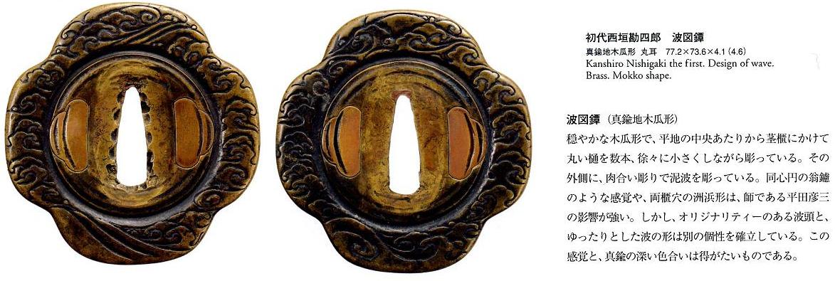

Lorenzo Posted January 20, 2012 Report Posted January 20, 2012 Uh well ok, you was just throwing in a random opinion; I suppose it is your right to do so Just for info; the tsuba on the OP is inspired to Nishigaki Kanshiro: Quote
Curran Posted January 20, 2012 Report Posted January 20, 2012 Lorenzo, Yes, I told him this already via PM. His is either a late Edo copy. Let us say "Kodai Higo", or it is a fake. It has none of the feel of the originals, which a very advanced collector was kind enough to loan me a half dozen of these Kanshiro softmetal ones for a while. I prefer to think it is Kodai Higo, but patina looks jacked up. Correct repair of a kodai Higo would be expensive and perhaps foolish in this case. but it doesn't really go with the koshirae this guy has for it. It looks sort of a frankenstein. Probably a money pit to repair a koshirae that is already not much to look at. If he wants a koshirae for the nice sword it has, he probably should learn the process of having a decent one built. Quote
