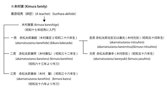

FBJ Posted January 16, 2012 Author Report Posted January 16, 2012 Out of curiosity, and since it was explained to me prior to purchasing the sword that the person (Kanetsugu) that oversees the Akamatsutarou school would be creating the sword with his son's help (artist name 'Mitsuhiro'), does the attached image suggest that Kanemitsu and Mitsuhiro are the same person? Not that it matters to me, since it seems all of Kanetsugu's sons and brothers are very accomplished swordsmiths, but I was curious mainly so that I have accurate information about who they are. Thanks again! Quote
John A Stuart Posted January 16, 2012 Report Posted January 16, 2012 Yes, that is how it looks. Art name and family name. John Quote
FBJ Posted January 16, 2012 Author Report Posted January 16, 2012 Ah, roger. I've been thinking all this time that Mitsuhiro was his artist name. Now I know. Quote
cabowen Posted January 17, 2012 Report Posted January 17, 2012 art name and personal name.... Kanetsugu and Kanemitsu are the smith, or art names. Kimura is the family name. Kanesada and Mitsuhiro are the personal names. Where did you get that family tree? It is full of mistakes in the translation to English.... Quote
