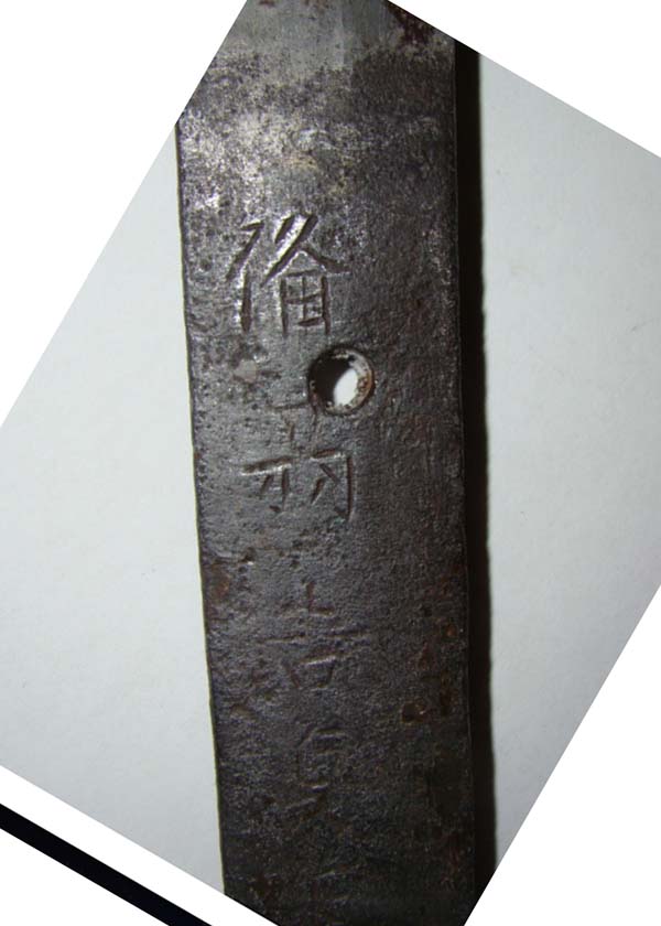

bizen yoshi..??
Cello
Hi, could any one explain to me why the smith name is ura mei?? or is this a a sort of tachi mei? I'm confused with this one. Also i think the first three kanji are bizen yoshi ...... can anyone make out any other characters?Any help greatly appreciated as always
The character below yoshi looks like it could be" Kane 包" different than the one you usually see used by Mino smiths. Below that could be "kore 之 " (made) The beginning of the date the other side looks like "Taiei 大永" (1521) I can't make out the rest. My abilities aren't anywhere as good as others here, so I could be off. Defintely appears to be katana mei not tachi mei from the pictures though.

Most signatures do tend to be either centered or closer to the right/back side of tang. From the pictures of your sword it looks slightly shortened with one hole, when shortening was done they wouldn't just cut off the the end, they would reshape much of the tang as well. That could be why it's closer to the cutting edge side now. Always exeptions but the usual rules should still apply, smith's mei facing outwards edge up carried on the left side is a katana, edge down is a tachi.

Maybe it's the first documented case if so the medical community will pay a fourtune haha!! So if not bizen or bishu could it be Buzen? What exactly is not quite right I'm not seeing it ...what a suprise right :? Also why is the 3rd character not kichi but being read as yoshi?
The first part of the inscription looks 備刕吉 X 作 (Bishu Yoshi+something saku). The first kanji in the mei is an informal variant of 備. The kanji is not so unusual. You may often see the variant on many Bizen nakago.
The fourth kanji is not clear enough to read. But it might be 貞 or 真. :?:
Thank you very much (nobody) Moriyama San and John. So my thinking it was bu wasn't far off even though incorrect.So was there a specific school or era this variant was used in? I assume by the look of the Nagako it's koto.. But you know what they say about assumptions ! It was suggested earlier that the year was part of the lower half is this correct?If so is that relatively common on the same side?
It does look koto from the nakago. I haven't seen too many koto swords with the smith's mei and date on both sides, but I don't have the amount of experience as other members who are much more knowledgeable. I attached an image from my old copy of Yumoto's handbook. I have other more extensive and useful books, but this is a decent example to compare it to, it's written more like what you'd see in a signature than as type face/font. Looks a little different but I think it's close enough to make up for the smith's sloppy writing. (maybe he was a lefty, I have terrible penmanship) Maybe from one of the other provinces listed? I think you'd need to take clearer pics to get any further or show it to someone in person that could make out the characters as they're pretty worn, and look at the blade itself.
