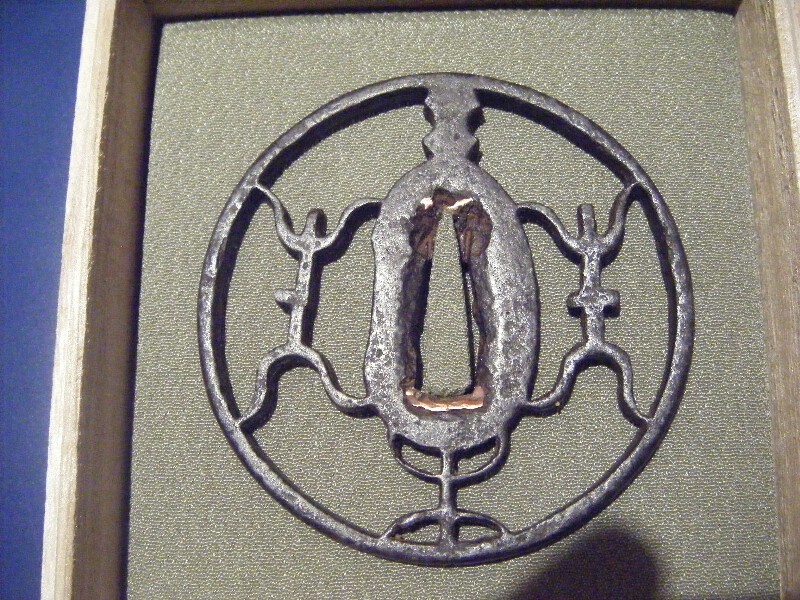

Akitombo Posted December 6, 2011 Report Posted December 6, 2011 Can some of the fellow members of this board help with the identification of the characters on this Owari tsuba. In Henri Joly's Inscriptions on Japanese Sword fittings, one of the plates shows the main character, but not what its meaning is. Regards David Quote

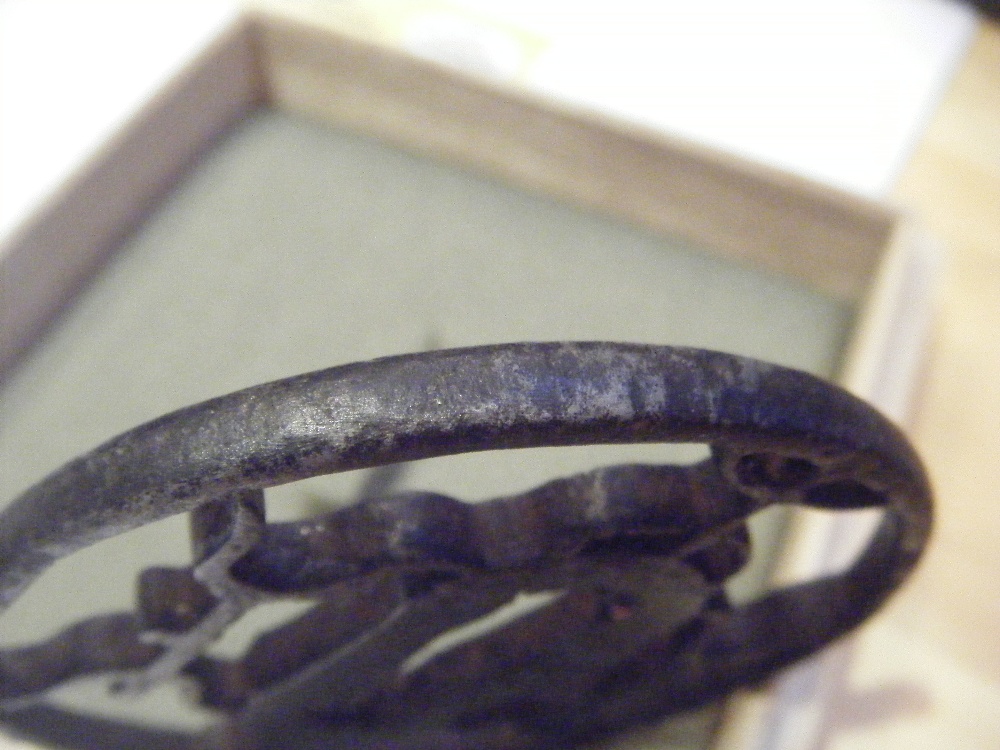

Soshin Posted December 7, 2011 Report Posted December 7, 2011 Hi David, Nice Owari Sukashi tsuba. Having some views of the rim would be great. I will do some searching and see if I can come up with something in terms of what the stylized Kanji characters are. Off the top of my head nothing comes to mind. Yours truly, David Stiles Quote

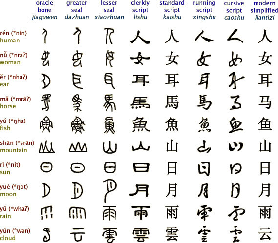

Ford Hallam Posted December 7, 2011 Report Posted December 7, 2011 I wouldn't refer to these as stylised kanji Kanji ultimately evolved from these, much earlier, forms. These are archaic Chinese characters, possibly the earliest type, those found oracle bones. This chart illustrates the sort of evolution the earlier forms went through to ultimately become what we recognise as kanji. This is probably the most comprehensive site on-line dealing with the development of written Chinese. A bit of detective work and the "hidden" meaning of the characters on the tsuba might be revealed. Quote

christianmalterre Posted December 7, 2011 Report Posted December 7, 2011 Yes-i would agree with Ford here... It´s an very interesting piece! (do not sell it-and if?-then let me know of course!) LOL! How about the idea of stylised personnages(left and right)performing an so called "archaic war dance"? Just an first idea here-i just saw this post... Such stylised motive can partially ben seen on bronze mirrors... ? Christian Quote
Akitombo Posted December 7, 2011 Author Report Posted December 7, 2011 Cheers guys, as always a library of knowledge. It is a subject which needs further research. As far as the tsuba itself is concerned, I have no plans to sell it, as it is one of my best loved. I found it last year in a Paris flea market, buried under a ton of rubbish. When asked, the stallholder said ten Euros, I could not get the note quickely enough out of my pocket. It was worth the EuroStar ticket, hotel bill and my wife trying to eat her way through France. It just shows that these items still lay awaiting us to rescue them. Happy HUnting David Quote
Steve Waszak Posted December 7, 2011 Report Posted December 7, 2011 David, Fascinating history of your finding this tsuba. Its identical twin was for sale (quickly sold) some eight years ago on one of the sites listed in the links section here. I remember it because I hurried to buy it, but was too late. Very nice tsuba. Would love to see other photos of it... ) Cheers, Steve Quote

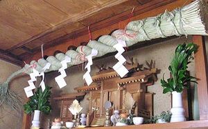

Lance Posted December 7, 2011 Report Posted December 7, 2011 Could the 2 side pieces not be kanji at all, but a pair of stylized Vajra? The bottom could be an incense burner?, and maybe at the top above the seppa dai, it could be one of the paper ribbons hung in Shinto shrines? Lots of maybes, or I just failed the Rorschach test....... Regards, Lance Quote
Soshin Posted December 8, 2011 Report Posted December 8, 2011 Hi Lance, I still think the ji-sukashi design is likely archaic Chinese characters. The design element above the seppa-dai is a weight used in money exchange. Please see the following link discussing it on a Kyo-Sukashi tsuba: http://kodogunosekai.com/2011/10/27/kyo-sukashi-testu-ji-sukashi-tsuba-%E4%BA%AC%E9%80%8F-%E9%89%84%E5%9C%B0-%E9%80%8F%E9%8D%94/. I Hope the author of the blog replies to the thread as he is very knowladge about Owari tsuba. The design element below is likely another archaic Chinese character. Hi David, The more I look at this tsuba it reminds me of mid period (i.e. Momoyama Period) Kanayama school work. Would love to see photos of the rim and have measurements including thickness. Nice story very different them many of my stories about finding a nice tsuba. Most of my stores just involve me saving money and waiting awhile. Yours truly, David Stiles Quote

Bugyotsuji Posted December 8, 2011 Report Posted December 8, 2011 Has the internal cross piece on the left motif been cut/broken off at some point, or is it original? Quote

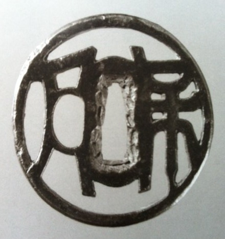

Marius Posted December 8, 2011 Report Posted December 8, 2011 Soshin said: The more I look at this tsuba it reminds me of mid period (i.e. Momoyama Period) Kanayama school work. I am with you here, David. In one of the KTK catalogues (can't recall which one), there was a Kanayama tsuba. The kanji on it is "Ho" - protection. Pictures of tsuba and kanji attached. Quote
Soshin Posted December 8, 2011 Report Posted December 8, 2011 Hi Mariusz K., To develop my idea some more of it being a Kanayama school tsuba from Owari Province circa the Momoyama Period. The tsuchimei-ji and glossiness on the surface is fairly clear both are often seen in Kanayama tsuba. The large over sized seppa-dai in proportion to the rest of the guard is often seen in Kanayama tsuba as well. The ji-sukashi design is not as complex or involving as many different design elements as you would see in Owari Sukashi tsuba in my opinion. Having additional information from the owner would be helpful as I think it would confirm my theory. I would suspect the tsuba to be small in size and thick with many tekkotsu "iron bones" along the rim. I would also expect the rim to be either square or rounded square in shape. This is often seen in Owari tsuba of all schools. I posted awhile back a Owari tsuba I purchased on eBay for about $90.00 USD a few years ago and it papered early this year to NBTHK Hozon to an Owari school circa the late Edo Period. It had the rounded square rim and is small and very thick in size. Photos of it are up on my website for reference. Yours truly, David Stiles Quote
Akitombo Posted December 8, 2011 Author Report Posted December 8, 2011 To add to this thread, the side has been filed, you can see the remains of the arm. If you look at the Halberstadt Collection book, item 76 has a very near example, again with the side arm removed to allow a kozuka. Size are as follows 2.82 inchs wide, 0.19 inchs thick on the mimi. Regards David Quote

edzo Posted December 9, 2011 Report Posted December 9, 2011 Bugyotsuji said: Has the internal cross piece on the left motif been cut/broken off at some point, or is it original? Dear Bugyotsuji, Given the shape of the seppa dai on that side i would sumit it was removed to make room for a kogai hitsu ana. Respectfully, ed F Edited: Make room for a Kozuka. Quote

Chris Colman Posted December 10, 2011 Report Posted December 10, 2011 Hi, Nothing to add to meaning of the tsuba, but I did find in my saved photos a Kaneyama with similar motif. regards chris colman Quote

Tim Evans Posted December 11, 2011 Report Posted December 11, 2011 The characters in the tsuba in question are "shu". See Nelson's Character dictionary #285. It means master, main principal, important, head of house, lord, etc. Can refer to a person or an idea. Sasano mentions it also means cinnibar. See M. Sasano's silver book, page 139. The character in the tsuba at the top of page 2 is not "ho" but "fuku", Nelsons #3741. It means serve in the military or discharge duties. Quote
Marius Posted December 11, 2011 Report Posted December 11, 2011 Tim, many thanks for the correction. Indeed, regarding the Kanayama tsuba on the top of page 2 of this thread, you are right. It is not "Ho"- thanks for pointing out this mistake (which I have repeated after the KTK book). For "Ho" anybody interested, please look up Sasano's silver book (Japanese Sworguards Masterpieces from the Sasano collection), a quite similar Kanayama tsuba #140, page 171 - "the character meaning 'to preserve' (ho-no-ji). Pic attached. Quote
