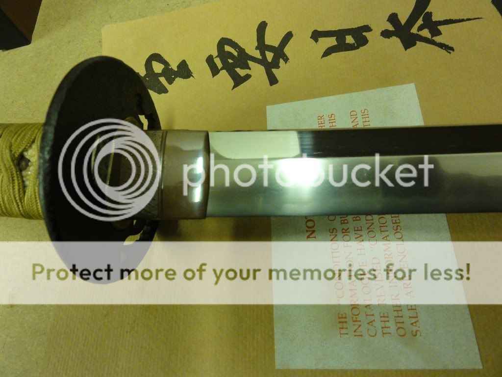

Hopefully you can see the mei properly, I have also included pictures of the Koshirae and Ko-gatana ( thanks Ken!), so if any of you could confirm the smith and provide and information from looking at the blade, hamon etc. Any comments and opinions on the sword welcome as well.

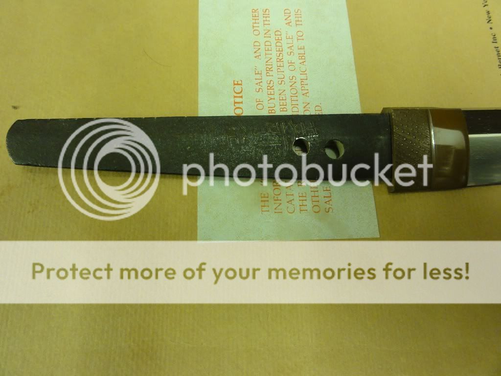

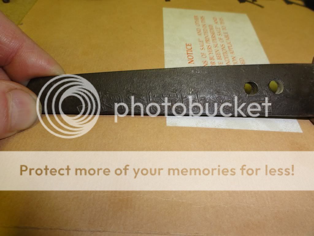

Mark,
any chance of a photo of the tang without your thumb covering the important 'end' bit of the tang , :thanks: I have a blade signed the same but need to compare the nakago-jiri and the yasuri before commenting further
many thanks
regards
John
Ahem... :oops: indeed, I was reading the sizes the wrong way around..apologies for my stupidity..!!

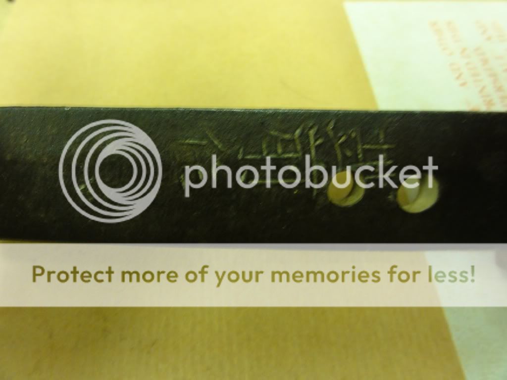

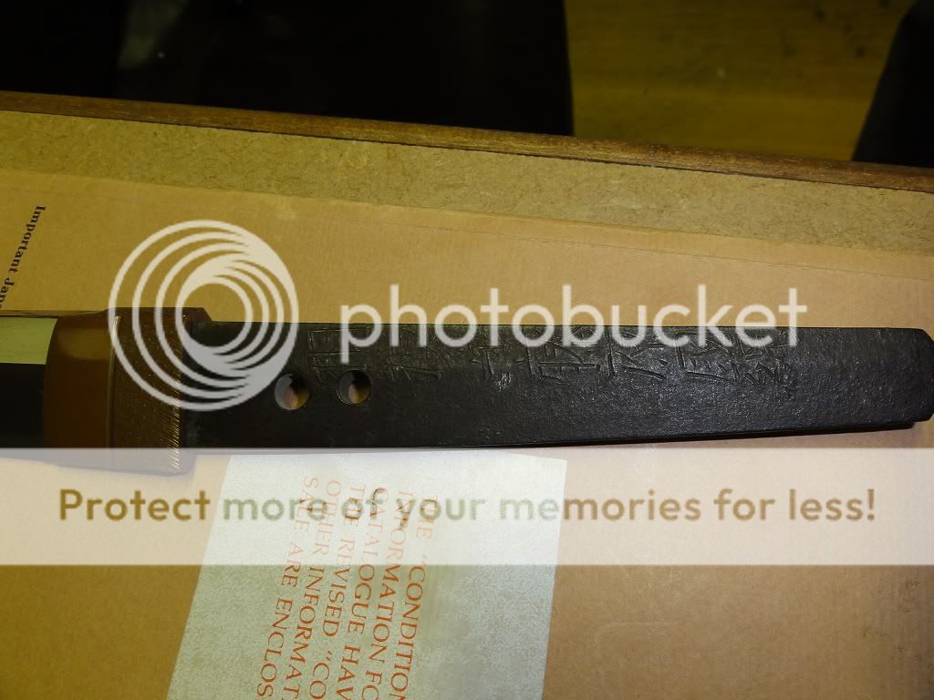

so here are the pictures, first without thumb, hopefully complete enough to see the shape..?

What does the smaller inscription on the reverse side of the tang say please? Is that the date?
Thanks, mark
Thanks, mark
Hello Mark,
it is no date, sorry, but reads 'Echizen ju', which means 'living in Echizen (Province)'.
So it is perhaps a smith of the Echizen Shimosaka School, although the oshigata in the 'Shinto Taikan' shows a little different writing (smaler, less confident written kanji).
Unfortunately the nakago jiri of the oshigata is not reproduced in the taikan :bang:

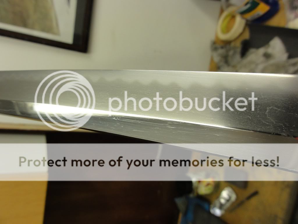

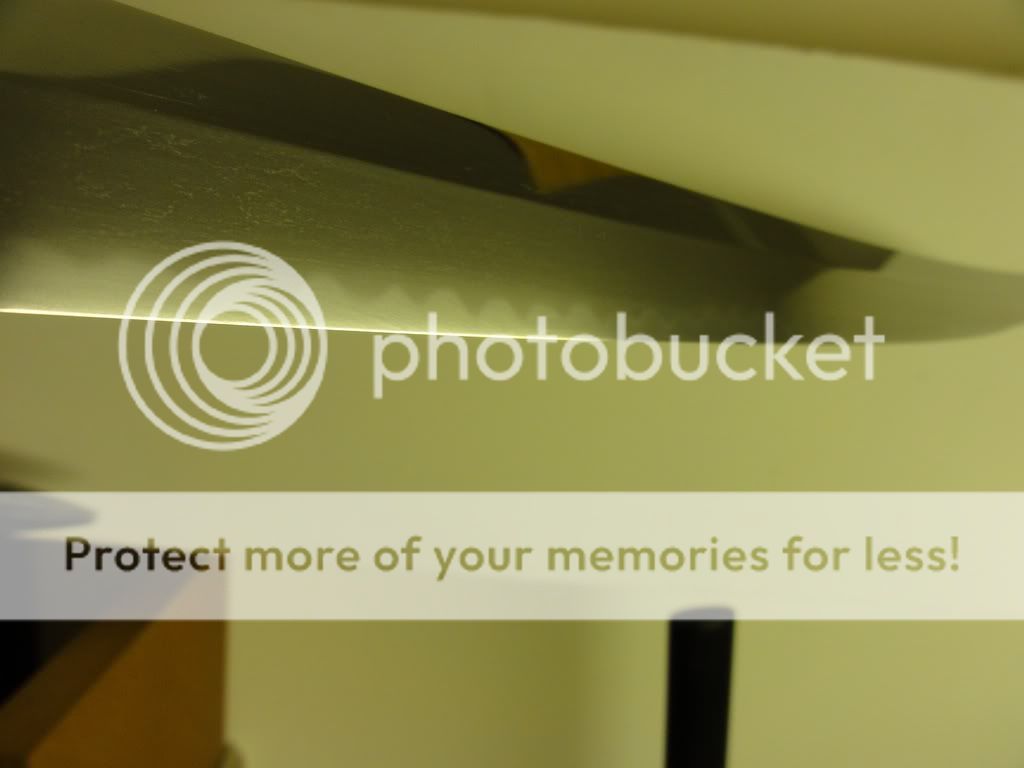

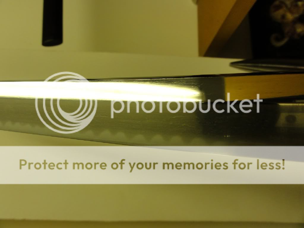

Hi, so I can say from study that my sword has several very similar traits to the second wakizashi I linked from aio art, the saya is the same shape with rounded end, the go katana is nearly the same, the Mei seems the same and the area the same. The shape of the blade is very nearly identical as well. The only thing that stands out as different to me, is the hamon.
Would you learned people say that the sword is the same smith? If so, then that is very useful for me, as there seems to be lots of information I can glean from the description etc given by aio art.

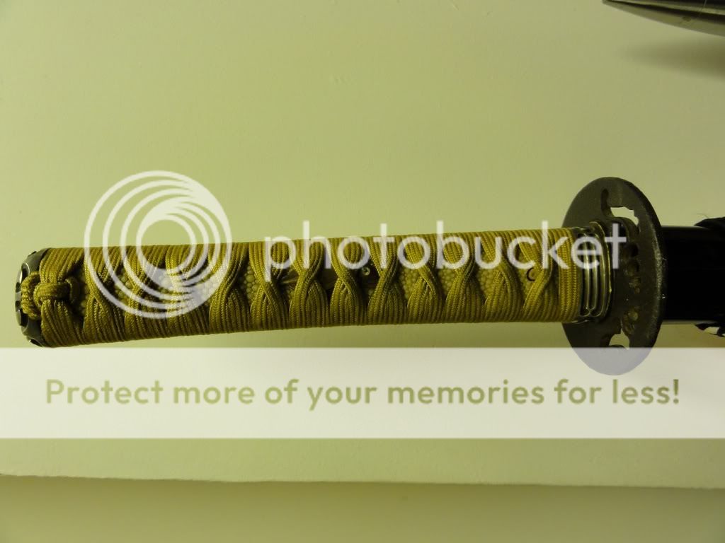

Would any you please also be so kind to describe and comment on the hamon and jigare of my sword and tell me what you think of it please? Curran, I to very much liked the fuchi-kashira, one of the big reasons for me buying it. I have not been able to see inside the fuchi to see if it is signed. Are they unusual in style?

The nakagojiri is the end (bottom) of the nakago. About Kuni and Tsuna that can say two things: first, the smith has drastically changed his manner of signing; second, the signature is false.
Hi Jacques, in that case, the false signature is on my sword, (As the other sword had papered )yes? Comparing them carefully, I do notice differences in the way the kanji are drawn on each. Do you think that is the case? Is it a point to fake a signature of a relatively minor smith? What do you think the hamon and other characteristics of the sword are telling you? It would be good to know wether or not I have got myself a good sword or a lemon..

fuchi-kashira:
Design is unusual, but not unknown. I forget the term for them. Sometimes they are two tone, or done in a way where the deep carving reveals mokume layers.
Signature would be on the outer (public) face of the fuchi when the tsuka is taken off the nakago.
It is most likely they are unsigned, but I figured I would ask.

From what i can see on your pictures it seems to me the hamon is too regular compared with those i've seen . If you google :" Sagami no kami Fujiwara Kunitsuna", you will find some examples of papered swords, and you will make your own opinion.

" About Kuni and Tsuna that can say two things: first, the smith has drastically changed his manner of signing; second, the signature is false."
I to have a sword that is signed 'echizen ju sagami no kami fujiwara kunitsuna' but with the same suspect 'kuni' and 'tsuna'
mine is also signed with another smith's name 'izumi no kami fujiwara kunihiro' on the other side of the tang ( ura-mei ? )
( so maybe a joint smith signing, it was thought it maybe father and son)
however my sword was pink slipped at my last shinsa for 'gimei' signature and the known kunitsuna's nakago-jiri and yasuri being different to mine,
I think that maybe your sword was signed by the same smith as mine as the 'kuni' and 'tsuna' are signed in similar style.

Making a firm judgement on the market value of a Japanese sword is very difficult in general, and even more so when trying to do so by pictures. It's commonly said that a sword is worth what someone will pay for it. This is of no help to someone buying a sword, but that's just the way it is. Like Grey said, we don't know what you paid and we don't have the luxury of viewing the sword in hand.
With your sword, it doesn't look like it's going to be possible for the forum to give a firm judgement on it's authenticity. In this case, I think you have to assume your sword is gimei until you have a shinsa panel confirm otherwise.
That being said, it appears to be a well made Japanese sword that looks to me to be 2 to 4 hundred years old... and personally I would lean more towards the 1600's. The mounts look like good quality as well.
I hesitate to even say this, but if I were buying this sword/koshirae, and I was considering it gimei (with the possibility of having the mei removed), I would look for a conservative price around $1500-$2500. That doesn't mean that's what it's worth, that just means that's what it would be worth to me... and I only put my head on the chopping block by saying this to try to relieve some of your frustration. Mabey others will be able to agree or disagree with that price range, and you can use those opinions to help you make a decision. :)
