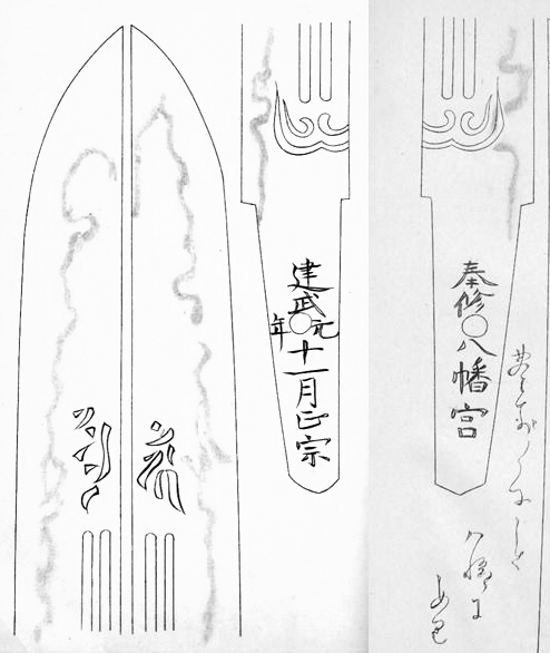

Adrian, could you please show a pic of the oshigata.
The Musashi Masamune
Eric
G'day to all,
Here is a scan of number "#4 Hocho Masamune" from Tsuguhira's oshigatas. Has anybody got any more info on this one, anything will help.
Eric, nice recent info on the Musashi Masamune, looks like I'm not the only one who thought it looked later :D . I'll scan Tsuguhira's oshigata tonight, did that NBTHK article come with an oshigata? Does anyone have it?
Reinhard, can you clarify that comment please?
cheers,
G'day to all,
cheers,
Taking into account the method in which Tsuguhira made his oshigata of Meito, it is my opinion this is his translation of how he saw the Sukashi Hocho Masamune.
The hamon in the tip seems to match.
Stephen T
G'day Stephen and all,
There is no doubt that the Sukashi Hocho Masamune is very similar to this one from Tsuguhira's oshigata. But it is definately not the same sword. This sword has Bonji and what looks to be a Kinpun mei, the Sukashi Masamune does not. Tsuguhira's oshigata are actually very accurate. Stephen, I know you have this book, look at the Sadamune on page 135, I have seen this sword recently and it is shown in the Sano Museum catalouge "MEIBUTSU - treasured Japanese swords ". Tsuguhira's oshigata is identical and perfect in every small detail. Tsuguhira was a swordsmith and the clarity of the lines on his oshigata show me he had an eye for detail as all good swordsmiths have. Over the holidays I will been spend some time studying Tsuguhira's oshigata and comparing them the surviving swords, so far I've found him accurate, but will give you a full report later.
