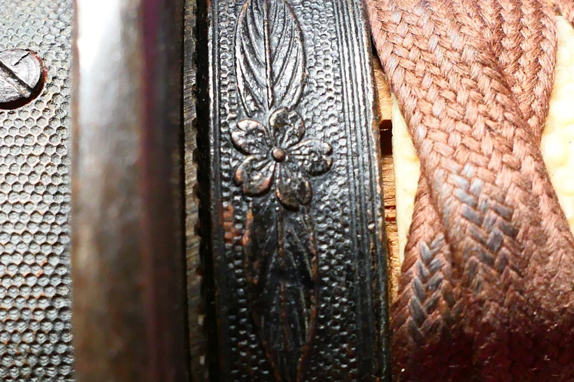

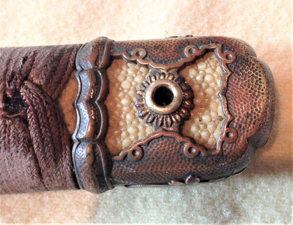

Oh it is definitely Celluliod. You cant see it in the pic, but under Fuchi the material is apparent. Its smooth molded plastic. Also, I will mention as an advisory, this material happens to be highly flammable.  There was a little piece that had broken off a while back that i tested  (i seemed to recall hearing something about early plastics causing fires.)  This stuff burns like old gunpowder.  That could perhaps be used as a storage safety tip .
Kurt k
Or maybe some kind of lizzard?
i tryed to make a better photo.
If you go with the finger over it, it feels a little bit sharp.

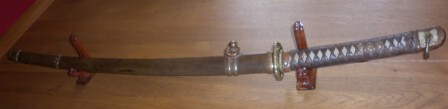

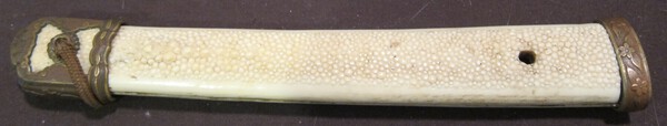

Hello George,
                      I have attached some photo's of a shin-gunto with a celluloid same . The sword is  by the Toyo Hamono knife Co Ltd ., An interesting example of maybe the last attempt to produce a sword for combat purpose. Shinbu - to , a cold bearable sword made using  " Tahado " steel ( nickel chromium manganese steel ). It's a very well put together sword with nice quality fittings.
                                                                                                                                                                                 Regards,
                                                                                                                                                                                               Paul..

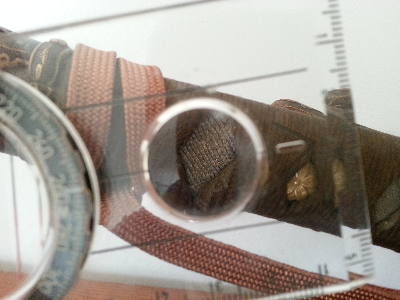

Okay, necroposting on this but to add to the list. The Mantetsu I recently bought (sa 520, nan, w, Spring 1943, already in Bruce’s database) has a celluloid same too, so climate may have been a factor... of the lack of Same material. Gotta say, though that I noticed this only recently and contrary to my other swords (granted, all of them older), this same has resisted the test of time without a crack.

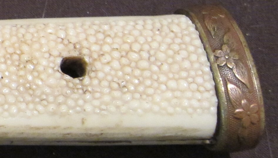

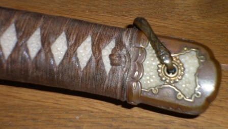

Is this what you are talking about Bettina?
I was given this cellulose same wrapped hilt several years ago...can't remember if I've posted it before...but this is what the "full" wrap type look like. Very good quality IMO.

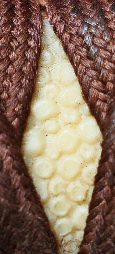

Hi Baz,
Yes, looks great, but definitely cellulose...no "cracks' between grains and moulded to fit right around to the 'seam' of each half of the hilt. Not sure it helps, but here is a close-up.
Regards,
Geo.

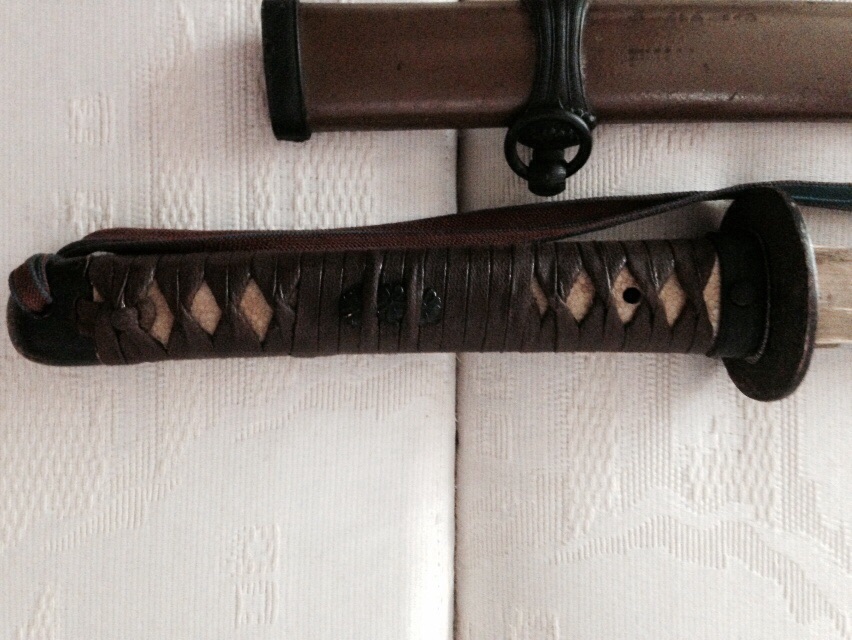

I have an undated Emura katana with celluloid. Like @Bruce Pennington mentioned, I thought this was an after war repair. Wasn't sure what I really had. Just got a gunto over the week with sharkskin. Got my own little collection of odd tsuka wrap material. Lol

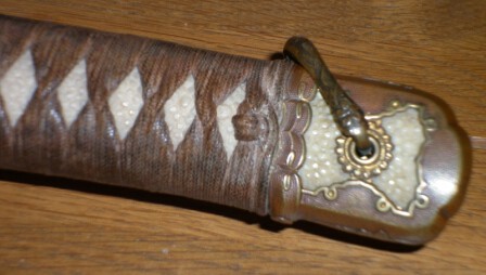

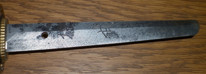

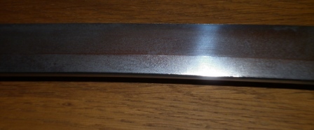

Further to my previous post, here are a couple of more detailed pics of my RS with a celluloid (I think :-) same.
George, I've started a new thread on this mumei RS. Thanks.
Regards,
Paul
PS: sorry, that last image is inverted!
