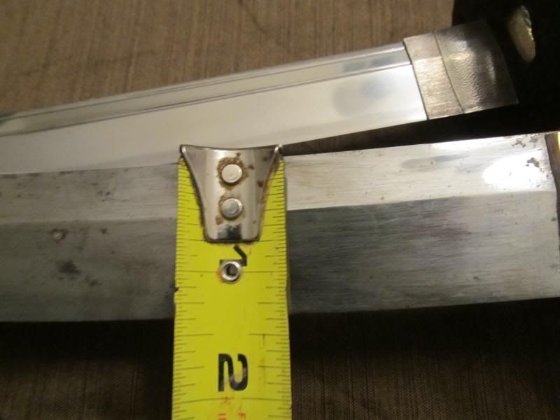

daishobohi Posted November 10, 2011 Report Posted November 10, 2011 Hello ALL I just picked up this sword, Story is that this sword was used during ww2 to cut the heads off of the gi s The man whom owned sword said he saw the Japanese cut off several heads with it before it was taken.... I have seen alot of swords but this sword is super thick and I was wondering if any one had seen a sword this thick and if it looks like this sword was made for beheading? Here are some pictures of sword..... nakago looks old maybe koto cut down Thanks in advance Yitzy Quote
cabowen Posted November 10, 2011 Report Posted November 10, 2011 Assuming you are talking about the larger of the two swords, it seems wider than average. I can't say anything about the thickness or nakago without photos of each....There weren't "special" swords made for beheading as they all will do so when used by a skilled swordsman... Quote
daishobohi Posted November 10, 2011 Author Report Posted November 10, 2011 Hi Chris I will add pix of nakago I am talking about larger sword I know some of the reverse blades were for beheading but didnt know if they made other ones for the specific purpose Yitzy Quote
