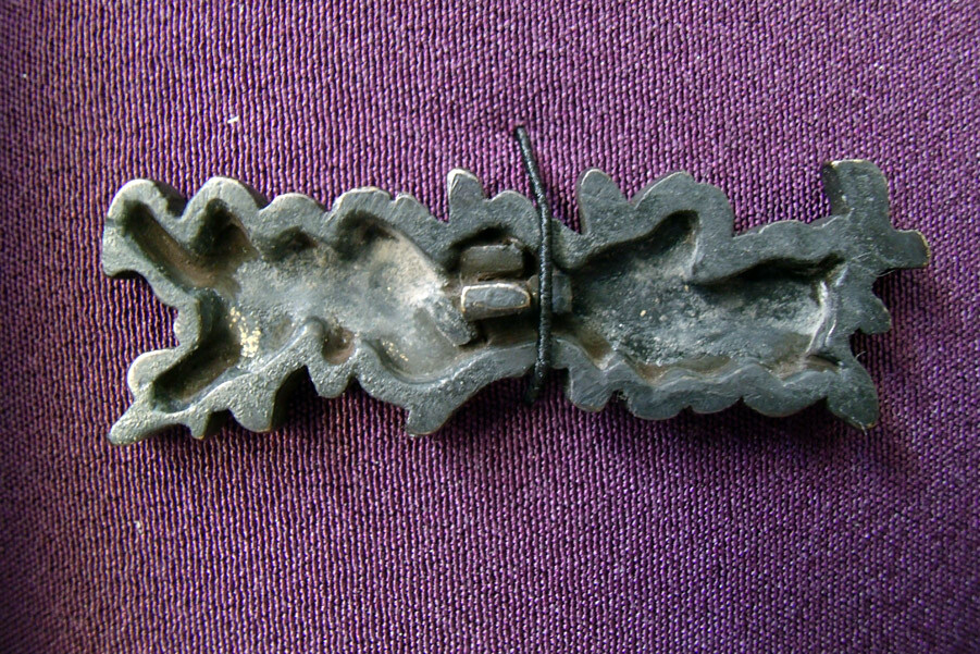

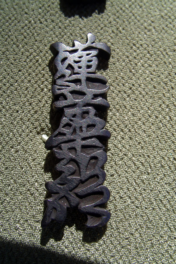

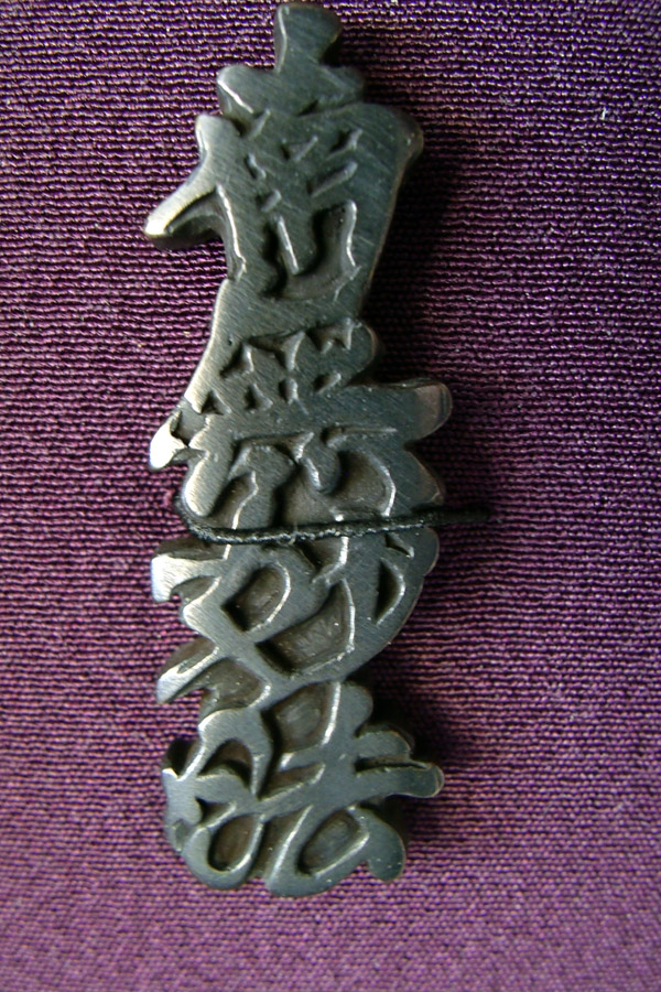

Just purchased this pair of Menuki - they were sold as Gendai, but the patina seems a bit older. Just looking for thoughts on possible age - I also found that the kanji was unusual for menuki I've seen, so any opinions on that would be welcome as well, Regardless, I like them and enjoy their unique design. Very heavy, and Shakudo,
Thanks,
Curt R.
Dear Curt,
i am sorry to say this-but,at least in mine eyes,those are(as you say)Gendai if not even worse.
The cast is of very low quality,the walls are clumpsy,the patination is an fake-and the core material is copper or an copper-base alloy.
Shakudo would not spot out yellowish when there´s abrasive of the patina-equally an shakudo patination would look different.
Equally you see cisel marks on the face-surface which,in case of an old one-would very certainly not ashine in this manner.
An cast reproduction!
The Originals those here were copied from,are depicted in the Behrens collection-as far(equally) also in one article by Robert Burawoy in the Arts of Asia.
(i will have an look so to send you an photocopy of those published ones-it´s just that today i´m a bit busy...passion so far)
Christian
Thanks Christian - it is better to know the truth! I suspected they were Gendai, but as you outlined the flaws I can see exactly what issues you describe :bang: . I need to get better reference books and study more. Fortunately I didn't pay a huge amount for them but still disappointing.

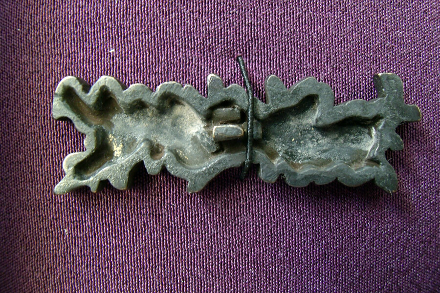

I have a question. Not trying to tear down this set of menuki; I'm honestly puzzled.
Are these even real menuki? The picture of the back side makes them look like they were cast in one piece. The posts and attachments are the same material as the rest; wouldn't we expect them to be somewhat different?
Are these cast copies?
Grey
Grey, it is the lighting/shadow I believe...the 'fins' on the posts are attached separately to the body, if that helps clarify? It does appear to be the same metal, but they weren't cast with the body from what I can tell through a 4x loupe. The are also almost black in color, but the direct sunlight makes them appear more silver-ish. I have a decent pair of Edo Persimmon menuki, and the posts appear to be attached in the same (or similar) way.
