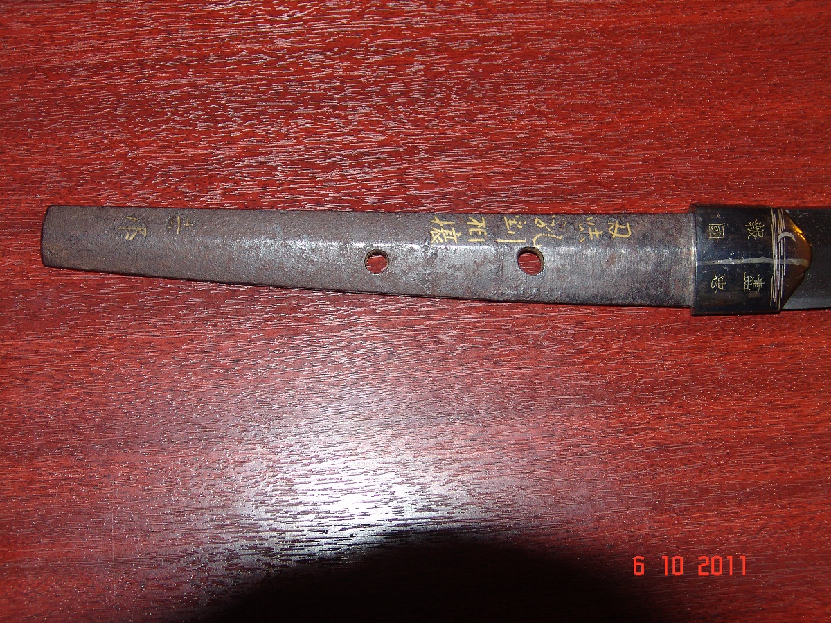

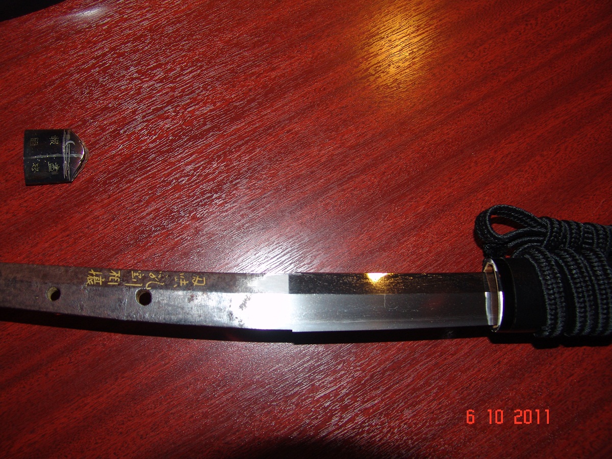

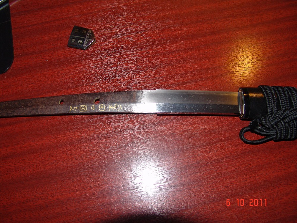

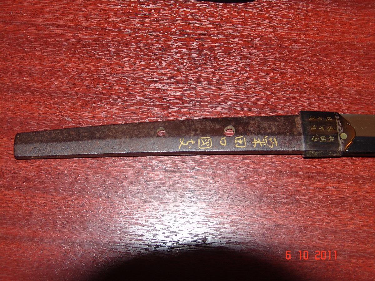

popsic Posted October 6, 2011 Report Posted October 6, 2011 I want to address to dear community of experts once again. What do you think of this sword? It's possible to read Kanji on ura mei? Regards, Vlad Quote
sanjuro Posted October 6, 2011 Report Posted October 6, 2011 Vlad. My initial reaction to this without more detailed pictures, is that the kanji look wooden and rather stereotyped. Kanji engraved on the habaki is a rare occurrence in true nihonto, but frequently found on Chinese fakes. This configuration of fairly long habaki with a Mt fuji theme is quite modern and not necessarily Japanese in origin. I'm not passing judgement on the basis of these few pictures but merely making you aware that the possibility exists that this may not be a nihonto. More pictures of the nakago without the habaki, and an overall picture of the sugata would help a little. Quote
Grey Doffin Posted October 6, 2011 Report Posted October 6, 2011 Hi Vlad, Looks very much like real Nihonto to me. Never seen a fake look this real. Grey Quote

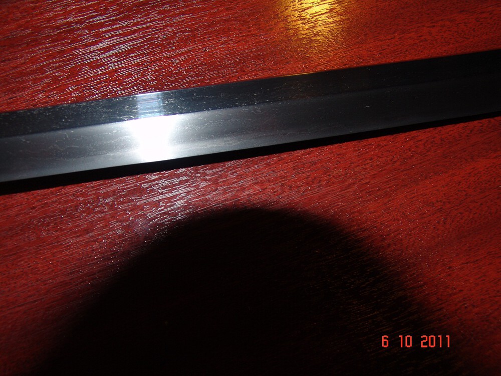

lbkmd43 Posted October 6, 2011 Report Posted October 6, 2011 nakago appears to be original kiri and kiri yasurime are evident suguha hamon with hataraki in hamon very nice no way chinese fake old sword what does it have tori or koshi zori? should be shinsad LKanarekMD Quote

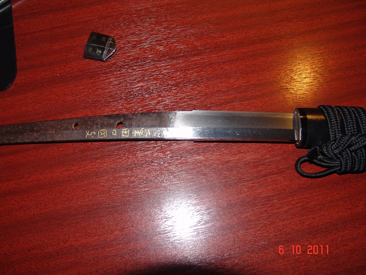

popsic Posted October 6, 2011 Author Report Posted October 6, 2011 lbkmd43 said: nakago appears to be original kiri and kiri yasurime are evident suguha hamon with hataraki in hamon very nice no way chinese fake old sword what does it have tori or koshi zori? should be shinsadLKanarekMD Thank you for replay. It's look like koshi zori but after O-suriage. Please take a look. Regards, Vlad Quote

Jacques Posted October 6, 2011 Report Posted October 6, 2011 Hi, Real Japanese sword but not real Awataguchi Kunitomo. Quote
popsic Posted October 6, 2011 Author Report Posted October 6, 2011 Jacques D. said: Hi, Real Japanese sword but not real Awataguchi Kunitomo. Thank you, Could you explain your deсision? Who belong this work and what written on ura mei, please? Quote

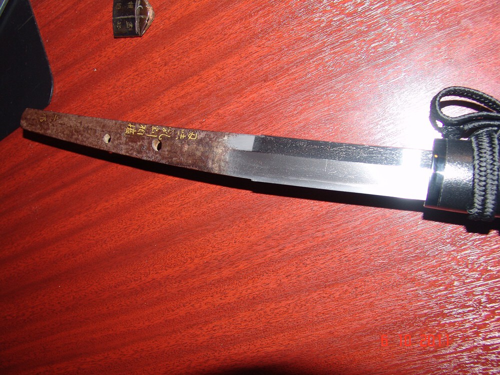

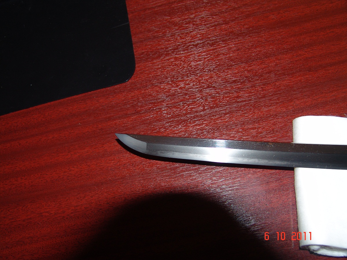

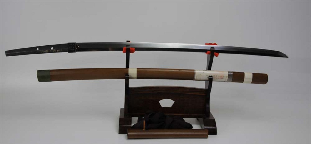

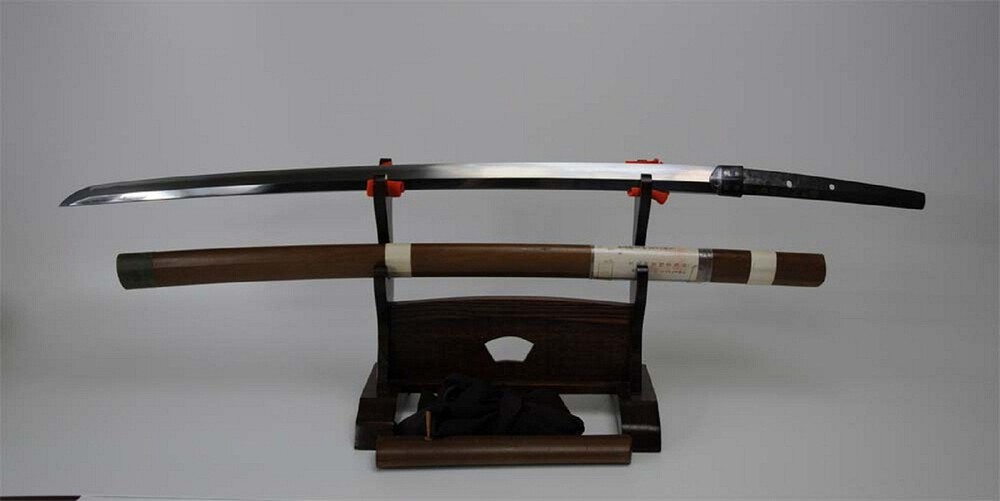

lbkmd43 Posted October 6, 2011 Report Posted October 6, 2011 Vlad went over nakago again sword is very koshizori what are two charachters on bottom of nakago sword is suriage but maybe not o suriage to make a statement that its not awataguchi seem impudent to me would like to see close up pictures of boshi nie nio and some better pics of hada then as I said BEFORE SHINSA real good looking nihonto LKanarekMD Quote
David Flynn Posted October 6, 2011 Report Posted October 6, 2011 Koshizori in a sword that looks O suriage, are commonly Shinshinto copies. I'm not saying this one is, however it is a possibility. Quote
sanjuro Posted October 6, 2011 Report Posted October 6, 2011 Hi Vlad. Thanks for the extra pics. Obviously this is a real nihonto and my caution was premature. Nice blade, and as David has pointed out, it seems to be a later rather than an earlier sword. Quote
Jacques Posted October 7, 2011 Report Posted October 7, 2011 Hi, Awataguchi Kunitomo is a very big name (rated Saijo saku by Fujishiro), he was a Gotoba ban kaji, and his extent long works are scarce (only two signed blades). Sugata and kissaki lenght don't match. Quote
