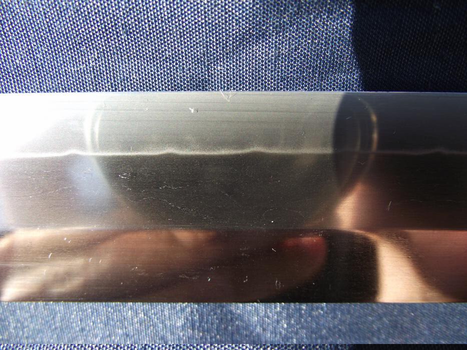

Kam Posted September 22, 2011 Report Posted September 22, 2011 Hi As i have had a few people contact me in regards to my pink slipped Emura (sorry Dave it just never ends) I have been informed of some interesting findings. I can not validate most of these as they are other peoples experiences but I will relate them anyway. One gentlemen informed me that back in the mid 80's he bought an Emura with saka choji and a large section of mune yaki, another pointed out that he has owned 2 Emura 1 of which was almost identical to mine in all aspects except that the Hamon went from suguha to choji. I wonder how much his style changed and now with a lot of gimae gendaito bouncing around it is becoming a lot harder to have these other elements officially accepted. Kam Quote

David Flynn Posted September 23, 2011 Report Posted September 23, 2011 One of the reasons this sword was knocked back, was the Yasurimei. This particular sword of Kams' Yasurimei, ended in the shape of a Diamond, just below the habaki. In all the Emura blades and oshigata I've seen, this trait has never been present. I'm not saying, there never has been, just the ones I've seen. Also the hada in this sword, appeared Muji. Quote
Kam Posted September 23, 2011 Report Posted September 23, 2011 Hey Dave I was informed by the guy that I had mentioned had an emura like mine except his suguha turned into choji that his also had kesho yasurime. And to top it off there is an emura on evilbay that also has kesho yasurime. As for muji hada I think the chilli in the szechuan we had must have stung your eyes as well, take a look at attached pic. . . there is a lot of hataraki you just need the right light to see it. . . . Kam Quote
David Flynn Posted September 23, 2011 Report Posted September 23, 2011 Kam, my apologies about the hada, must have been the lights in the showroom. Quote
Kam Posted September 23, 2011 Report Posted September 23, 2011 Mate no need to appologies, I was hoping for a witty remark. I enjoyed stirring you up at the Shinsa maybe I thought I could get a bite. But your mushin has thwarted my attempts :? . . . I see your zen powers are to much for me Kam Quote
