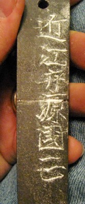

Purchased this sword locally this afternoon...couldn't help myself. One of the characters looks like "Nobu", but that's as far as I got. If someone could be so kind as to put it together, I would be most grateful. If I can make it any easier to read, please let me know what I can do to help. I've also included a picture of a piece of paper pasted to the saya for your perusal. Thanks so much for any help you may be.

Dear Mark
I read
Omi no Kami Minamoto Kunimasa
近O
江mi
守Kami
源Minamoto
国Kuni
正masa
Hawley KUN418 and KUN440
Worked in Musashi and Iwashiro around 1688 and student of Hidetoke
Worked in suguba
good luck
david mcdonald
