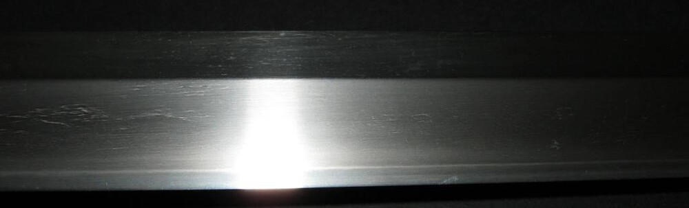

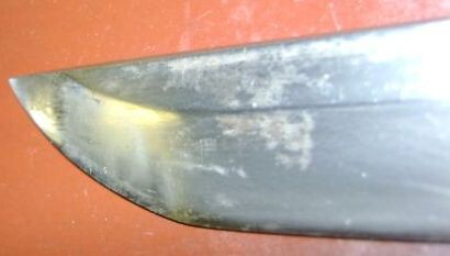

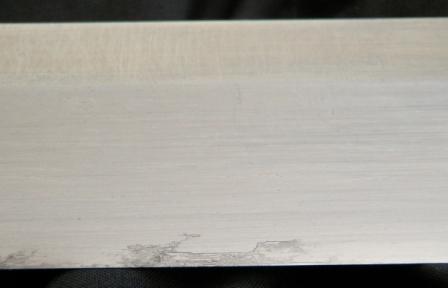

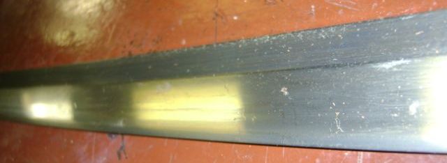

steve oakley Posted September 17, 2011 Report Posted September 17, 2011 As this is my item, I have waited and watched the comments. Yes I am surprised at the results at Shinsa. I was thinking that it would have been failed at Shinsa for being too tired or unable to attribute it to the school or period. Not that they believed it was WW2 oil quenched. As a novice I would have said it was a few hundreds years old, not the age of my father. I have attached some more photos. Yes it did get a touch up polish but in hindsight maybe it should have been left as it was prior to Shinsa. The polish did remove some unsightly rust marks and small cracks though. In regard to the photo that shows the rough hada, this is this the only area on the blade that this appears and there is no roughness on the respective opposite side. So if it had been bent then straightened i would have thought that the roughness would also be on the opposite side. Unfortunately, i have missed the boat on the NTHK-NPO Shinsa coming up, but yes i will submit again and see what the result is. I will inform you of those results in good time. Thankyou for your opinions. Steve Quote

drbvac Posted September 17, 2011 Report Posted September 17, 2011 The pre and post pics are neat - I wonder if the toshigi ( if in fact it was one) simply put a hodori hamon on the blade Quote
cabowen Posted September 17, 2011 Author Report Posted September 17, 2011 I believe the hamon is visible in the boshi in the last picture....It is done in an ito suguha and hard to see... Quote
runagmc Posted September 17, 2011 Report Posted September 17, 2011 I don't see any hadori work, I just see the habuchi/nioiguchi... Quote

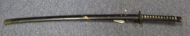

Toryu2020 Posted September 18, 2011 Report Posted September 18, 2011 Certainly is a curious call given what we can see, though I do believe that koshirae are submitted separately so there is one piece of evidence that we have that the shinsa team did not. I wonder Steve would you be willing to post photos of the hamon/nakago in the area of the hamachi? Not sure it will tell us anything but as I said I'm curious now... -t Quote
Jean Posted September 18, 2011 Report Posted September 18, 2011 koshirae are submitted separately so there is one piece of evidence that we have that the shinsa team did not Tom, I can't remember the number of saya that I have seen adapted to fit a blade ....Whether done in Japan or abroad .... Quote
cabowen Posted September 18, 2011 Author Report Posted September 18, 2011 Tom, I can't remember the number of saya that I have seen adapted to fit a blade ....Whether done in Japan or abroad .... That is possible, but in this case, not probable. In any case, it is a lengthy and difficult process to refit a saya to a blade- why bother with an "oil tempered" WWII blade? It might have been a good idea for the owner to have pointed out to the shinsa team that the blade was in edo period koshirae.....then again, there seems to be plenty of other indications in the blade itself that this may not be an oil tempered wwII blade.... Quote
steve oakley Posted September 19, 2011 Report Posted September 19, 2011 I have attached a few more photos. The tsuka has since been re-wrapped and the tsuka fittings are not the original from the purchase as seen in the koshirae photo. However the tusba and kojiri are unchanged. Steve Quote
cabowen Posted September 19, 2011 Author Report Posted September 19, 2011 Usually oil quenching produces a wide, diffuse, ill defined nioi guchi. This sword seems to have a tight, crisp, thin nioi habuchi very uncharacteristic of what you see in blades that are oil quenched.... Quote
