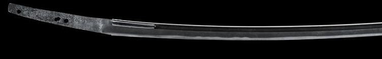

estcrh Posted March 12, 2012 Author Report Posted March 12, 2012 Eric. Do you own this blade???? If you do, I'll be over to wherever you live. We can get drunk, see who can tell the biggest lies and I'll steal it from you. :DKeith, no but I will have access to it and a new Nikon D3000, I have a better idea now what to look for, I will see if I can get some good clear photographs. Quote
drbvac Posted March 12, 2012 Report Posted March 12, 2012 ""Impressive blade, I presume that it is tachi meied? (I love this neologism )"" Of course its tachi meieded. ""Rare to see what appears to be a yaki-dashi on a mid muromachi period blade."" ""Yes, a sugu yakidashi is not to be expected on a koto period blade. John" It could very well be my less than stellar picture taking. The hamon near the nakago is suguha and then about 3" from the habaki it goes all midare and then tapers out to suguha again. I don't think it is actually yakidashi- just a change. It also has the elusive "funbari" Quote

runagmc Posted March 13, 2012 Report Posted March 13, 2012 Funny how he mentions the funbari... Many people on this forum have argued that funbari can only be found on Heian and Kamakura tachi... Quote
sanjuro Posted March 13, 2012 Report Posted March 13, 2012 Many people on this forum have argued that funbari can only be found on Heian and Kamakura tachi.. Not 'CAN ONLY' , Funbari can be found ORIGINALLY on tachi from the Heian and Kamakura periods. Which is to say that this is when the feature was most commonly incorporated on tachi for various reasons. Tachi did not simply jump from one style to the next in nice crisp gradiations with a specific time at which a particular feature promptly disappeared and a new one took its place. Old style tachi were still being made long after the end of the Kamakura period alongside the then current style, and they may well have included the feature called funbari. Indeed, there have been tachi made in deliberate emulation of Kamakura styles incorporating funbari as late as the Shin shinto period. :D Quote
John A Stuart Posted March 13, 2012 Report Posted March 13, 2012 I hope that when people mention funbari they have the correct understanding of what it really is. It is not the taper seen in a lot of swords from the width of the motohaba to the sakihaba ( this is defined wrongly in a lot of places, even some Japanese sources). It is the fairly abrupt taper in the area from the machi upwards (in the forte) a short way (10-15cm) where the mune is not parallel to the ha. The importance of which is to strengthen the forte. John Quote

runagmc Posted March 14, 2012 Report Posted March 14, 2012 Not 'CAN ONLY' , Funbari can be found ORIGINALLY on tachi from the Heian and Kamakura periods. Which is to say that this is when the feature was most commonly incorporated on tachi for various reasons. Tachi did not simply jump from one style to the next in nice crisp gradiations with a specific time at which a particular feature promptly disappeared and a new one took its place. Old style tachi were still being made long after the end of the Kamakura period alongside the then current style, and they may well have included the feature called funbari. Indeed, there have been tachi made in deliberate emulation of Kamakura styles incorporating funbari as late as the Shin shinto period. :D Keith, what you say is exactly my point, which is why it makes no sense to say funbari can only be found up to the Kamakura era. Last time we had this discussion there were several people who argued that funbari is only seen on ubu Kamakura and older tachi, which doesn't make sense to me. Funbari is just a physical feature that can be made into any blade. I fully agree that it originated and is most common in early tachi, but to say nothing outside of that era can have funbari is wrong to me. Also, funbari is not something that just IS or IS NOT present. It's something that has a range, from none to alot. There can be no funbari, or a little funbari, all the way to very prominent funbari. And I'm talking about abrupt widening at the machi. Anyway, sorry to take the post off track. Quote
sanjuro Posted March 15, 2012 Report Posted March 15, 2012 I dont follow your reasoning here. If a blade has no funbari then funbari IS NOT present. If it has any funbari of any measurable degree, then funbari IS present...... Ergo, funbari is either present or it is not. Maybe I'm missing something here. :? Quote
Jacques Posted March 15, 2012 Report Posted March 15, 2012 Hi, Indeed, there have been tachi made in deliberate emulation of Kamakura styles incorporating funbari as late as the Shin shinto period. I would like to see an example. Quote
runagmc Posted March 15, 2012 Report Posted March 15, 2012 I dont follow your reasoning here. If a blade has no funbari then funbari IS NOT present. If it has any funbari of any measurable degree, then funbari IS present...... Ergo, funbari is either present or it is not. Maybe I'm missing something here. :? Your right, it's either present or not, but it can be present in varying degrees of prominence. I think you know what I'm getting at, but just in case your still confused, Quote
sanjuro Posted March 15, 2012 Report Posted March 15, 2012 Adam. Believe me , I am not confused about the meaning of funbari or to what degree it is present. Your example incidentally is a bit off. A steepening of the mune does not produce funbari. Funbari is a widening of the blade surface beginning at the machi and extending some ten to fifteen centimetres above the machi, and blending then with the normal sugata of the blade. (Like a man standing feet apart, it has been said). But I do know what you are trying to convey. Jacques. I have a blade at home that is a shinto/shinshinto tachi with a rather gentle funbari. It cant be anything but a tachi blade since the kissaki is Ikari O kissaki and it is almost impossible to use such a blade mounted as a Katana. Its also in an original full tachi koshirae of the period. When I return to Australia in a few days I'll take a decent picture of it and post it here. :D Quote
runagmc Posted March 15, 2012 Report Posted March 15, 2012 Keith, I didn't point to the mune in the picture. And while your right, if you notice, often the shape of the mune machi and the suguta of the nakago can give the illusion of a sword having more prominent funbari... specially on old tachi that have the nakago kicked back like this, Quote
runagmc Posted March 15, 2012 Report Posted March 15, 2012 Jacques, here's some pics to consider, all from swords much later than Kamakura, Quote

sanjuro Posted March 16, 2012 Report Posted March 16, 2012 Adam. What you have posted are not examples of funbari. Most are Shinto or Shin shinto katana (except the Shibata example) and all have a normal sugata for a relatively healthy blade that has not been extensively polished and become tired. This is often where those who have not seen funbari in the flesh as it were, make the same mistake. A koto blade with funbari may be tired from many polishes but unless it has been shortened and a degree of the original funbari has been lost, there will still be a marked widening of the blade in that lower 10 to 15 centimetres of the blade. This is where your statement of funbari being a matter of degree is at fault. What you have seen in koto blades that have been shortened is what is left of the original funbari, this will have differed according to the amount of shortening the blade has suffered. It is from that which has come your interpretation of what constitutes funbari. At least this is how it seems to me. :D Quote
paulb Posted March 16, 2012 Report Posted March 16, 2012 Hi Jacques, sorry to disagree with you but in the image you have posted the apparent fumbari appears to be more the result of the polisher removing a damaged section in the ha near the ha-machi than the smiths intention to narrow the blade. Quote
runagmc Posted March 16, 2012 Report Posted March 16, 2012 Jacques, so your telling me you believe not one of the blades I posted has ANY amount of funbari? While the Munechika does have funbari, alot of it's prominence seems to come from the nakago being angled back and the way the blade has been polished over the years. No, I'm not joking at all... I'm wondering if you and Keith might be kidding yourselves. Quote
sanjuro Posted March 16, 2012 Report Posted March 16, 2012 We seem to have come full circle in this topic, at least concerning funbari. The subject of funbari was discussed in this thread on pages 1 through 3 with Adam disagreeing similarly. This subject has I think become a pointless excercise not worthy of repeating. Clearly, any further explanations will be greeted by the same disagreements from the same quarter. Can we move on or is this going to become, as other recent subjects on this forum have done, a sort of nihonto 'groundhog day'? 1 Quote
runagmc Posted March 16, 2012 Report Posted March 16, 2012 What you have seen in koto blades that have been shortened is what is left of the original funbari, this will have differed according to the amount of shortening the blade has suffered Keith, I love how you assume that I don't know something as basic as the difference between ubu, suriage, and o-suriage state of a blade, and what affect shortening would have on funbari:roll: Quote
runagmc Posted March 16, 2012 Report Posted March 16, 2012 A koto blade with funbari may be tired from many polishes but unless it has been shortened and a degree of the original funbari has been lost, there will still be a marked widening of the blade in that lower 10 to 15 centimetres of the blade. I would say over polishing can have the effect of making funbari look MORE pronounced. Many times on old blades (even tanto) the area directly up from the hamachi has to be left wider just to maintain the machi. Quote
runagmc Posted March 16, 2012 Report Posted March 16, 2012 Here is a pic of a ko Bizen Tomonari that is always said to have funbari. Decide for yourselves... Quote
