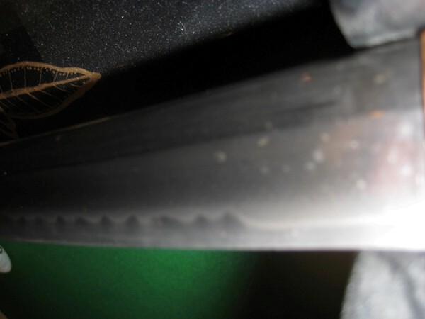

runagmc Posted September 16, 2011 Report Posted September 16, 2011 drbvac said: Should insist on proper terminology :lol: Back to the topic of funbari and the pic of the mino blade with "no funbari" so that I may compare and see what I "think" you are talking about if the blade were shortened as it appears to be would the area where it is slightly wider not be eliminated? :? Yes it is obviously shortened and machi-okuri which would cause it to lose its funbari (if it had it before shortening). But for this purpose I thought it illustrated the difference well. I could post a pic of an ubu blade withouy funbari for you if that would make more sense. without funbari: with funbari: I always thought any blade that flared at the machi was said to have funbari. Quote
Jacques Posted September 16, 2011 Report Posted September 16, 2011 Hi, I think there is no funbari on the Tadatsuna, i think it's an optical illusion. Quote
Viper6924 Posted September 16, 2011 Report Posted September 16, 2011 Chris; I read the same description for funbari, except the word "man" was changed to "Sumowrestler". Probably just to give the importance of funbari some more weight :lol: So I guess this blade falls under the "funbari" classification? Or..... /Jan Quote
Jacques Posted September 16, 2011 Report Posted September 16, 2011 Hi, Here one with a true funbari it seems that description makes the difference between tapering and funbari (correct me if i'm wrong) Quote
Ted Tenold Posted September 16, 2011 Report Posted September 16, 2011 Jan, No, the sword you illustrated is o-suriage which would mean any funbari has been long since lost. What many would define funbari as the difference in width from base to tip, is more accurately defined as "distal taper". The percentage of distal taper varies in conjuction with widths depending on the maker and period and is subsequently disturbed by centuries of damage, repair, alteration, polishing, etc.. Mathematically speaking the Sakihaba is a percentage of the Motohaba in width. Yoshindo Yoshihara explained that the percentage for good balance and appearance is around 70%. In other words, a sword with a motohaba of 3.2 cm would have sakihaba of 2.24 cm by this factor. If we did have a perfectly healthy Heian blade to measure from, this calculation would also be difficult to apply to because healthy funbari "flares" at the machi to about 1 inch or so above it, settling into a more uniform taper through the rest of the blade. I have seen funbari reproduced in utsushimono, such as one by Shibata Ka, who was both avid student and wealthy collector with access to many fine swords to study. Here's an illustration of funbari. As a Heian/Kamakura feature, it's little wonder many folks don't know what it really looks like. Even a slight suriage or machi okuri would remove it. Extant works that are ubu will display funbari which can be seen, but in diminished form. Quote
cabowen Posted September 16, 2011 Report Posted September 16, 2011 Ted Tenold said: What many would define funbari as the difference in width from base to tip, is more accurately defined as "distal taper". That is also not correct....."distal taper" is the difference in the kasane, or thickness, of the blade from mune machi to the kissaki. "Profile taper" is the term you are looking for....this is the difference in the width of the blade from edge to back. Quote
Ted Tenold Posted September 16, 2011 Report Posted September 16, 2011 Not how I learned it, but I'd agree that the kasane also has distal taper. distal: farthest from the point of attachment. Quote
cabowen Posted September 16, 2011 Report Posted September 16, 2011 Ted Tenold said: Not how I learned it, but I'd agree that the kasane also has distal taper. distal: farthest from the point of attachment. Check any of the following as a start.... If you google, everything reads the same: distal taper is a reduction in cross sectional thickness from the base to the tip. http://en.wikipedia.org/wiki/Blade_geometry http://www.albion-swords.com/swords/sword-terms.htm http://www.fredeenblades.com/tutorials.htm Quote
sanjuro Posted September 17, 2011 Report Posted September 17, 2011 One problem we have in this discussion about funbari is that those of us that have been fortunate enough to have had swords in hand that exhibit this feature, know exactly what it is, having seen it first hand, regardless of how we later try to describe it. Seeing it on a blade can be something of an epiphany. (having a sword that old in hand is epiphany enough). Those that are not so fortunate are trying to visualise it from an academic viewpoint only, having read about it or seen non definitive pictures or diagrams of it. Theres nothing wrong with that, because there are comparatively few examples extant. However, funbari is very difficult to photograph accurately since it is usually somewhat degraded by age and wear (polishing). There are no examples extant that have a pronounced degree of fumbari, and it is sometimes a subtle feature rather than an obvious one, for the reasons given. I have a blade with this feature and it does not show definitively in photographs. Closeups are not satisfactory and pictures of the entire sugata which would show it clearly are not close enough to define it clearly. Hence it could appear to be an optical illusion, although it is not. Whereas the blade in the hand that has funbari is usually obvious. Its another one of those 'Handle as many swords as possible' scanarios, that once seen first hand is understood and never forgotten. Quote
cabowen Posted September 17, 2011 Report Posted September 17, 2011 Not to be argumentative but I have seen plenty of examples of blades with pronounced and easily identifiable funbari. It is nothing more than a rapid decrease in the width (no thickness) of a blade from the ha/mune machi towards the tip of a blade over the first 4-6 inches of the blade, followed by a more gradual tapering in the width forward through to the tip. The problem is most people seem to think it is a tapering of the blade from the ha/mune machi all the way to the tip, like what is seen in Kanbun shinto. Again, think of a man standing with his legs spread, or an inverted letter "Y"..... Quote
sanjuro Posted September 17, 2011 Report Posted September 17, 2011 No argument perceived........I dont doubt you have seen these blades at all Chris. You however have extensive contacts in Japan and have lived there where most of these swords are more readily available to those with contacts. The rest of us have limited exposure to very old blades. I hear what you say though and although I too have been fortunate to a lesser degree in seeing and handling such swords, I can remember how difficult it was way back when all I could do was try to visualise such a thing as funbari and a whole host of other blade features. The minute I got to see these things first hand it was so obvious that I wondered how I could have not imagined it. Easy for those with the experience and easy to forget also what it was like prior to that experience. There are of course shinto and also shin shinto swords with funbari made in deliberate emulation of old styles in which funbari can be seen, but my point really was that it is easier to understand once seen in hand than it is to visualise when one has never seen it first hand. Quote
cabowen Posted September 17, 2011 Report Posted September 17, 2011 sanjuro said: but my point really was that it is easier to understand once seen in hand than it is to visualise when one has never seen it first hand. Absolutely...... Quote

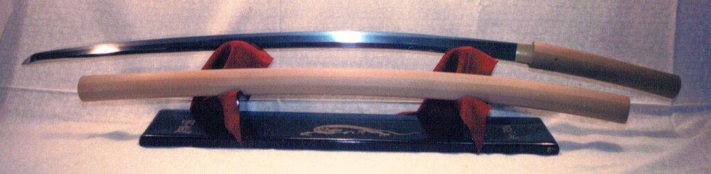

estcrh Posted October 2, 2011 Author Report Posted October 2, 2011 Here is a perfect example of the type of blade I was talking about in the first place, obviously old, unsigned, being called a tachi, can anyone with some knowledge of the subject point out any identifying factors which would show this blade to be a tachi as opposed to a uchigatana or just a daito. Since this is a current ebay auction I am not looking for a discussion on the merits of the blade just information on what would or would not identify this as a tachi, thanks. Japanese Sword Tachi Yamato School Kamakura period 74.3cm http://www.ebay.com/itm/Japanese-Sword- ... 645wt_1032 Quote
sanjuro Posted October 2, 2011 Report Posted October 2, 2011 Eric. Deep sori, lineal taper, ko kissaki, projected length prior to O suriage, all point to this being a tachi. Also if the period is correct then by definition it must be a tachi since there were no uchigatana or katana (or for that matter daito) at that point in history. All blades except koshigatana or tanto, (in other words long swords) prior to the mid Muromachi period were made as tachi since there were no other styles of long blade in existence. Quote
estcrh Posted October 2, 2011 Author Report Posted October 2, 2011 sanjuro said: Eric. Deep sori, lineal taper, ko kissaki, projected length prior to O suriage, all point to this being a tachi. Also if the period is correct then by definition it must be a tachi since there were no uchigatana or katana (or for that matter daito) at that point in history. All blades except koshigatana or tanto, (in other words long swords) prior to the mid Muromachi period were made as tachi since there were no other styles of long blade in existence. Thanks Keith, some good pointers, as for the age, my question was what signs someone with out a huge amount of nihonto knowledge would look for that would point to a blade being a tachi, age would be a good indicator but being able to figure out age would take knowledge of even more characteristics. Quote
sanjuro Posted October 2, 2011 Report Posted October 2, 2011 Got it in one, Eric.... :lol: No-one said this was easy, and picking a blade that was once a tachi after it has been shortened possibly more than once, is not a task for a beginner. With old blades you have to try and imagine it as it was before it was messed with. That takes a little, (Deliberately understated) knowledge. The Gokaden in Robinsons book, whilst not exhaustively accurate, is useful in identifying basic blade type characteristics, as is the gokaden chart in Yumato's book if I remember correctly. Kanzan Sato gives a list of comparison points between Koto and shinto blades which is very easy to relate to. From there, its a matter of personal experience and comparison to known blades. I dont think I need to tell you that it is difficult enough for a beginner to make the differentiation between a koto and a shinto blade, much less the finer differentiation between an old tachi blade that has been shortened to the point of masking its origins, and a tired uchigatana, or an early katana. Quote
