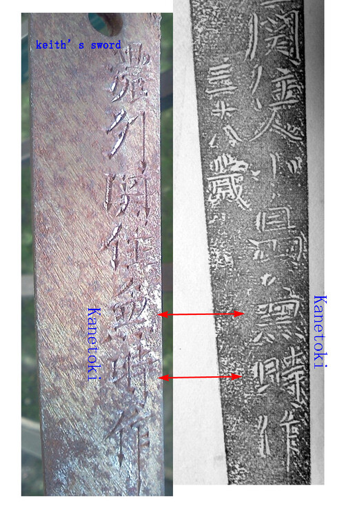

so it would be the maker on page 46 of sloughs book?
i have (an oshigata book of modern Japanese swordsmiths 1868-1945 by john scott slough)
this is the book i am referring to.

any ideal what the writing on the tsuba says?
I can not make out what is on the seppa - to much glare on
the image.
I think that the mark on the seppa is olny the imprint of the inscription on the tsuba.
Yes,Kanetoki on page 46 of sloughs book.
However, sloughs book shows Kanetoki-mei only one example(Tanto oshigata). I think that the signature of this Tanto is not his typical signature(Kanetoki).
Your sword looks like his own signature rather than Daisaku Daimei.

Thank you Chris and Markc.
Keith,
I thought that you were able to read Kanji.
However, my expectation was wrong. The person who cannot read Kanji must not use the term "Daisaku-Daimei". :lol:
isnt the term Daisaku Daimei used to describe a substitute signature or a signature done by the student not the master. so i think if the context is right then it is ok to use the word. :D
thank you all so much fore all of your help this is my first sword and i want to know all i can about it.

daisaku means made by a student for the master and daimei means signed with the master's name with his permission by his student. Thus, a daisaku daimei blade is a work made entirely by a student in his master's place....
No need to apologize Keith.Some of us are hesitant to reply in fear of the same thing!
Did you search this board as suggested by MarkC earlier?I think I read that he had a son that took the Kanetoki art name.I am unsure of the chronology;but this may have been made by the son.
I do not know if or how many students he may have had either.
Also; it is almost impossible to provide a concrete answer with only photos (irregardless of quality).
the pic did not come out well sorry .i put the sword back together so next time it is apart i will get more pics. i did not expect it to be very old around ww2 i would guess myself.
if this was made by his son how does it work? did the son take over the family business and continue to use the name ? or can someone tell me how it works. thank you all very much
