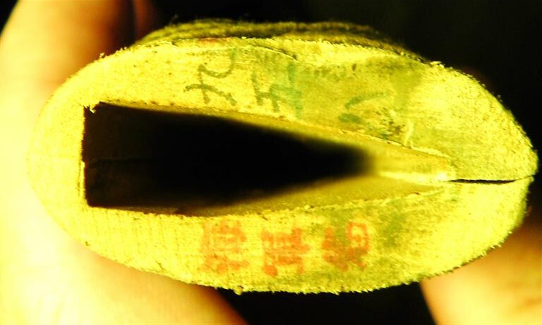

Stu W Posted July 23, 2011 Author Report Posted July 23, 2011 Here is the WWII era Kai-gunto scabbard mouth. I know the kanji on the right side. What are the red kanji on the left? Regards, Stu PS: FYI...these are the only photos I have available at the moment. Quote
Mark Posted July 23, 2011 Report Posted July 23, 2011 the tang says Fukumoto Kamemune, there is a fair amount of info available about him on line. For learning kanji and translating i used the Kanji flashcards that Grey Doffin produced. Quote
Grey Doffin Posted July 23, 2011 Report Posted July 23, 2011 Hi Stu, Fukomoto Kanemune is the signature on the nakago; don't know the Kanji on the tsuka. Mark beat me to the punch. Grey Quote
Nobody Posted July 23, 2011 Report Posted July 23, 2011 The red kanji on the tsuka are 海軍省 (Kaigun-sho - the Naval Department). Quote
