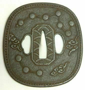

Toryu2020 Posted July 15, 2011 Report Posted July 15, 2011 http://www.samuraishokai.jp/equipment/ts036.html Not trying to start a fight here, Take a look, this is not the same tsuba but could easily be the same mold. If the Hozon Kai can appreciate these in spite of being cast, why can't we? -t Quote

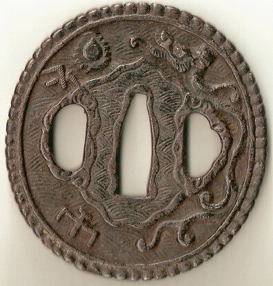

Thierry BERNARD Posted July 15, 2011 Report Posted July 15, 2011 another sample : one of my namban tsuba and the same in one book, even seppa dai carving is the same!! Quote
Ford Hallam Posted July 15, 2011 Author Report Posted July 15, 2011 Hi Thomas Take a look, this is not the same tsuba but could easily be the same mold. They are clearly from the same workshop but when you compare them carefully, side by side, you'll not find any correlations in the surface design and the actual outline of the guards are very different. The measurements given are different also so I can't see any evidence that suggests they came from a mould at all and even less that they came form the same mould. If the Hozon Kai can appreciate these in spite of being cast, why can't we? Why do you think the NBTHK regard these as being cast? Actually, this does raise an interesting thought. Can anyone point to any steel tsuba that does show clear signs of having been cast and that has papers from the NBTHK or any other organisation in Japan. Quote
Toryu2020 Posted July 15, 2011 Report Posted July 15, 2011 Ford - What of the "bubbly" surface of the two examples from Tsuruginoya? What about the missing pieces from the rim of the first example? Does the rounded feeling of the seppdai and other features not suggest casting? I thought these were the tell-tale signs? Thierry - Would you be willing to share photos of the rim of your very nice example? -t Quote
Thierry BERNARD Posted July 15, 2011 Report Posted July 15, 2011 Thierry - Would you be willing to share photos of the rim of your very nice example? -t sure! as soon as i will be at home!! Quote

Curran Posted July 16, 2011 Report Posted July 16, 2011 Thierry- the two tsubas are relatively identical, but have some distinct differences in certain details. Different designs at the end of the radial spokes, etc. Tom- that is a rather popular Namban design that I've seen in different sizes and shapes. I don't think it cast, though iron isn't very nice. I've held Namban I thought cast but weren't (ahem.... no comment, live n learn.) I have seen NAMBAN that I more certain are cast, but they have all been either distinctly dock work grade, or those heavily of Indo-China influences and possibly materials. I believed Dr. L has mentioned the importation of tsuba into Japan, if we were to review his book. Personally, I would expect some pre 1800 cast iron tsuba to pop up. In experience, I just haven't seen any outside of the Namban group that were pre 1800s. I can't say they don't exist. I can say that there is an almost entire 'lack' of those with age on them outside of the Nambans. Quote
