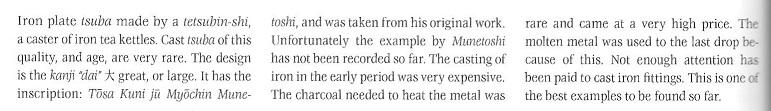

Ford Hallam Posted July 7, 2011 Author Report Posted July 7, 2011 Hi David, thanks very much for that. I have to say I'm disappointed that Mr Hayes seems to omit providing any evidence for his claim though. He simply asserts that it's a cast tsuba made by a tea kettle caster. This is a copy of an original Myochin work with the mei being also reproduced . I'd be fascinated to learn what technique this "unknown" kettle caster used to create an accurate wax model of the original Myochin tsuba. I doubt he had access to vulcanised rubber mould and a wax injector. To me it seems that if we apply Occam's handy razor we're left with a far more plausible explanation. This is simply a modern cast steel fake. Mr Hayes also tells us the charcoal used to heat the metal, presumably he means to melt it, was rare and very expensive. I don't think anyone can claim it was rare at all. Practically every sword and tsuba forged was done so in a charcoal forge and every tatara was fuelled by charcoal. While it may have been expensive it certainly didn't make it in any way particularly rare nor was it's use limited. In a country covered with mountainous forests charcoal as a fuel was big business. Sadly, it is exactly this sort of vague rationalisation that continues to muddy the water. Having said that I think Mr Hayes book looks to be a very valuable reference work in terms of good examples, the present piece accepted. Quote

christianmalterre Posted July 7, 2011 Report Posted July 7, 2011 Dear Ford here you may find the "seeking" answer... (i but,already did mention this above) there´s more info available,too-yet,but not published officially till yet! Mr.Haynes is 100% Right in this Thesis and Statement-that´s all i can say actually. Christian Quote
